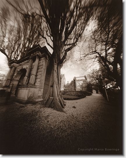

An example where I probably over compensated:

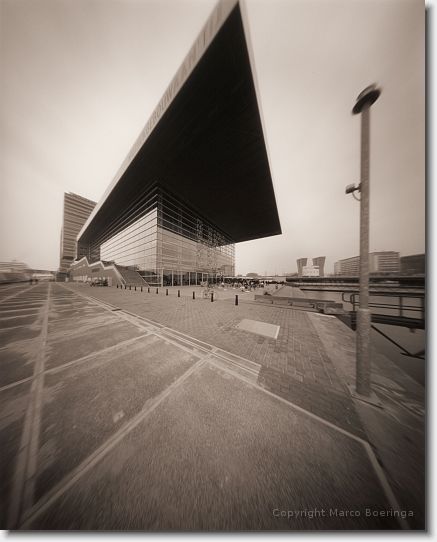

And a more moderate compensation for light fall off:

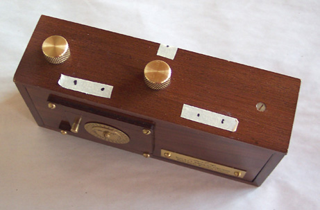

Hello Noor,
Here is how I aim my Zero 6x9 multi-format. The front dot is over the pinhole. The rear dots are over the 6x6 and 6x9 formats. The masking tape will come off the camera with no damage. Something similar could be done to a Zero 2000.
