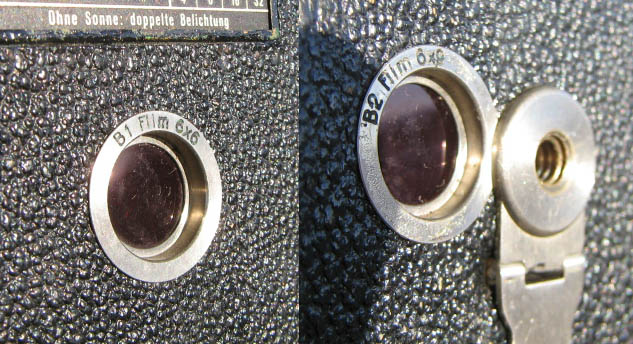

Yes, if 620 and 120 had a child it would be a 117. Flanges from the 620 and spool from the 120. It must have been the 6x6 Icarette that took 117-film, because it had the markings for 6x6, which 120 didn't at the time.
In Germany 117-film was called B1 6x6, while 120 was called B2 6x9.

I looked in the ICA catalog from 1922 and it indeed says for the Icarette I "Für Rollfilme 6x6 cm" and for the Icarette II it says "Für Rollfilme 6x9 cm"
You mean the second generation Rolleiflex, the Standard. The original Rolleiflex was made for 117-film only and used a red window on the back, but some had theirs converted to fit 120 spools and had third party counters installed. The early Rolleiflex Standard cameras could take both 117 and 120 and had two red windows, but only for lining up the first frame before engaging the mechanical counter.
