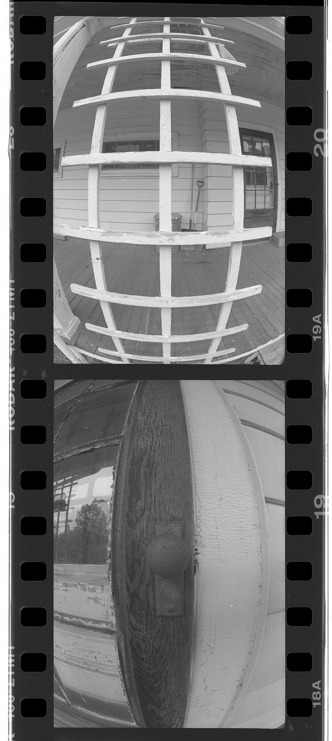

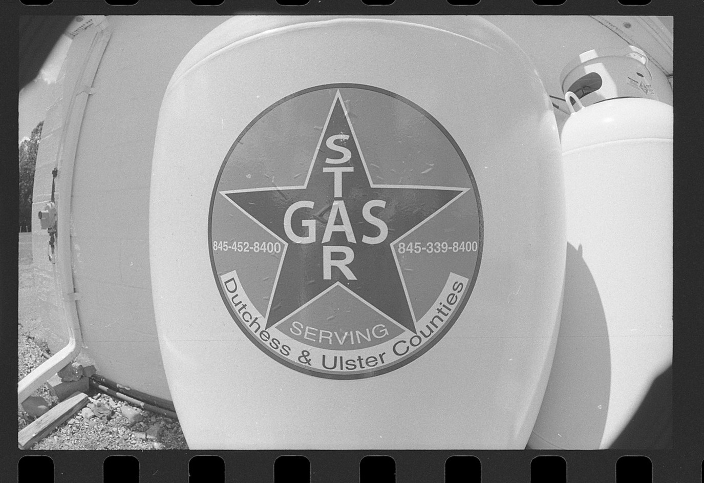

The attached photos are from my first test with the Zenitar MC 16mm Fisheye lens on my Minolta SRT-201 (M42 screw mount using a Minolta adapter and a yellow filter).
First shot at f/16 and at 0.6 meters focusing.
Second shot at f/16 and at 1.2 meters focusing.
Would anyone know why the lens is giving these serious vignettes in the 2 corners? These vignettes appear in each shot on 2 rolls of film no matter the aperture or focus.
Thanks in advance.

You don't notice anything odd, like the lens is on crooked? The focus mark should line up with the top of the pentaprism.
Ricardo Miranda
Mar 31, 2012
2,408
London, UK
I think you got your answer.
It is a Fisheye, any misalignment will be shown.
Why don't you use a nice M42 body with it and see if you still have the same problem?

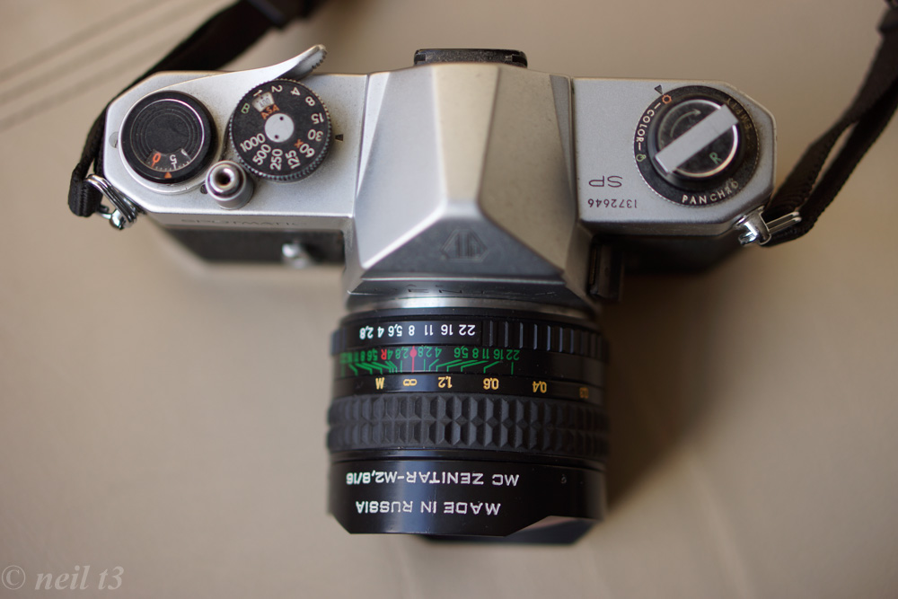

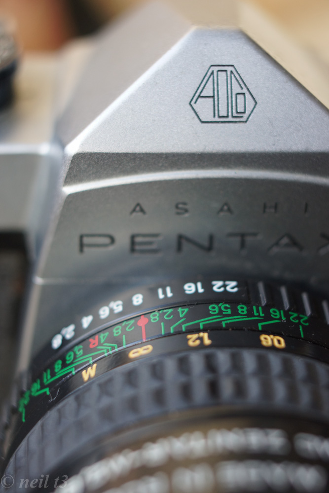

My Zenitar 16mm fisheye mounted on a Zenit TTL left the aperture and focus alignment line within about 3 degrees of being at the top .
Same lens mounted on a Pentax Spotmatic left it about 10 degrees out .
Looking from above you can see how far out the hood is from centre .
Your picture's clearly show the ribs of the hood in the picture , with this lens the hood is not in the frame .
This lens was used quite a bit via an adapter on Canon EOS and Minolta/Sony A mount cameras , in both cases the lens aligned in the adapters good enough that it was almost perfectly centred .

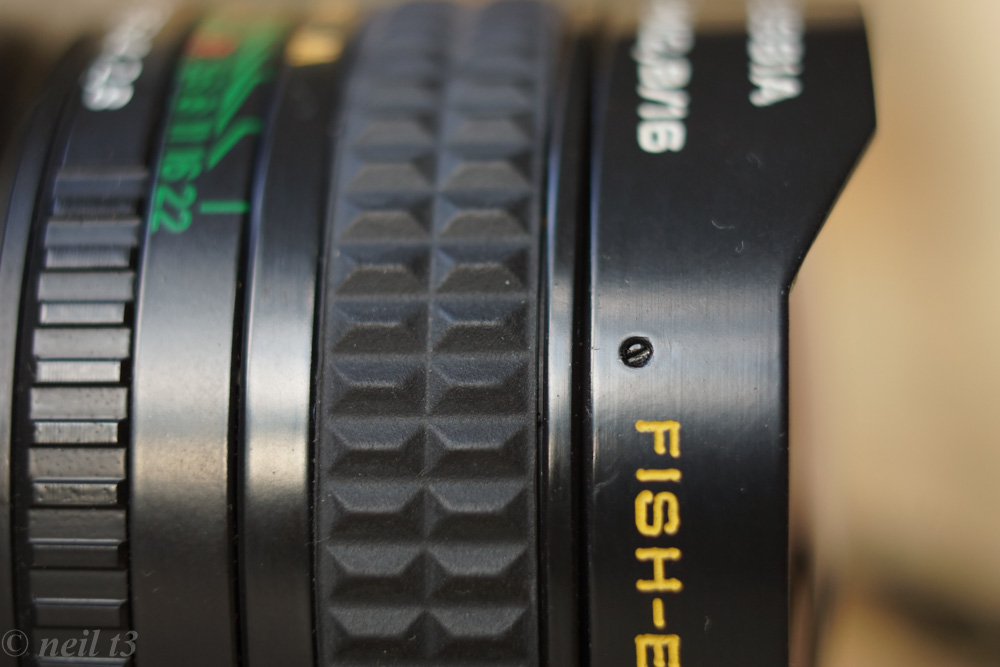

If the hood still needs a bit of adjusting to get it square on , it's easy to adjust .
Four little screws . Slacken off a touch , twist hood and tighten . Job done . Enjoy .

In the case of my lens on a couple of my bodies , with the Zenitar on the Pentax it's clearly at the very end of it's limit . Any further rotation out and the aperture pin will miss the aperture lever on the body and the lens won't stop down correctly/at all .
Something to note is that several of my FSU lenses mounted on the Zenit are all consistently about 3 degrees from being at top dead centre with the mark on the lens barrel . They are all about 10 degrees out on the Pentax .
With Japanese lenses on the Zenit being the opposite .
It seems like the official start point for the thread on FSU cameras and lenses are about 5 degrees further anti-clockwise ( viewed from the front) than the Pentax .
As all the different lenses I have seem to be consistent , this seems correct and all lenses work as expected regardless of which body they are mounted on .

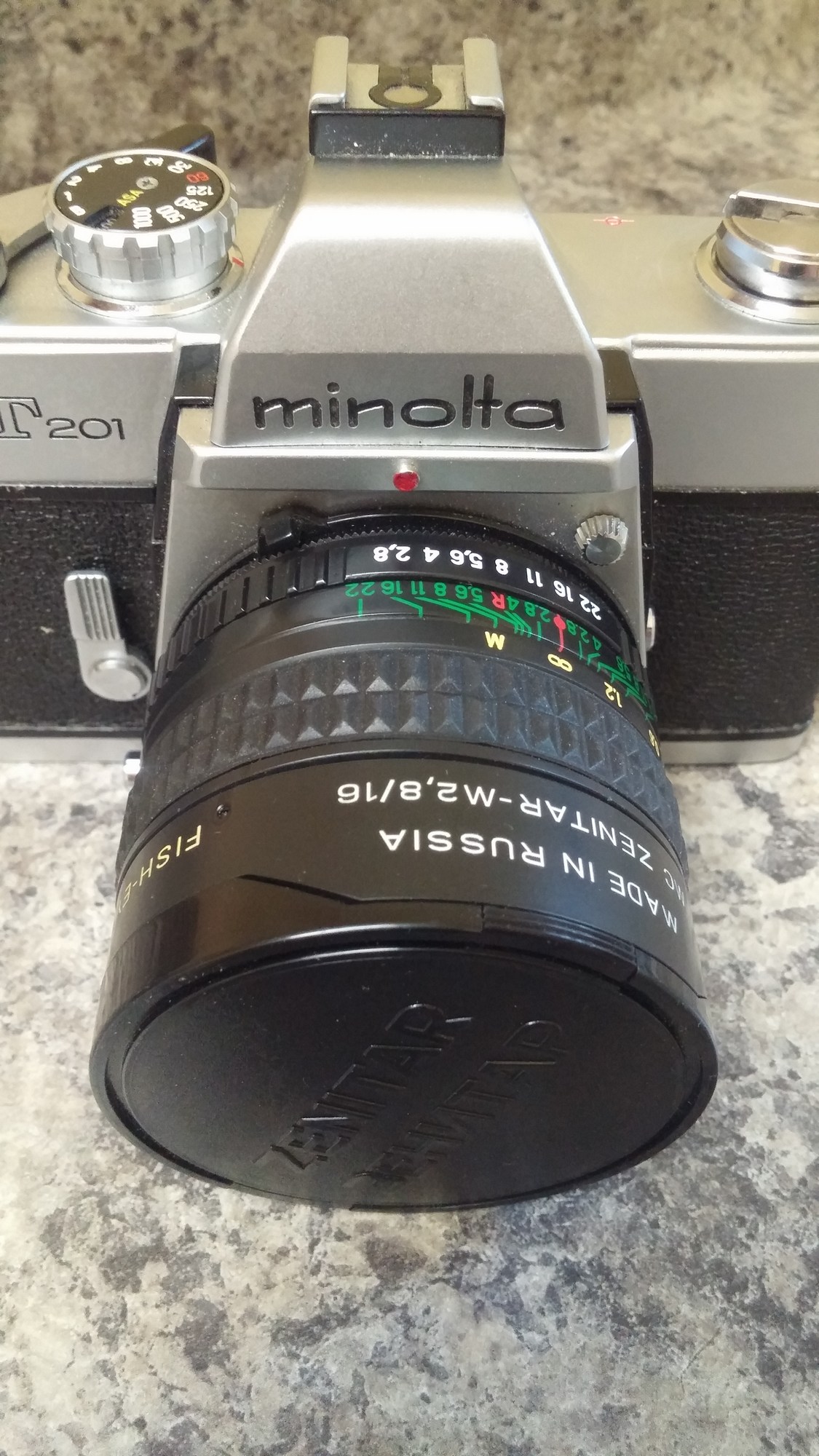

This shot shows how the Zenitar fit onto the Minolta SRT-201. Again, I believe the adapter is correctly placed and that it can only go on one way. When I mounted the adapter to the camera, it gave it's usual "click" sound, and locked in, identical as when mounting a Minolta lens. After that, I screwed in the lens and it's stopping point was as you see in the attached photo.
Shots by the Zenitar on a Mamiya MSX 1000 to follow shortly.

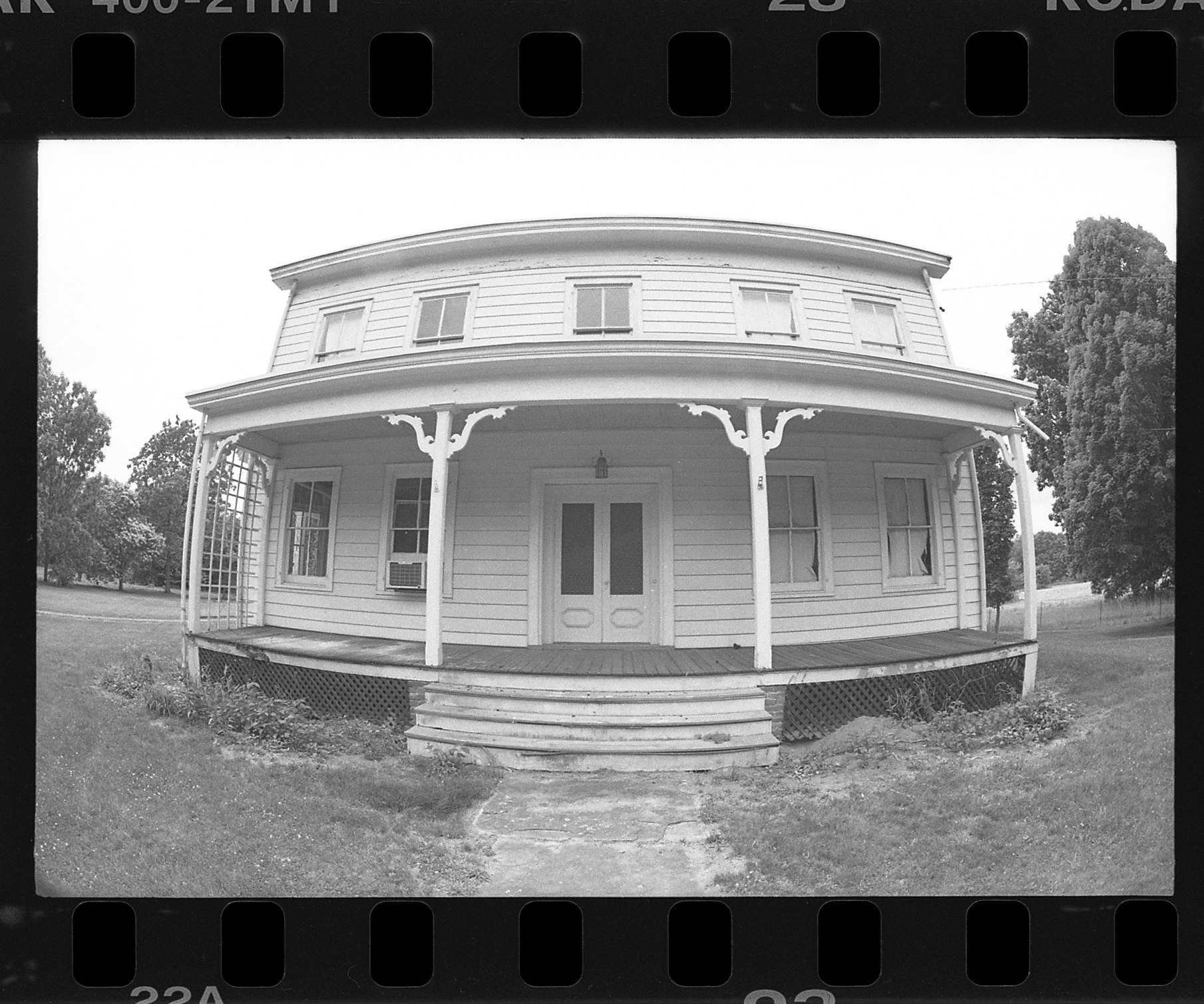

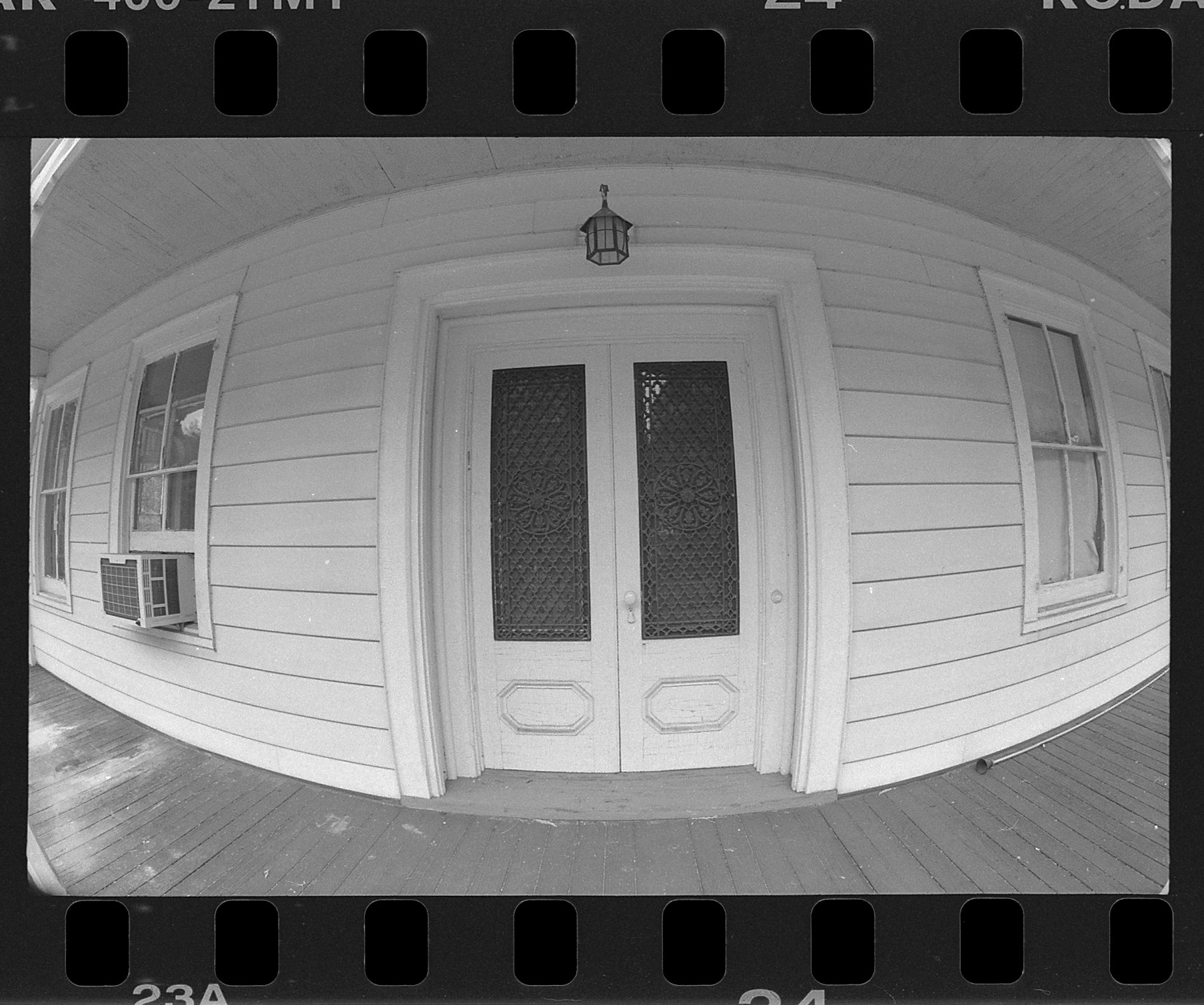

Results from test today. Better, but a tweak is needed.
Zenitar 16mm Fisheye with rear-mounted yellow filter on a Mamiya MSX 1000. No adapter needed.
To my eye, the aperture scale landed at dead-top-center once fully screwed in. However, there is still a very small vignette in one of the corners on all shots. I think taking Neil's suggestion and loosening the screws to slightly turn the lens hood is the answer here. At that point, I'd probably dedicate the Zenitar to the Mamiya and call it a day instead of re-turning the hood for use on different cameras. Good to know that it can be done though if needed.
It would still be nice to know why the Zenitar overshoots things on the Minolta SRT-201! If the threads are wrong, I'm probably out of luck as the Minolta adapter was an ebay buy.
