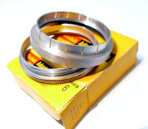

It takes a slip on filter (the filter has fingers that slip over the id of the lens). Best best is to find a series VI slip on filter holder, then you can use various series 6 filters.
Slip on filter adapter; series filter adapter.
Measure the outside diameter (OD) of the lens front element and buy accordingly. Get a lens hood too.

If you find a series VI slip on filter holder that’s close, but a little loose, some self adhesive felt or gaffers tape can be used to snug it up a bit.

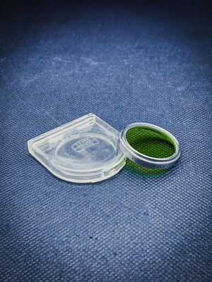

Not sure for this particular model, but a number of Zeiss cameras have an "invisible thread" hidden in what seems to be just a knurled rim. If your camera has a diamond-pattern ring around the lens, try to follow one groove (with a fingernail) for one full turn and see if you end up at the same spot or one groove apart. In the second case, you have an invisible male thread; it takes filters with a female thread of the appropriate diameter. Example:

See if you can find a Kodak Series filter adapter/holder that fits your lens OD, it makes it easy to swap out the series filters, put a hood on, etc.

These types of filter holders were quite common, some included a lens hood. A British company Polysales used to sell them, Polysales were essentially a UK mail order catalogue company selling accessories which they imported or sourced in the UK. The long retired owner has popped up on Forums recently.
I have a Bay 1 Polysales filter holder and 3 or 4 filters, the neat part is the lens hood is the part that screws in to hold the filters in place, it does rotate in the locking ring to position correctly. Spiratone would be the much larger equivalent of Polysales in the US, with a far greater range of products.

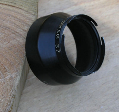

Shade hood Zeiss Ikon 37mm push-on fits perfectly on the Super Ikonta 531/2 post-war.
I have another shade hood 37mm push-on from another brand and it doesn’t due the thickness of the rail.
