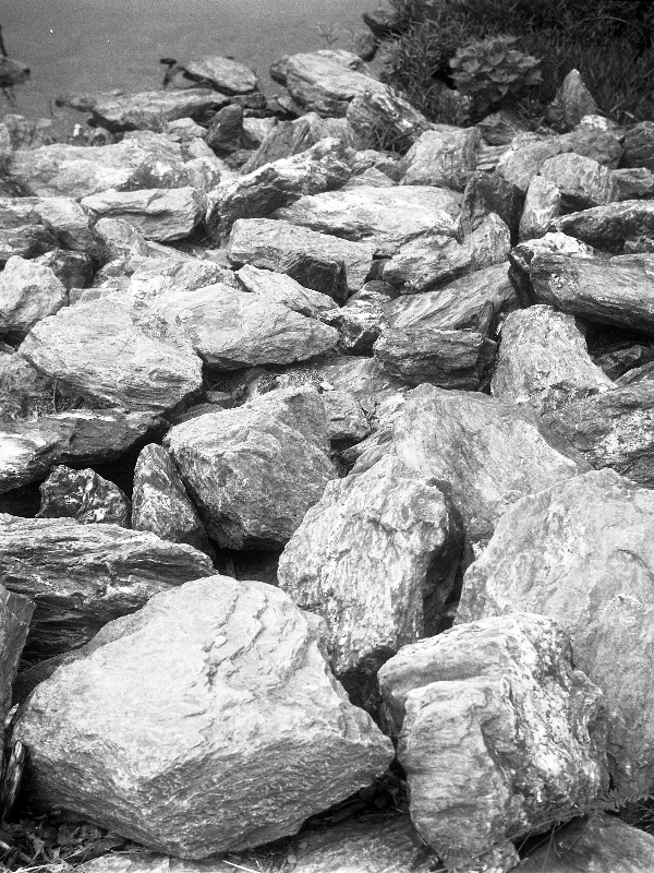

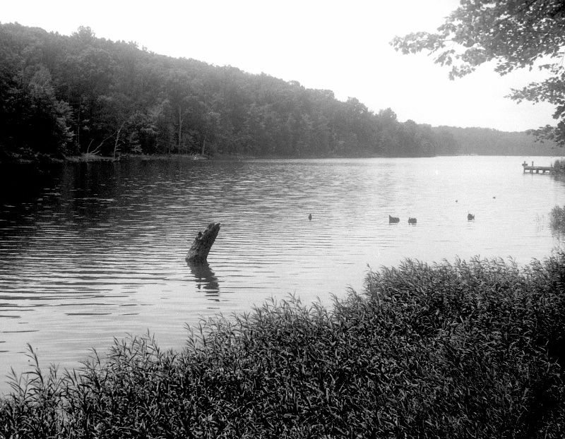

Thanks to everyone for the informative replies, including the ground glass instructions! The Nettar is definitely a single point thread, it was easy to get it started.
Well, I think I was successful, or at least it seems about right. I ventured to a local lake this morning and took these on TMY:
The close to mid ranges look good, but I can't help but think infinity is still slightly off; or maybe it's just my imagination with some lens flare and slight fungus evidence present! :wink:
Cheers, Allan
