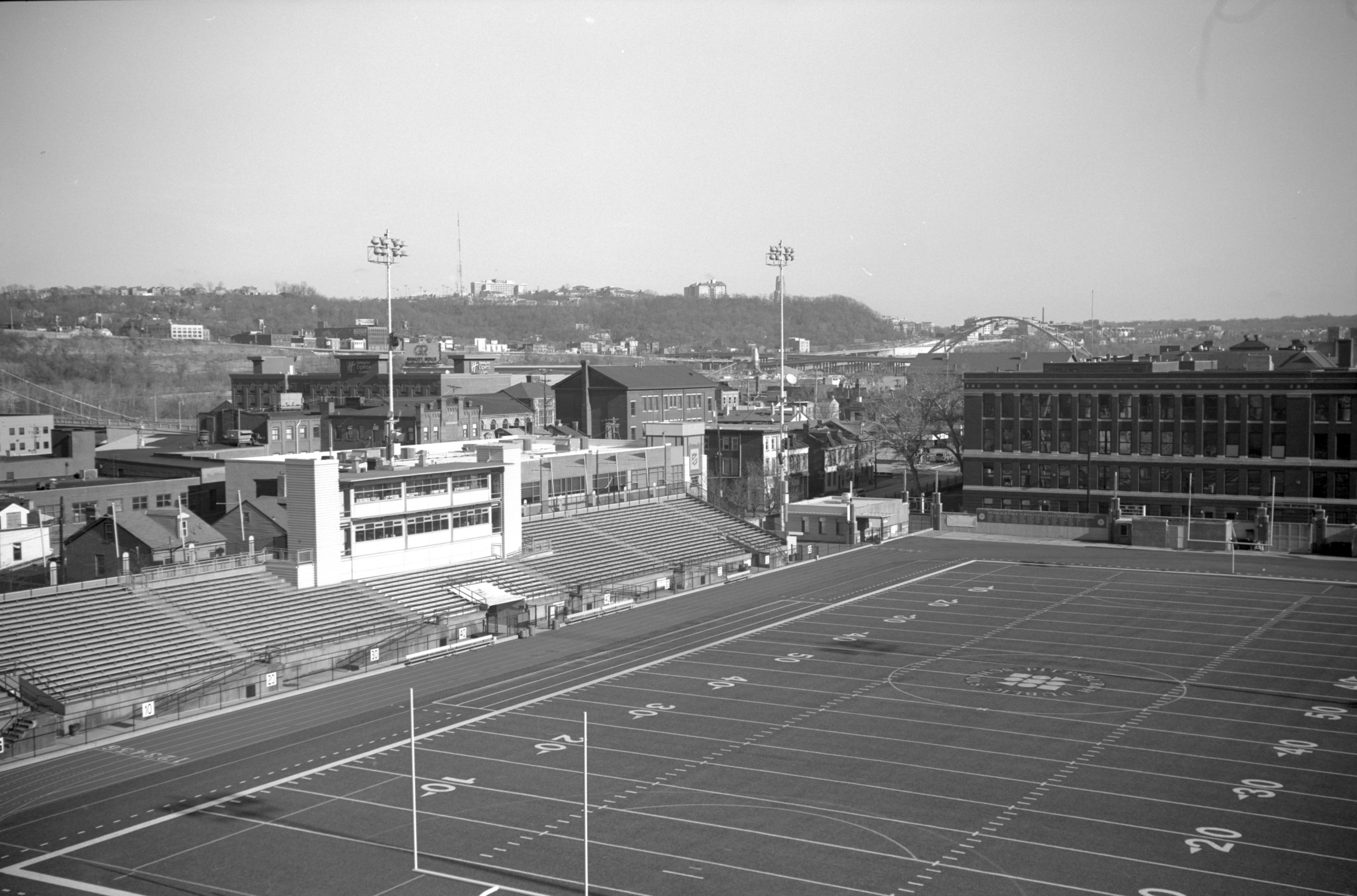

This was taken Dec. 26, 2014 at about noon. It was Plus X 125 film that was outdated about a year but refrigerated. f 16 at 1/125 hand held. It goes soft towards the edges. And there are darkened corners. The camera was the Nettar with an f 6.3 anstigmat lens. It was developed in D 76 1:1 at 68 degrees F for 9 minuets agitation was every 30 sec for 5 sec.

Very nice shot!

Is that on the South Side?

By the way, your photo was taken at 1/100, as the 1/125 is a "modern" speed. Leaf shutters during that time should have been marked 1 sec., 1/5, 1/10, 1/25, 1/50, 1/100, 1/250, 1/500. Some of the simpler shutters lacked the slow speeds, and some shutters topped out at 1/200, 1/250, 1/300, 1/400 and 1/500.

elekm, that is really nice and how I want to have lights and darks look. Yes, my shot is of the South Side around noon from the MacArdle Roadway newly reopened. I agitated the Kodak way, 5 sec every 30. Uh, my camera has the 125 as the highest setting. The shutter is a Telma, 125, 100, 50, 25, B, T
Oh, so you do have a 125 speed. That's interesting. I wonder why the shutter maker would bother to add a 125 with a 100.
