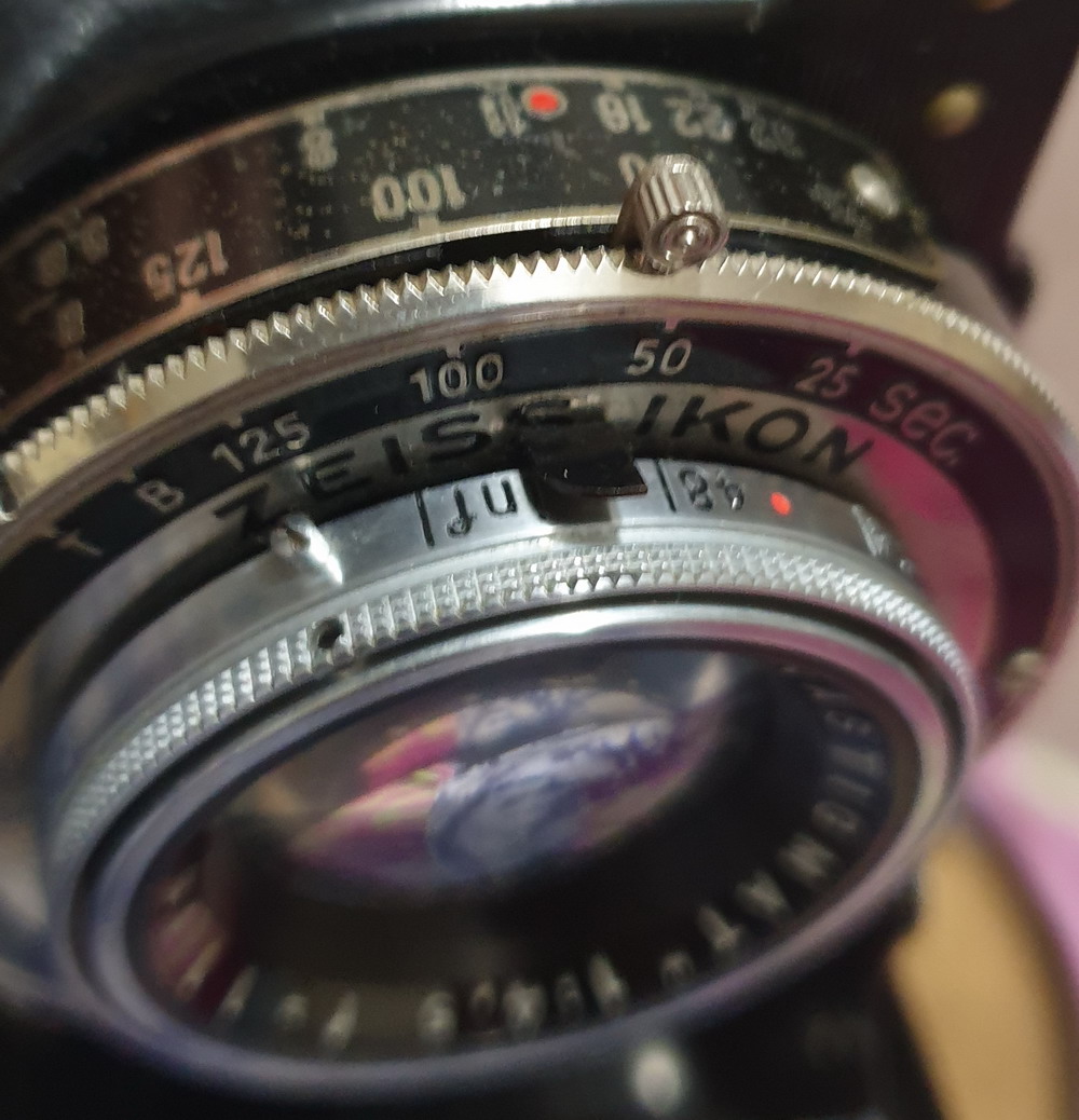

I bought this beauty of a 6x9 Zeiss-Ikon Nettar with the f4.5 lens and telma shutter. However when I tried turning the focus, instead of stopping when the "peg" hit the focus indicator, it just went round and round until the front lens elements just unscrewed all the way off.
So...in order for it to focus correctly, how should I screw it on? Is there a specific starting point? I've screwed it back in place successfully but placing tracing paper in the film plane and opening the shutter suggest the focus is not accurate.

Well, you have found the wrong starting point. Unscrew it at try the next starting point. There maybe 3 or 4, keep going until it works.

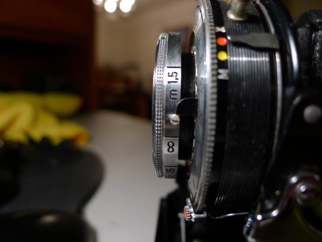

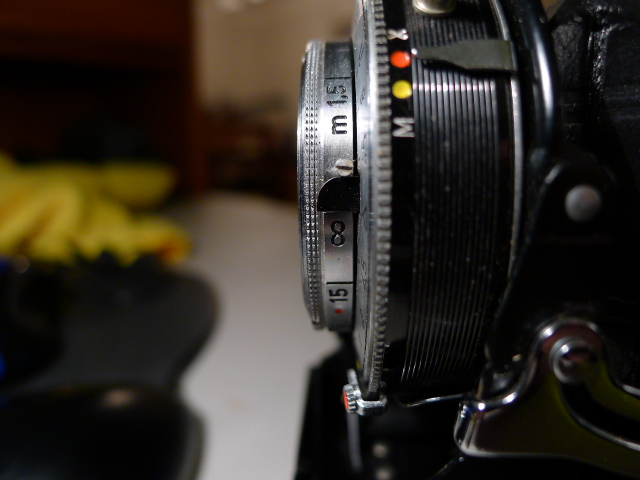

At the proper point the front ring should look like this at infinity and close focus:
