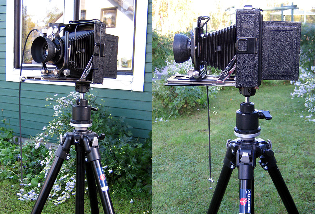

Prontor was a brand of shutters by Alfred Gauthier, Calmbach, ACG. Their earlier cable releases were marked with the AGC logo, and then later marked Prontor. I'm not sure when the switch happened, maybe when the company name was changed to Prontor Werke.
I use old Prontor cable releases with my old Compur shutters, and I also bought a new 50 cm cable release in the same style with cloth covering and a locking screw from Gebr. Schreck in Germany. They mostly make modern cable releases of plastic and metal, but they do make the classic cloth ones on request. I thought the modern ones didn't look right for use with older 1920's cameras. The Schreck brothers started the company in 1922 which made it feel even more right. :smile:
http://www.gebr-schreck.com/
Well what can you do with half meter shutter?
For selfie? Xa! xa! xa!
A longer cable release is easier to use with a little slack to minimize vibrations. But I haven't had any problems with the shorter ones.
