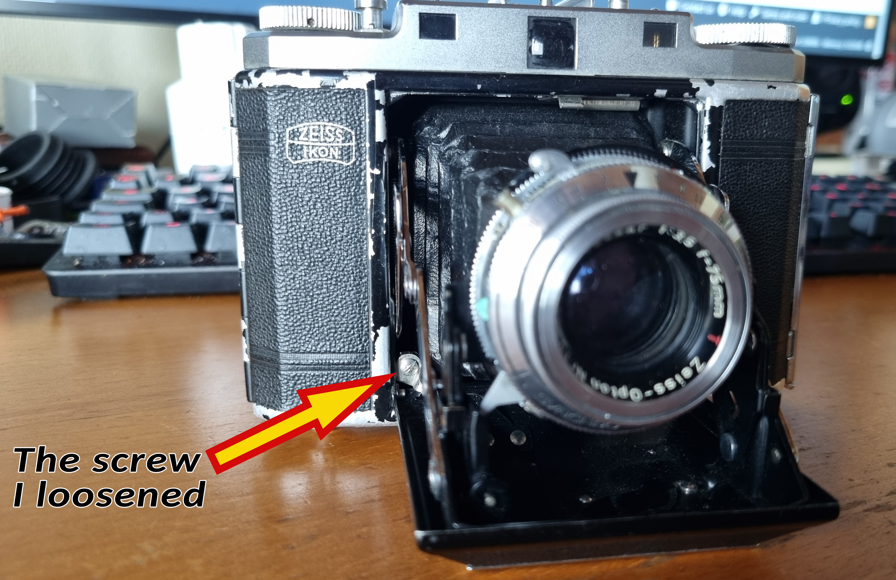

I started reading this thread about the unresponsive trigger of a Zeiss Mess Ikonta (or just plain Ikonta M). I read it all, but didn't find anything that would help in my particular case. It just kept on not firing.
How ever, I found a screw that was part of the link between the trigger on top of the camera, going to the shutter assembly at the end of the extended bellows. It's in the lower left corner, if the opened camera is viewed from the front.

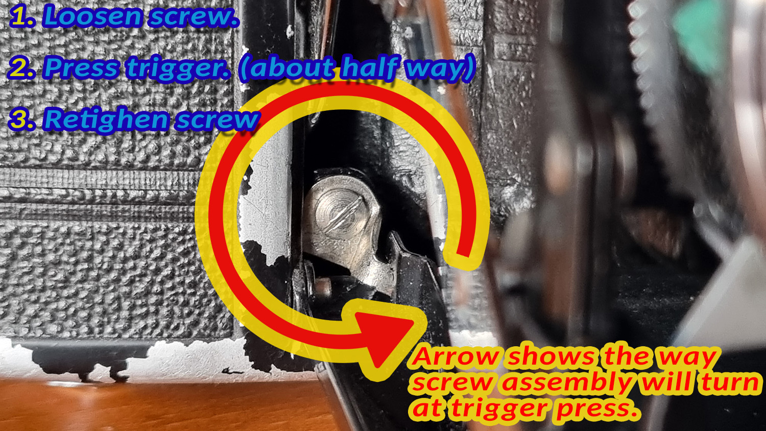

I loosened it a bit. Didn't take if off. Then I pressed the trigger and re tightened it again. After that the camera would fire everytime the trigger was pressed.
I suppose there are different models of the Ikonta M with different trigger linkage systems in them. This just happened to work for me.
I hope somebody will find this useful.
How ever, I found a screw that was part of the link between the trigger on top of the camera, going to the shutter assembly at the end of the extended bellows. It's in the lower left corner, if the opened camera is viewed from the front. View attachment 343297 I loosened it a bit. Didn't take if off. Then I pressed the trigger and re tightened it again. After that the camera would fire everytime the trigger was pressed.
WELL. . .
I tried this my self of course... But the next day, when I was going to use the camera to shoot some older cars. Then the trigger button did not work at all. All photos were taken by triggering the shutter by pressing on the last part of the linkage it self. This, as I'm sure you could all imagine, resulted in two frames with multiple exposures. So, I'm sorry to say, this way that I suggested, turned out to be quite worthless.
If anybody have an idea or link to somewhere with more ideas of how to solve this problem, I would be most grateful.
