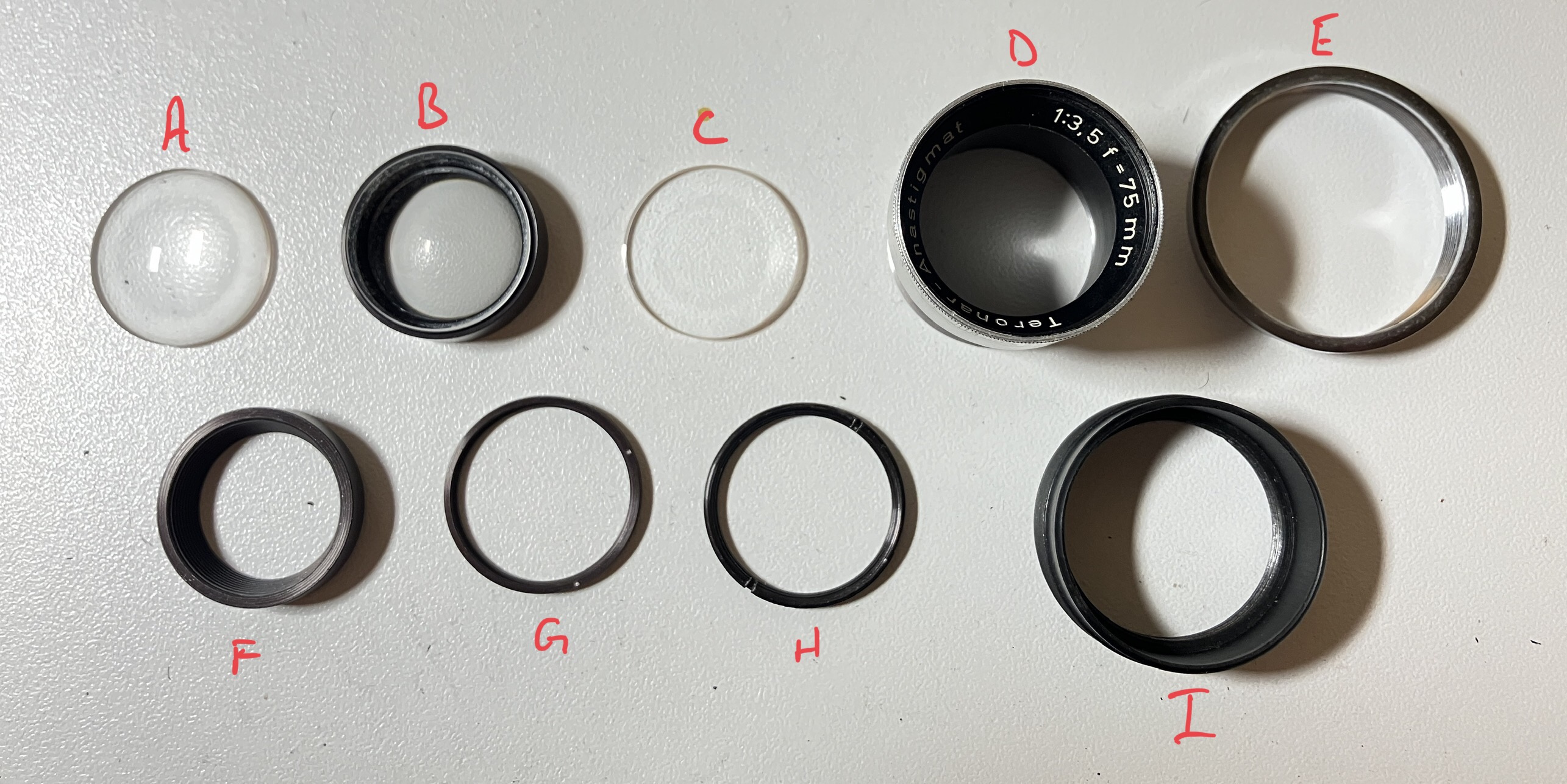

Now here we are 8 years later, and I want to get it back up and running. I have disassembled the viewing lens completely. Below is a photo and description of what I *think* each piece is. Looking at diagrams online, this lens appears to be a cooke triplet design. Front and rear elements that are both convex on one side and flat on the other. A middle element that is concave on both surfaces.
Anyone think they could help me get things back in place properly? It looks like once it's back together into the housing, it's a fairly simple matter of screwing it back into the camera body right up until it matches infinity focus with the scale, and then locking in place with the retaining ring.
A: Front element (convex and flat sides)
B: Middle element inside a housing ring (two concave sides, one slightly more so than the other)
C: Rear element (convex and flat sides, just slightly smaller in both diameter and concavity than front element)
D: Lens barrel
E: Trim ring or possibly retaining ring to help keep distances correct as lens assembly screws into camera body
F: Spacer; definitely fits just right on one side of the middle element housing B
G: Appears to be a ring to hold the rear element C and make up the diameter difference to keep it centered in the housing; that element fits perfectly in a small shelf here. No threads on it.
H: Rear retaining ring that keeps the entire assembly in place inside the barrel. The outer threads fit the inside of the lens barrel. There are notches cut for a spanner. Oddly it has inner threads too; not sure what those would be for.
I: Screws over the lens barrel D and interfaces with E; can be locked to the barrel with a set screw at any point. I think E and I work together to help lock the lens assembly at the correct distance from the body when installed.
Very open to suggestions on how to get this put back together.
Update after an evening of listening to my college football team lose and messing with various configurations. Feel free to ignore if you already know the right answer. So far I've tried:
1. Not messing with E or I yet as they don't seem to control lens distance from reflex mirror in the camera body; I'm guessing they just lock it down when the correct distance is obtained by screwing D into the camera body. Inside the lens barrel D, from front to back (everything inserted from rear): Front element A, convex side facing forward. Then spacer F. Then middle element B, with slightly less concave of the two sides facing forward. Then rear element C inside ring G, with convex side of C facing rearward. Finally H to lock everything in place. Result: Can't get anywhere near infinity focus even screwed all the way in - but I definitely have extremely close focus (closer than should be possible with this camera). This suggests to me that the front cell is too far forward.
2. All orientations the same as attempt #1, but spacer F is moved to sit between the middle and rear elements instead of the front and middle. Now the front and middle elements are touching. Result: Much closer to correct, it seems. Can't quite get infinity, but error goes the opposite direction now. I have no close focus, and I reach infinity when the assembly is held about 2mm forward from where it can touch the threads of the camera body.
3. Everything the same as #2, except I flipped middle element B around, so the more concave of the two surfaces faces forward now. Result: I can now reach infinity focus while the lens is screwed into the camera body, but I have a very strong blooming/haze effect and nothing is particularly sharp even when in focus. I confirmed this isn't due to smudges on the glass anywhere, it's all clean.
I'm calling it for the night. Still open to suggestions for what to try!

Maybe I mistook the picture. Is "A" the front and "B" the rear doublet? With "C" the middle biconcave lens?
A is the front element (flat on one side and convex on the other). B is the middle element (biconcave with one side noticeably more curved than the other). C is the rear element (I believe flat and convex). Each element is a single piece of glass, I have no doublets here like I assume are in the taking lens (which is definitely a Tessar).

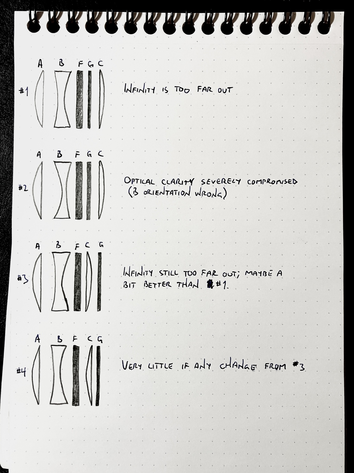

I've drawn up some diagrams of assemblies I've tried; I'll post them when I get a minute so it's easier to visualize what's going on.
From what I can tell, it should be a fairly simple matter of getting the orientation and spacing of each of the 3 glass elements correct inside the silver tube. It appears to be set up such that the elements and spacers all just butt up against each other to hold rigid and correct spacing and alignment along the tube axis, and then everything gets locked in with the rear retaining ring that goes into the barrel from the back at the very end. Once the optical assembly is put together in the tube, the tube itself screws directly into the lens board on the camera body. It's a pretty long thread, seems designed to allow the entire viewing lens assembly to thread way in until infinity focus is reached properly. Pieces E and I seem to just be there to allow for a nice trim ring and a finished-looking front when everything is said and done. The camera would function just fine without them, from what I can tell.
The common thread with everything I've tried is that when I go to screw the finished assembly back into the lens board (which is set at infinity focus), I get objects at infinity in focus on the focusing screen when the lens threads haven't yet engaged. Sometimes it's close, but even the times I feel like I've managed to get proper infinity focus while the unit is screwed into the board, it's very nearly at the end of the threads and protruding quite a bit. When I first disassembled this lens, it was definitely screwed in far further back towards the film plane (something like ~1cm or even more).

Here are the 4 orientations that have been the least disastrously wrong :wink:
Left side is the front element facing towards the scene, right side is the rear of the assembly facing toward the film plane. Hopefully this clarifies.

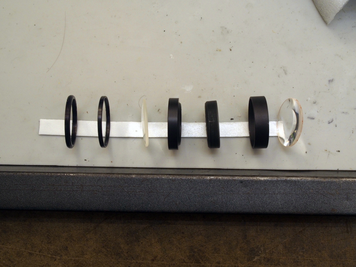

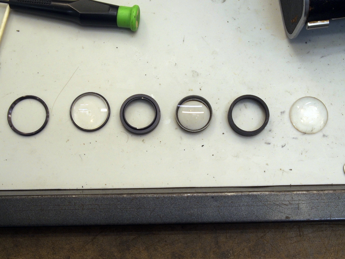

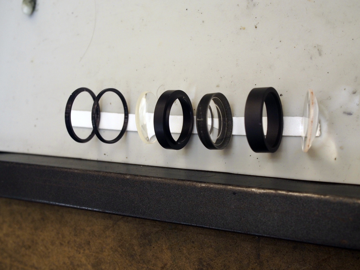

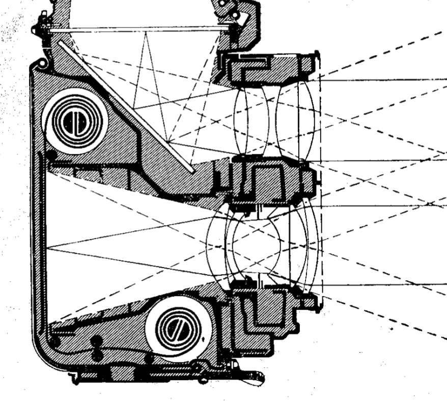

I have an Ikoflex but messing with the lens would require it to be reset, so….

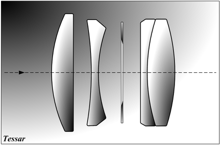

The Teronar is just a triplet, so here is a diagram of a Triotar. Should be the same-ish.
Usually you can tell where an element “seats”. Are A and C the same diameter? Maybe you have them flipped.

Okay I got it! Thank you so much for disassembling yours to show me. I had the very first spacer ring behind the front element flipped the wrong way, so the biconcave middle element was too close to the front. As soon as I got it set up as you showed in your photo, and got my fresnel/ground glass situation rectified, it screwed right in and was easy to find infinity focus, right where I expected it to be. Everything is locked in now and should be dead-on. I'll put test roll through it to make sure I'm not seeing de-synchronization between the viewing and taking lenses.

I always have this picture when I clean the viewing lens, you can feel the most concave part with the fingers when cleaning it. The position of spacers is essential as well.
