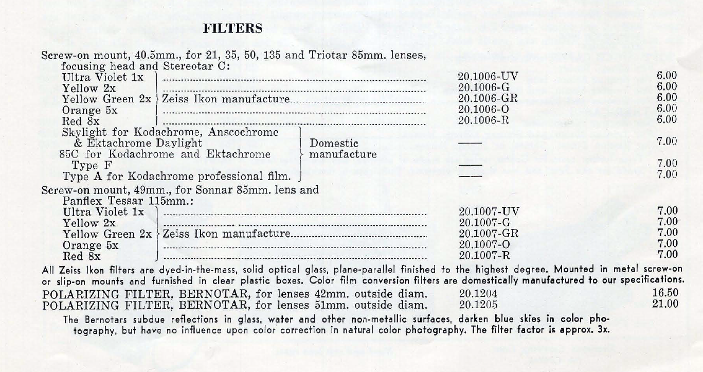

Does anyone know of a table with cross-references (to modern filter designations, maybe Kodak Wratten) and filter factors for Zeiss filters? I am thinking specifically about filters for the Contax rangefinders (40.5mm or 42mm push-on), but a generic reference including these is fine (and quite helpful). Some examples are R10 (light red), GR3, G2,3,4 (yellows: light through orange), as well as the Zeiss Jena designations such as gelbglass L42 (light yellow). This could also include the Zeiss Ikon filters (such as the B50 bayonet mount filters). I am thinking more about B&W filters, but open to more. I know I am asking a lot, but I am struggling to find this information on the web. For instance here is some useful information (i.e., some good cross-reference, but no filter factors):

According to my opening link ( http://www.earlyphotography.co.uk/site/entry_M17-1.html ), R10 = A, 25 Wratten which sounds like the typical 25A (filter factor = 8). I think G2 is a medium yellow (2x) or K2,8 Wratten; and GR3 maybe light green (not sure what filter factor is, don't use green much). GR3 is not in the linked table. I have Zeiss GR5, and by the light meter test it is 2x, so sounds like medium yellow-green (table says GR5 is yellow/green). I do not have a GR3.

Found this in material I already downloaded. Unfortunately I do not think the designations relate to markings ion the filters.
