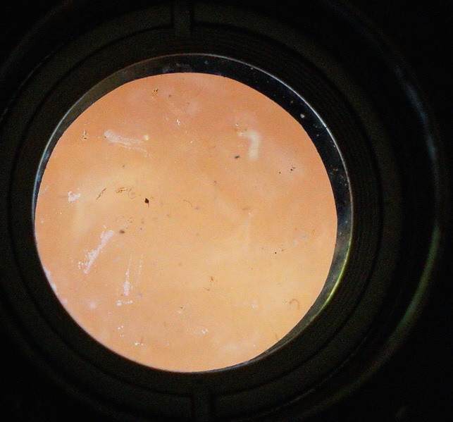

What are people's experience with old lenses like the Zeiss 75mm 3.8 with white marks such as these?
These marks look worse at certain angles and seem to be inside the lens. They also appear to stand in relation to the aperture blades.
The lens is on an Original Rolleiflex K1 614 that arrived from the Czech Republic. It appears to work well, at least at faster shutter speeds and is said to have received a CLA.
I am about to leave for a trip to Prague and would love to bring it along.
I do not require absolute clarity, but would love to be able to use the camera with slide film to obtain decent enough images for projection.
Any thoughts?

That front element should just unscrew w/ your fingers. I'd suggest doing that, and cleaning the front element w/ something (lens cleaner and lens tissue,microfiber cloth, alcohol, etc) and using a Q-tip to get into the rear element and clean it up, as well as on the other side. It might just wipe off.
If it's between cemented elements, there is nothing you can do besides just put a good hood on it and maybe a yellow filter to boost the contrast w/ B&W film. Sending it out to be cleaned would cost much more than the camera, and not every place can un cement optics and re cement them.
The main issue is probably going to be flare, especially w/o a good hood. There is no helical, so you don't have to worry about where the threads start when you screw it back in. Anywhere it starts is fine.
I would unscrew the front and rear cells from the shutter and inspect/clean them. If the flaws are on the inside it will be in the front or the balsam in the rear cell. To unscrew the rear cell open the camera back and reach inside with the focus fully retracted.

Thank you so much!
It came off! Now I feel much better about using it.

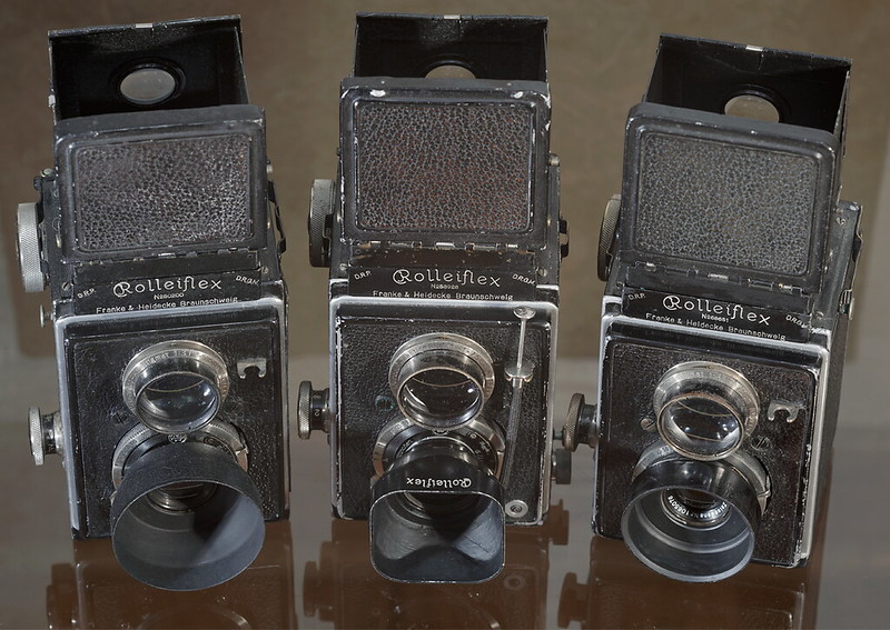

Hi,
yep, 24 mm push on. The hood Rollei/F&H sold that days is very hard to find. There are some made by Lifa or Actina in 24 mm.
If you can get a Rolleiflex-Filter 24 mm push on, a 28.5 mm Rolleiflex hood (the one made for the Rolleiflex Standard) can be used. See the camera in the middle:
Rolleiflex_K1_sunshades_01[/url] by Jens Hallfeldt, auf Flickr[/IMG] Rolleiflex_K1_sunshades_01 by Jens Hallfeldt, auf Flickr.
left: 24mm push on, brass, unknown manufacturer;
middle: Rolleiflex 28.5mm push on, useble with Rolleiflex 24mm filter (here I removed a scratched yellow glas out of it);
right: Lifa 24mm push on.
Best wishes and a lot of fun with the old lady
Jens
