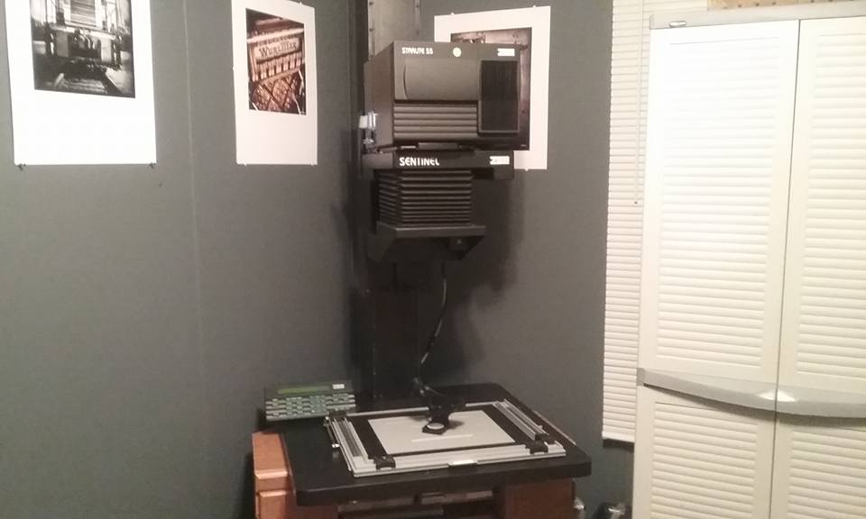

I have a ZBE enlarger and starting to encounter an issue with it. It will not hit the first reference point, thereby rendering the entire thing useless. Does anyone know if there are support numbers still? I've heard that there is a company that did take over this when they went out of business long ago, but I'm not finding it.
Or, does anyone have experience with the ZBE?

This is mine. It's just not working properly and very complicated for me to figure out. Hoping the link someone mentioned helps me find support.

Find a true Gyro Gearloose electronics store in some big city and ask around for someone who can diagnose circuits. ZBE is long gone. You could also call Jim Browning at Digital Mask and see if he still knows of anyone. He was involved in the development of the Chromira. ZBE supplied me with some things. I sure wouldn't give up on a Starlight just because of an electronic glitch. But my own philosophy is to never use an enlarger I can't fix myself. The less electronics, the better; or at least have a spare control, which might be impossible in this case. Find an old time geek who knows what a soldering iron is.

Another thing I have sometimes done is to bypass all the fancy solid state feedback controls and simply hard wire the system. The main problem with the Starlight was overheating. They were completely aware of it. It was built back when there was ample demand for very powerful colorheads that could punch big slow Cibachrome prints. I never cared for the salt-and-peppery effect of the Chromira printers, though it's far less obnoxious than the streaking people often got back then with big laser printers. I could have had one cheap (5% the original price), and a very nice drum scanner for free, but digital

Back then I used a 2000W Durst colorhead. Talk about running hot! I tossed all the electronics and rewired the thing with truck engine wire, then right into an ordinary 220V outlet which I had previously tested for voltage consistency. But later I designed my own additive head which runs much cooler. I'm sure a Starlight could be rewired; but that kind of tedious project might not appeal to everyone.
