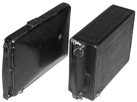

Someone said a compact 9x12 camera, well yes compared to say a 5x4 Speed or Crown Graphic, but then compared to a 9x12 Patent Etui . . . . . . . . . .
In practice that extra bulk/mass makes the camera easier to hand-hold at slower shutter speeds.

The problem with Patent Etui cameras is they use plate holders with an unusually thin lip. I've yet to find any that will fit my 9x12. I bought 4 boxes of metal plate holders 9 or 10 years ago, no luck, but there were two cased sets of 3 6.5x9 KW plate-holders, and a film pack holder. 2 years ago I found a really nice 6.5x9 Patent Etui, then early last year a 6x9 Rollex that was the right fit, I think £5, maybe £0 but no more.
So essentially I had a 6.5x9 setup much like the 9x12 you've just bought, I added 6 6.5x9 film inserts, and it sold to a Japanese collector.
I think the Agfa takes quite a common plate holder (in terms of edge fit), you should be able to find some film inserts for the plate holders. I should have said earlier the lens is in a Dial-set Compur, so pre-1929/30. The shutter has a serial number, and you should be able to look up a rough date.

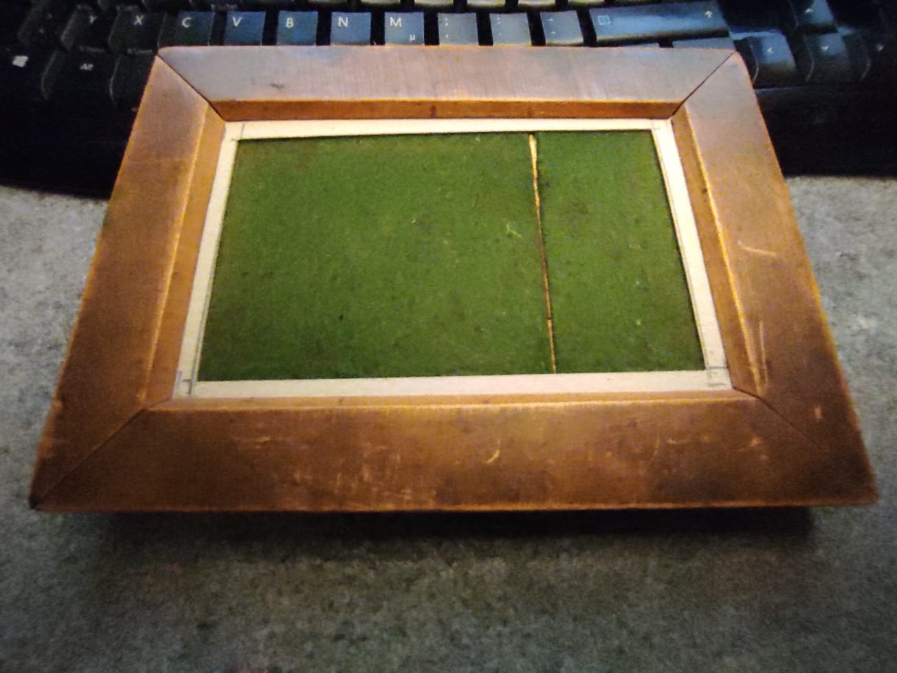

Though missing the glass, I also scored this for ~5 euros and it takes 9x12 cm negatives.

Another beauty albeit lens, perhaps shutter needs cleaning...

Very nice Agfa Isolar.
The "Tapeten-Rolleicord" is a piece of art, and I like the early frame counter. They are not cheap these days.

esp., the one available now for offer is very very clean.

9x12 Patent Etui
I had one of those a while ago; it was my first venture into sheet film. If it'd had a Tessar type lens, I'd probably still have it.
