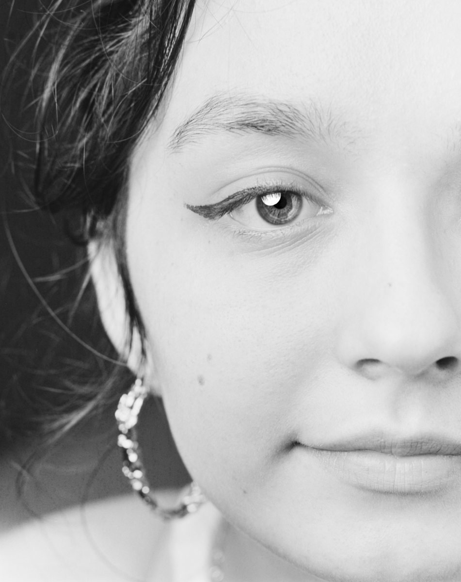

I seem to now CONSISTENTLY be getting wrapper offset issues on 120 film. This makes me wonder "if it's me, not you." I have a few theories:
1. It has something to do with red-sensitive film just being more prone to wrapper offset (I was getting the offset on Rollei Retro 80s, so I switched to Ilford SFX. Now I'm getting it with Ilford). And, then:
2. It has something to do with how I am cold storing the film and then warming it up. Perhaps I am not letting it warm up adequately before shooting? Or should I stop storing it in my fridge altogether? Is that a thing?
I cannot really think what else is causing this. I shoot Tri-X and Ultrafine Extreme, and have never had this issue (well, with the spottiness).
I develop in temperature-controlled water. It's tap, but, again, I'm not seeing this problem with other films.
Here's the pic. Look at the darker mids/shadows right above her shoulder:
What's a poor novice film photographer to do? Given the time and money invested and spent on film, camera, darkroom, etc., this constant waste of film and time is getting very frustrating.
This may be just good, old fashioned condensation, which isn't necessarily a wrapper offset problem.
Is the film within date?
I would try it without the refrigeration.
And the standard question, is this visible on the negatives themselves when you examine them visually under magnification?
I can’t advise on that and didn’t really notice until you mentioned it. Stunning portrait... “defect” and all. :smile:
OK, but what is the practical solution? When you say try without refrigeration, do you mean *never* refrigerate it, or only use it hours (days?) after taking it out of the fridge?
And, why would condensation only affect that particular exposure portion??
Thank you, but it's one of those things I can't unsee. :mad:
I can't see it. I refrigerate everything. For 120, in my refrigerator, not freezer, I put the sealed roll in my pants pocket for 5 minutes. I load magazines and cameras in air conditioner
If you mean the dark dots just above her shoulder, those look to me more like condensation or maybe even dust during the exposure (which blocks that spot from being exposed, so it's then dark in the print). Condensation doesn't always cover an entire frame. Water will try to stay together (surface tension, etc..) so may form micro-drops - I don't know for sure, admittedly.
Wrapper offset will look like numbers and letters from the backing paper.
When I use film that's been frozen, I let it sit a day before I open the foil wrapper. Most of the time, I don't freeze it anymore. I try to buy in small enough amounts that it doesn't sit around too long after the expiration date (and even then, I haven't had issues).
stick your refrigerated film in a freezer bag with as little air as possible before you take it out of the fridge, and leave it sealed in the freezer bag for 24 hours or more at room temperature before opening the bag...
It's the scanner. A exemplary reason for contact proofing. I don't know what it actually is but the most informative way to evaluate your photos is a good contact sheet. Nothing in the way. (Unless you have crud on your film, contact printer, lint from your shirt, dandruff, dead skin, static flashes...This is why I shave my head and work au naturel . )

If you're asking why 120 in particular should be refrigerated in a sealed wrapper, it's likely because it's wrapped tightly against the backing paper, offering opportunities for condensation damage.
Don't go crazy with film refrigeration. It only needs to be in there if you're going to store it for a long time. You can leave film at room temp for weeks or months (or probably a few years) without problems, unless you live in an extreme tropical environment where dehumidified storage may help. Don't take the film directly out of the fridge and unwrap it before it reaches room temp - that's a great way to get condensation, like a chilled beer glass. Don't keep taking film out of the fridge and putting it back in.
Well, it can also manifest itself as mottling and other changes of texture in the image.
Roughly speaking, it occurs when there is a chemical reaction in the film emulsion caused by an interaction with the backing paper and/or the printing on it.

Did any other frames exhibit this issue?
Yes, in the same tonal area. I’ve had similar results with Rollei Retro 80s in 120, and blamed offset. My MO with both, though, is the same as far as short warm-up times. I will try a 24-hour acclimatization period from now on on see if that makes a difference. I just find it strange that I’ve never had this issue (splotchy shadows/darker mids) with Tri-X or Ultrafine or HP5. Only the extended red films.
I could be wrong, Dusty Negative but I think Brian means other frames on this particular film where you have shown us the one of the portrait Like a few others here I have looked very carefully in the general area you describe and can see nothing.
Can you say exactly what it is you see and arrow it with a circle
