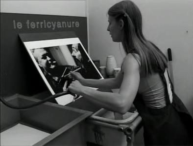

Some aspect no one seems to have commented on yet, but that I also find intriguing as I have never applied it, is that in the first print we see her make, after the first fixing bath, she applies what in the French note text is called "le ferricyanure". She applies it locally using a brush, and than reinserts in a second fixing bath.
I guess this is simply a dilute ferricyanide bath to reduce the densities of the darkest shadows a bit, which also explains the second fixing stage after that to remove the bleached silver. She washes the ferricyanide away with a hose of running water just after applying it.

K-G commented on that, Marco. Looks like a really good idea and I think I'll try that myself when time comes.
She uses ferricyanide bleach (aka Framer's reducer) to lighten areas she thinks are too grey, e.g. the white of the eyes.
You can also dilute the bleach even further, so that it's rather weak, in which case you can immerse the whole print to lighten not only the whites but all tones.

Is the solution really ferri & fix? If so, I thought that had a very limited lifespan once mixed (like 5-10 minutes). If you watch the video she comes right out the darkroom, sticks the print to a board and starts using the pre-mixed ferri. It also seems to work visibly...
I meant ferri and fix one after another, not mixed in one solution... That is how she seems to use it according to the video.
I have kept ferricyanide working solutions for over a year without problems using it for a two bath bleach & redevelop sepia toner.

Just catching up on this discussion. I attended a workshop put on by Bruce Barnbaum a few years back. He rubs the paper directly (no gloves, just hands in chemicals) while in the developer to produce this heating effect that has been discussed. As I understood it, the purpose is to add some extra depth or tone to the highlight areas. He also uses the same localized bleaching technique; however, he uses a small hose with running water just below the area receiving the bleach. The purpose here was to avoid any runoff that could cause light streaks in the finished print as the liquid ran down the paper.
