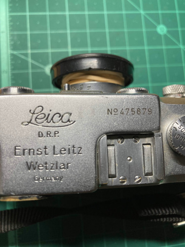

I recently bought a Barnack's Leica in a severe crisis of GAS, you know. It was a IIIc sharkskin one. It came with an old Elmar 50mm, the one that ends with f18, and of course uncoated. In my defense, I have to say that it was relatively cheap. I suppose that the camera is around 1949 and the lens is about the late thirties. Finally I was going to be one more of the happy family of Leica owners (the cheap Leicas branch, I mean).
When I exposed my first reel, I had no complaints with the lens, but the camera curtains have pinholes. If you look at the curtains from the front of the camera you can't distinguish any one, but if you remove the housing and look through them with a strong light from the back, it's like the Milky Way at night. As the saying goes, the poor man goes to the store twice.

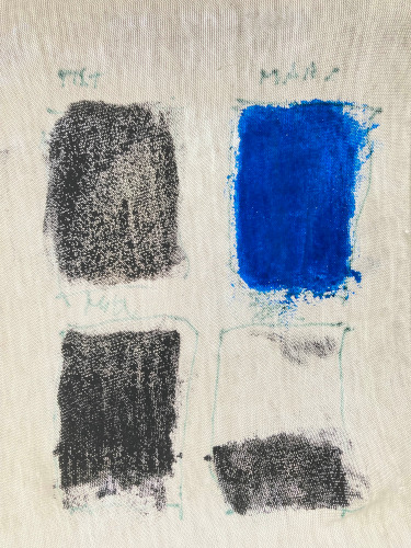

I took a piece of thin cotton and tried several kinds of painting.
I painted this four patches and then I put a strong light behind and check its opacity.
The patch top-left is cloth painting. At the very beginning it was very promising, tight and opaque.
Bottom-left is again cloth painting diluted with 20% water. Little less opaque.
Bottom-right is another kind of a very thick cloth marker.
Finally, the winner, at the top-right is 3D Paint, it was really opaque from the very beginning. It's blue for no other reason that it was what they had in the shop.
The result that you are seeing is a picture through a window of the cloth-test let dry for two days. Funny thing is that cloth-painting and cloth-market srank a lot when dried, and they are no more light tight. However 3D paint remains mostly opaque. Once dried the cloth-test remains very flexible in all patches, so this wasn't to be a concern.

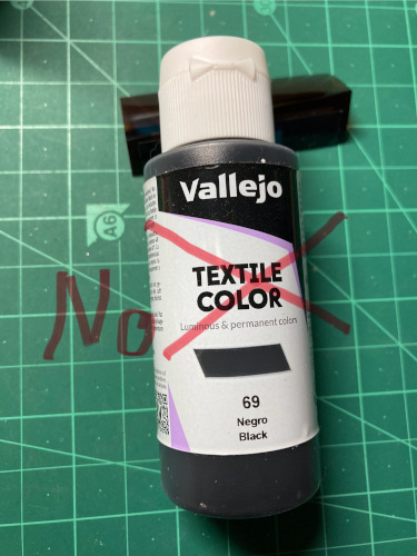

Don't use this kind of paint.

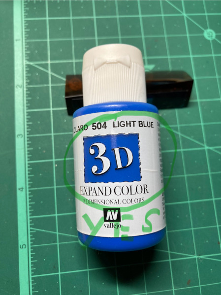

Use this, instead.
Use this, instead.

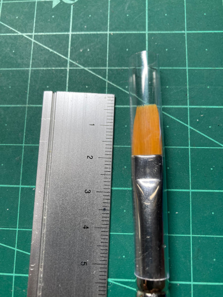

In his video, Mikeno62 removes the housing, and paints from the back of the camera. I did more or less the same. Instead of a spatula I found more convenient to use a brush. Surprisingly, 3Dpaint blue color is a helper that lets you to see where actually are your strokes.
