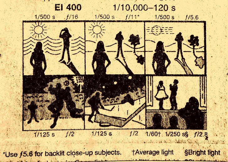

The diagram from Dan is good for 400 speed film, not so much for 100.
Here's a table from a typical 100 film: https://www.google.com/search?q=sim...7AkIkgE&biw=1478&bih=826#imgrc=IlE-CbM8pGEKBM:
