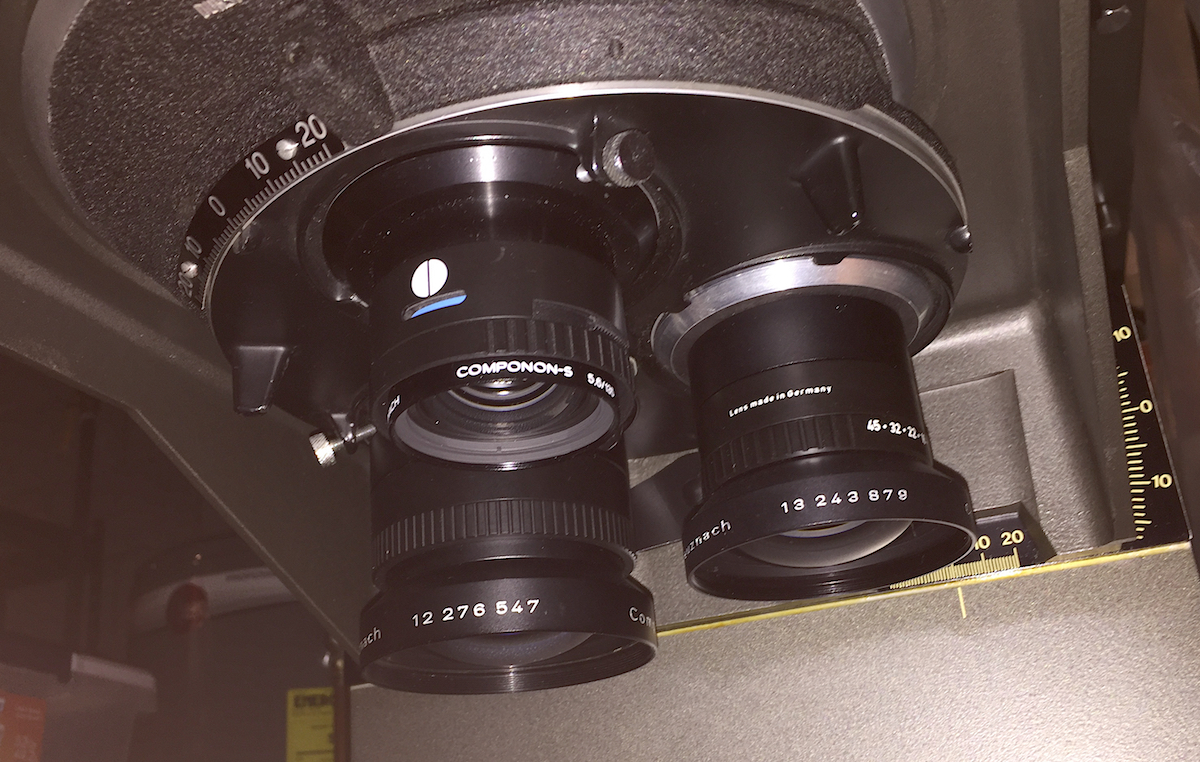

... and several hours swapping out equipment.
What?? No Turret??
The Durst mixing boxes are big but they slide in and out on wheels! They are mostly hollow, so they are pretty light weight, even they have two handles each!
BTW on this enlarger the 135mm is for medium format and the 210mm is for 4x5.
