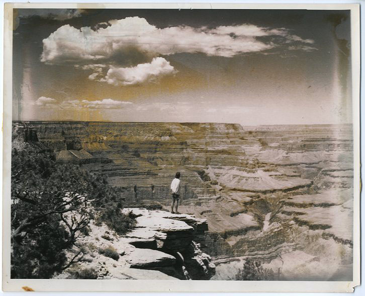

Just for fun, here is my first image I ever printed (a self-portrait with the Rolleiflex) -- in the employee darkroom at the Grand Canyon in 1977. Chemicals were fresh, but no guarentee about the process! Some fading of the details in the highlights.
I gave this print to my dad the same year, and my mom framed it -- probably an Aaron Brothers mat and frame. It was displayed (no direct sunlight) for about 33 years, despite my offers to reprint it, LOL! I doubt that it was window-matted with acid-free material, some masking tape was on the back, and no toning. Another copy made at the same time and tossed into a folder looks like it did the day I made it.
Kodak RC glossy
