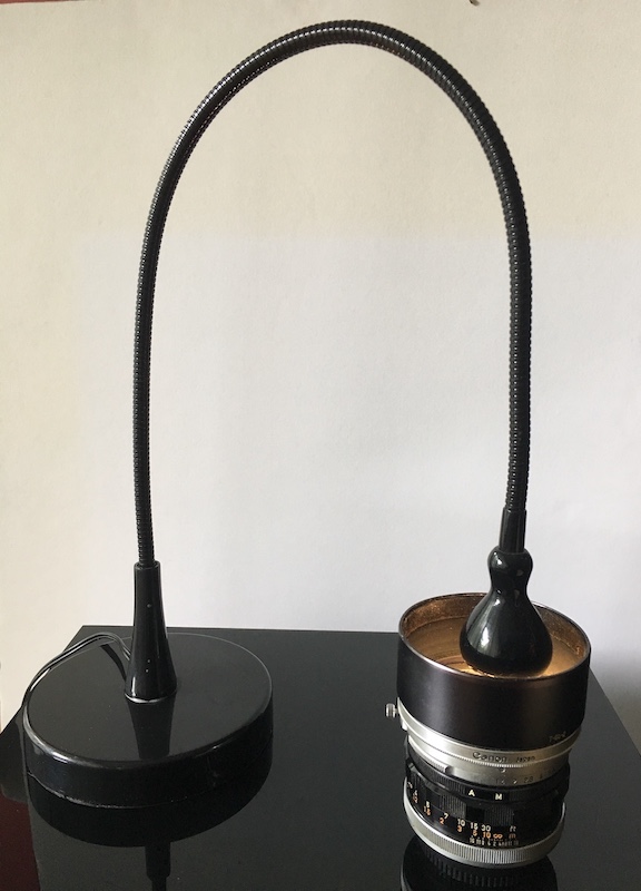

Then expose the lens to a bright light (IKEA jansjo) or a UV light to clear it.

Andy, with proper UV light source it will take days and with this Ikea LED lamp weeks to clear it up. Nothing will happen in a few hours.
