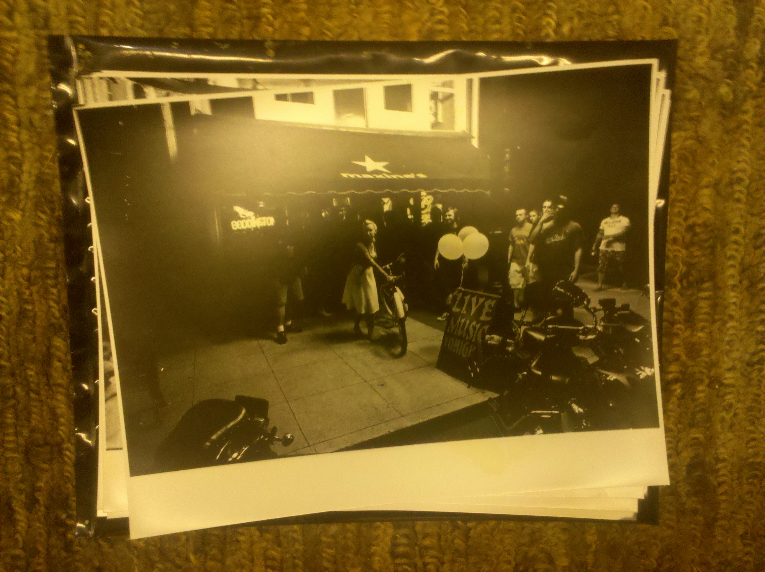

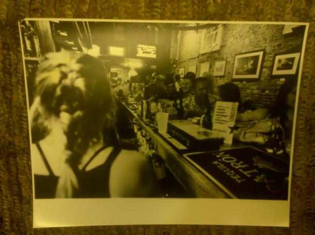

I've included some images but as they were taken with my camera phone, I don't own a digital camera, the yellow spots are hard to see. If you look carefully at the shot with the back of the girls head you can see the yellow in the blown out parts of her hair, top left. In the bicycle shot you can see it on the bottom right (Five o' clock)
The entire package of paper did this, every print. I fix for the recommended time, and wash extensively. After the first problem occurred I washed these prints for over an hour.
I showed the prints to a few people and they said there was water on them at some point of manufacture. I've had this problem with other batches of ADOX but never to this extent.
Can anyone tell me what this is? How to correct it?

The pictures are harder to see than I thought. I can't control the white balance on the camera phone and that makes it even harder.

I tried to balance the colors of one of the images out . I can see a yellow spot quite easily near the lower border:

That's it! Thanks for your help. Now what is it and what can I do to prevent it in the future?

From what I can see these look like fixer stains but ofcourse this is hard to tell with these images.
Did you process every sheet individually in the trays or can it be that you have kept several sheets in the fixer/water at once?
During manufacturing there will get no water on the prints after drydown else they would glue together either on the roll or as a sheet.
But even if water got onto the sheets there should be no yellow stains arising from this. All emulsion is aquaous when coating and then dries. Rewetting it and drying it can lead to physical border effects around the wet spot but not to a colour change (at least as far as I know).
In this case you could see the wrinkles when you pull a sheet from the black bag.
If they don´t show on the paper prior to processing they originate most likely in the process.
