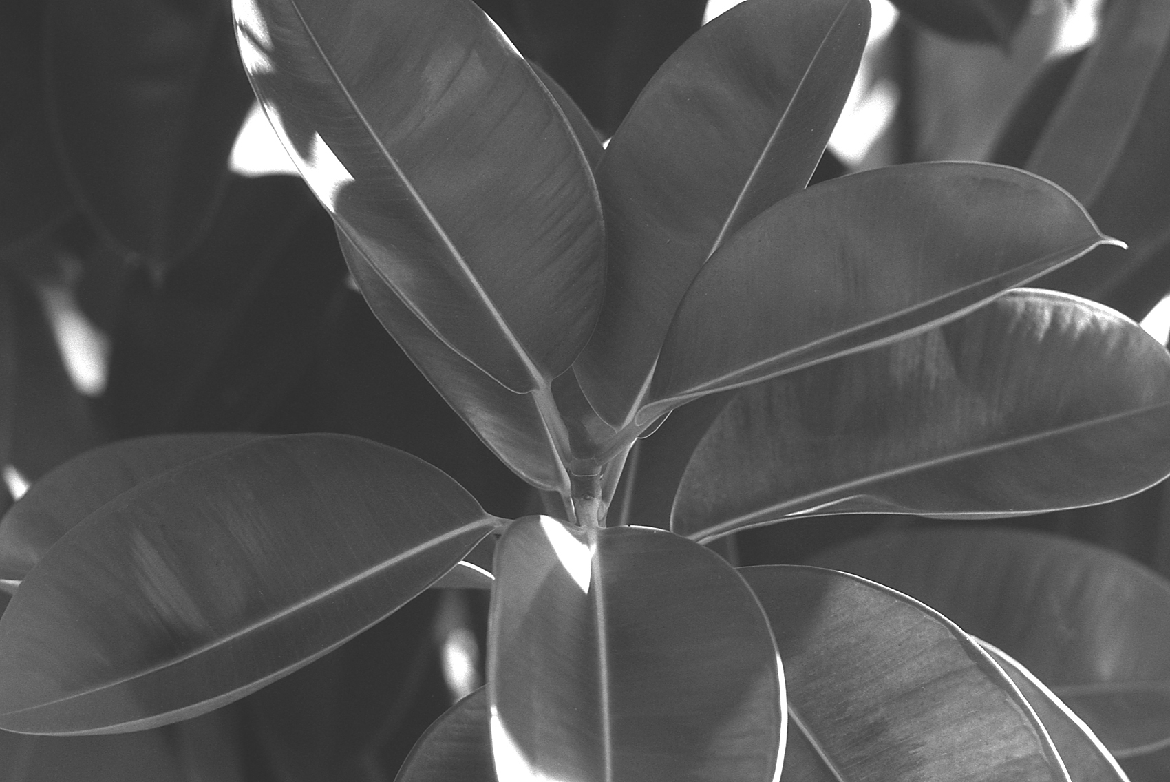

I was doing the final testing to decide which portrait lens works best (it's a real toss up between my FD 135 2.5 and the FL 135 3.5, so I'll keep 'em both) when I noticed something. First, using a yellow filter on portraits really changes the look, and not always for the better, depending on the skin color of your sitter. Second, when shooting foliage, you not only get a different look with or without a filter, you also get a strange lack of detail.
The shot below was first taken w/ no filter on the FD lens. The second pic shows it w/ a yellow filter. The values haven't been properly adjusted to appear equal, but you do see less detail in the leaves for sure w/ the yellow filter. I took this same shot w/ the FL lens w/ a yellow filter and it looked exactly the same, so it's the filter and not my FD lens. Film was Arista EDU Ultra 100 in Mic-X.

"you do see less detail" Actually loss of contrast. If not an artefact of conversion to numerical (only you can tell) it might be diffuse flare. Did you check your yellow filter for haze, scratches, and the like?

Looks like lack of contrast to me as well rather than lack of detail. If the filter is a high quality one without blemishes then I have never seen any suggestion in any books on filters that a yellow filter will reduce detail.

A filter may not reduce detail but it could change color renderings and that could reduce contrast. Filters aren't comb filters- they can have an effect outside of their specific color. And something like a plant isn't a just 'green.' It is a variety of color shades, including yellow very often.
So maybe there is something going here with the spectral response of the film, the filter's spectrum, and the plant to cause it to reduce contrast between the various shades of green in the leaves, leading to a perception of less detail.

The second image looks underexposed to me, which would result in the much lowered contrast already been mentioned.
It may also be an issue due to a change in exposure. If the yellow filter caused the meter to incorrectly expose the scene, it can result in a loss of contrast and a lack of apparent detail.
Examining the negatives may help determine the issue.
Are the examples you posted from scanned negatives or prints?

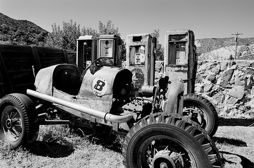

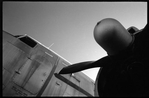

Using a polarizer on anything wider than 28mm's will cause uneven color in your skies, which surprisingly, doesn't bother me.
24mm lens and polarizer. No post processing.
Orange filter and polarizer. 35mm Delta 100 film. No post processing.
Orange filter. Ilford XP-2, 20-40mm glass. No post processing.
Orange filter on Neopan 400CN film. No post processing.
Deep yellow #15 filter. Neopan 400CN film.
Deep yellow #15 filter, Neopan 400CN film.
Orange filter, XP-2 film.
Orange filter, Ilford XP-2 film.
