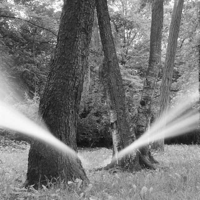

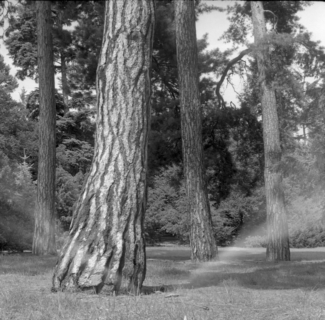

Hi there,
I'm experiencing some annoying problem with my Yashica Mat. At random, strange light streaks appear on my negatives. It's always at the same position and the same shape, only intensity varies from non to really heavy. It happens in all lighting conditions and directions of light. Also it's always within a frame and never on the borders.
What I have tried so far:
- I am using an original lens hood.
- I have flocked the entire interior of the film chamber with black matte material.
- I have checked the lens and there is no trace of fungus or dirt.
Can it be a light leak if it doesn't appear on the borders? Please help!
Many thanks,
Marcin

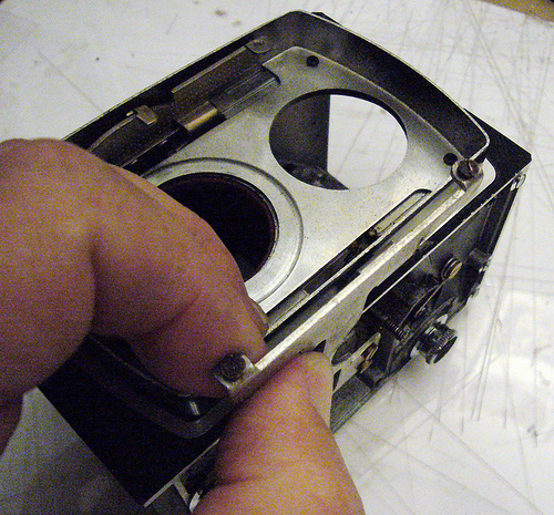

I'll mention the felt light seal around the back of the lens barrel again. Here's a photo of the area- the lower opening in the silver plate is where the felt trap is-
If you open the back and move the lens to close focus, the rear barrel will move forward and you might be able to just see the felt.
A problem I had with a Rolleiflex 2.8C was solved with an added light trap around the viewing lens. Best as I could ever figure, the light was coming through the focus screen. This could be a source for your light?

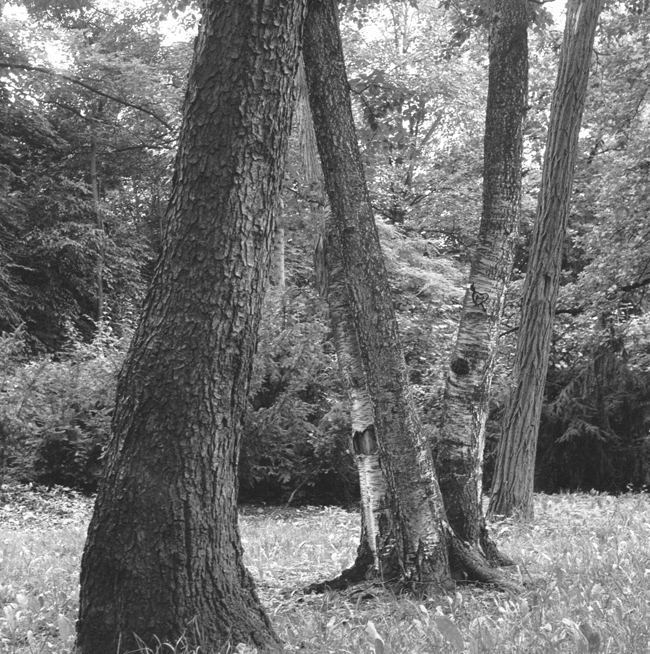

I did another flash light test in the darkroom and spotted a leak coming from the focus screen (Dan you were right). I added some sealing around the viewing lens and the problem seems solved - I've just developed a roll and despite sunny conditions no white streak is present.
Thanks a million everybody!
