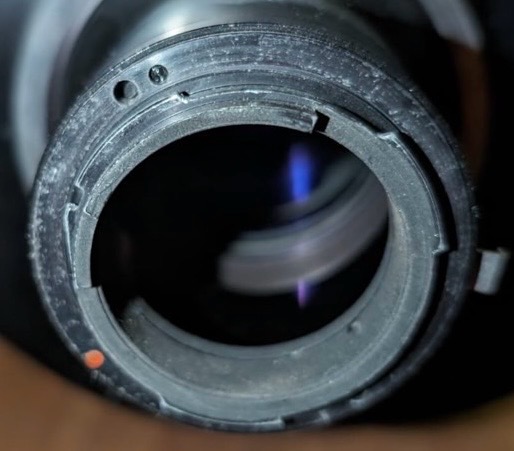

Thanks for the answers.. it is not my lens, only one for which I have looked for a long time, quite rare in QBM mount. Here is the picture shared by the seller. As there seems to be little hope for conversion, I think I will pass on the sales offer..
It's hard to tell what it is from that picture... there's no sign of an auto diaphragm lever so is this a manual lens of some sort? There seems to be a lens release on the side which is wrong for Yashica.
That "lens release" on the side might be an interchangeable lens mount release (Y-S?) with the actual lens release button on the camera body.
