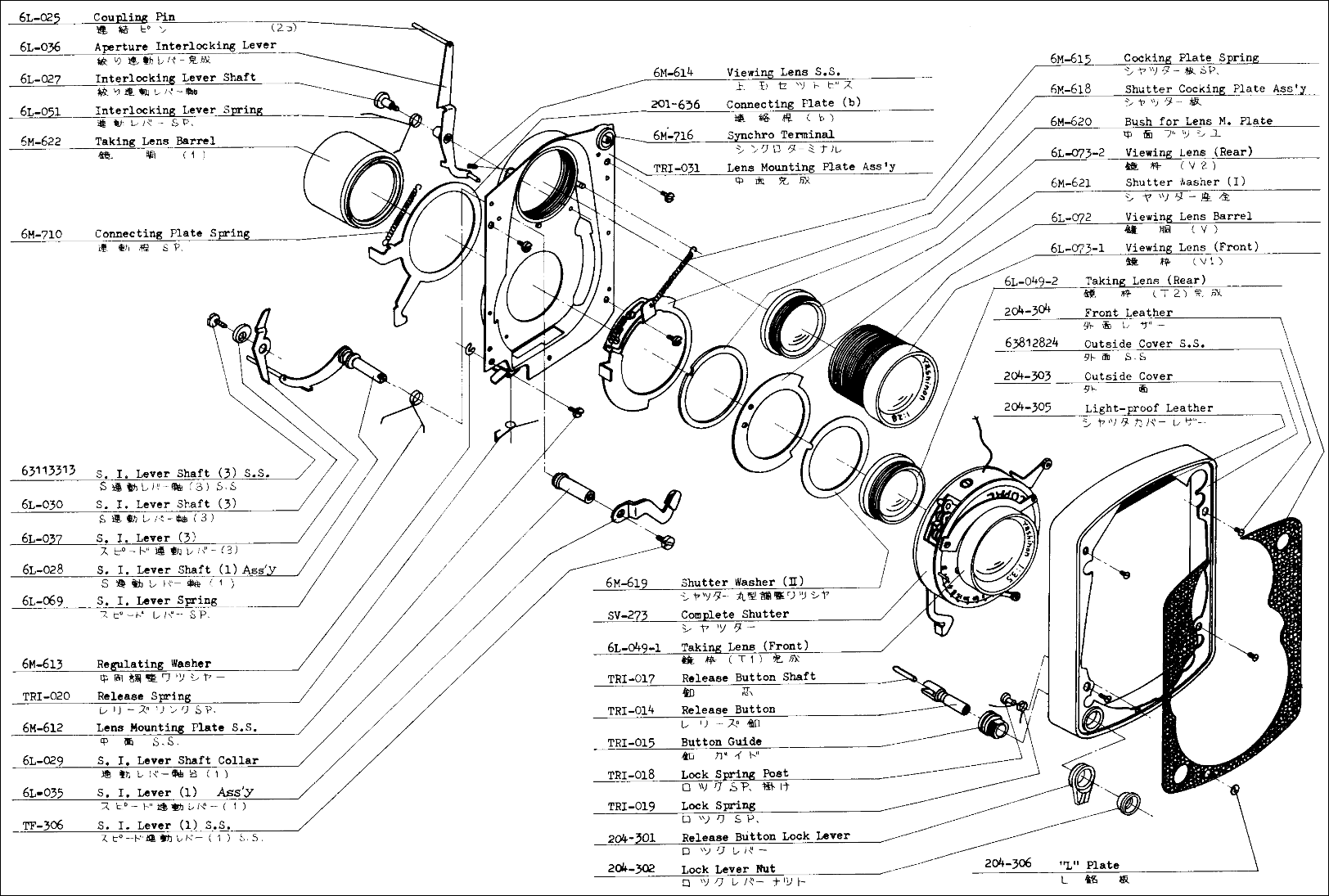

I just got a sweet Yashica Mat with schmutz on the lenses. Initially I feared it was fungus, but it appears to be garden variety schmutz. Taking lens came off with the rubber tool - mirabile visu! The viewing lens won't budge. Could this perhaps be a left hand thread? (I'm haunted by thoughts of Ricoh and Kodak).

I have a set of exploded parts views for the Mat 124g and it looks as though there is a setscrew behind the camera lens mounting plate that allows locking the viewing lens setting. I know an old Flexaret here had setscrews on the viewing lens also. I chickened out and had Mark Hama do a CLA on mine a couple of years back, so I've not personally attacked that area.

I recently disassembled the entire front of a Yashica D, and the taking lens was one thing that simply would not budge.
EDIT: It's the set screw, see above. TIL.

Hey guys, thanks for the update. I must have had my head up my a$$ to not think of that. A while back I did a complete CLA on a RolleiCord and it worked the same way. That is probably pretty standard on TLR's with moving lens boards.
