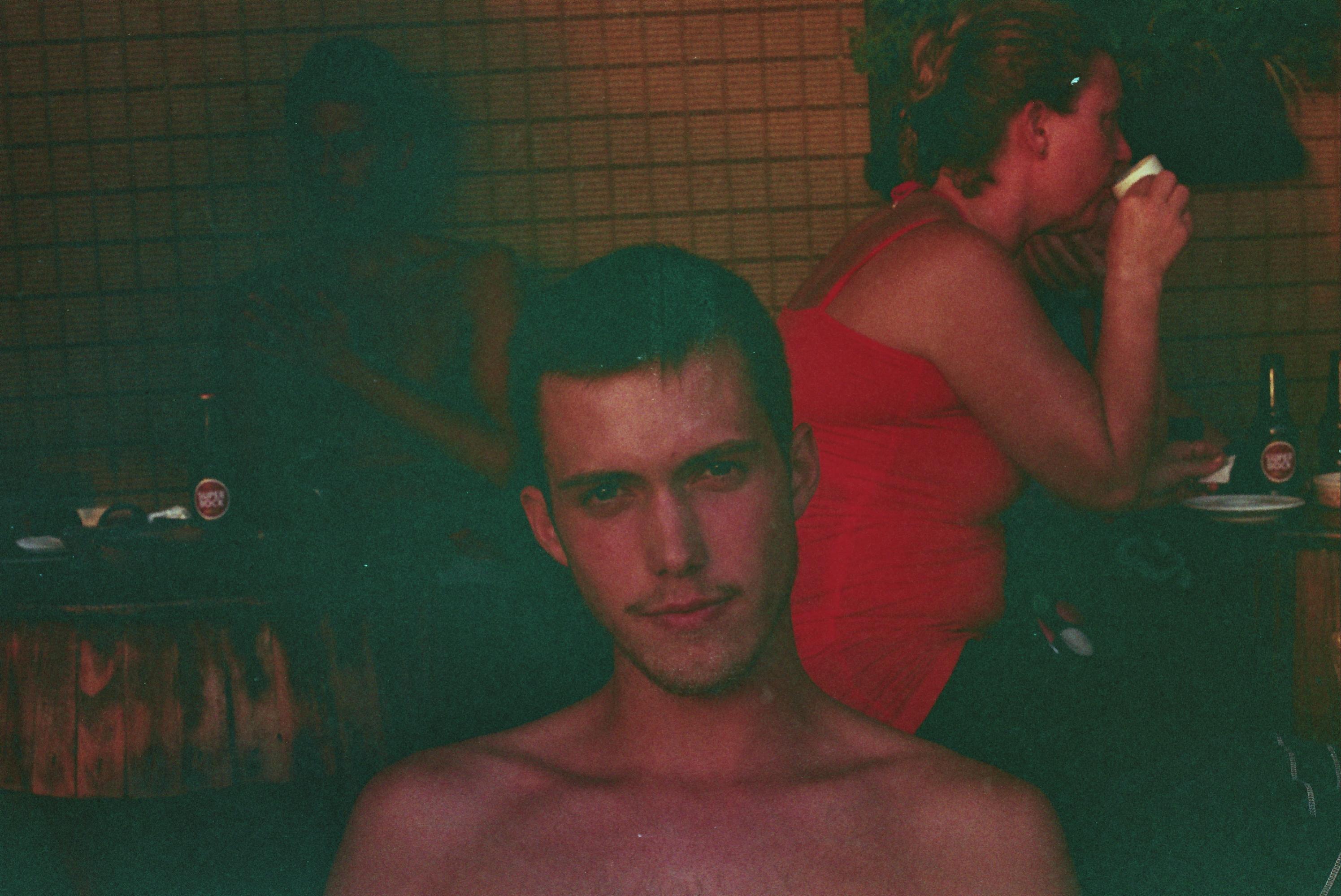

I love analog photograph but I'm a huge dumb about it. My mom has an old Yashica FX3 super 2000 and I'm trying to learn some things with it. I took it to fix some things, it's supposedly good now but almost every photos that I took until now are ruined. This will probably be a very stupid question, maybe I'm just doing something wrong. In one film of 24 photos we can only see about 6 of them but they are very dark and the colors are distorted. And it has happened twice.
Here's some examples:
Any thoughts about what could be? Am I doing something wrong, is it the camera, and how can I fix it?
Thank you very much in advance!!

What could be wrong? Based upon the photo you sent, it does initially look like light fog. I wonder how securely the back of the camera closes? Check that first.
Then do the following: take off the lens, cock the shutter and set it to 1/1000, open the (empty) back, aim the camera at a bright light, then fire while looking closely at that film gate. You should see a FULL aperture window appear at the film gate at the rear of the camera (the usual 24mm X 36mm film format). If you do, chances are that your shutter mechanism, and curtain openings, are working fine, since that speed is the first to fail with the curtains opening correctly.
That done, I wonder if the processor is ruining your film? I imagine that you do not do your own processing, because, as you said, you are a 'huge dumb' (but perhaps not as uninitiated as you proclaim to be!) However, do keep this possibility in mind. Again, based upon what you have disclosed and presented for scrutiny, this is all I, and perhaps all, can impart.
You say that the 'photos' do not appear. What about the NEGATIVES? That is even MORE important, margou. Tell us what THEY look like. Maybe everything is UNDERexposed. In that case you will NOT get pictures, and, in that dire case, the film, itself, ends up being the 'huge dumb'. - David Lyga

The first photo is grossly underexposed, fairly common with flash because of the overrating that flash manufacturers typically gave to their product. I'll bet that that negative is pathetically weak.
The second photograph is actually 'correctly' done but, because of the extremely bright sunlight beyond the trees, the meter 'thinks' that the whole scene is far brighter that it really is, and, as a result, gives less exposure than needed. You have to correct for that situation (called 'backlighting') and give more exposure when you think that your negative will be underexposed. Sometimes that intelligent meter can, also, be 'huge dumb' and has to be overridden.
The whole problem could (not necessarily is, though) be underexposure. Again, what do those all important negatives look like. Is all the detail there in big, bold colors? I think not. If you have weak negatives you have bad prints. Period.
