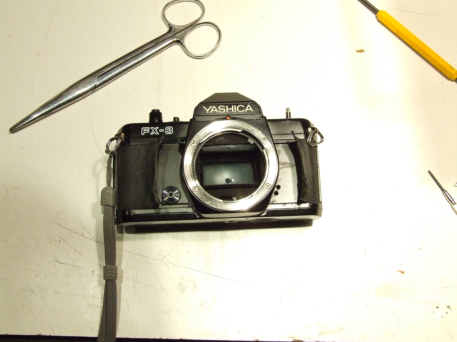

To get the mirror to snap down, one needs to expose the mirror mechanism. It resides on the RIGHT side of the mirror box and on the BOTTOM of the mirror box.
I peel back the covering to expose the 4 screws holding the front cover in place. The 4 screws are farther under the covering, and not seen in the picture. Also, take off the self-timer lever by peeling away the cover and unscrewing (normal thread screw.)

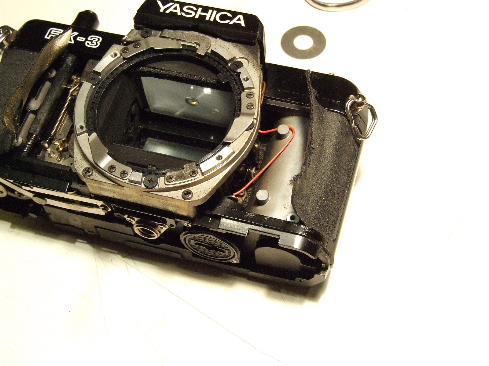

The mirror mechanism is on the other side of the mirror box (this photo is from a prior repair).

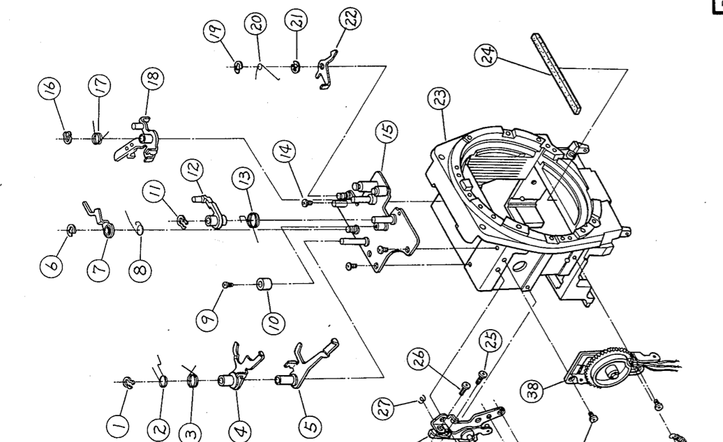

I was able to push lever #18 (QRL-1 in the manual) down and that got the mirror to snap down. After doing that a few times, it was working fine.
In case it continues to get held up, one solution in the manual is to alter the articulation between #18 (QRL-1) and #4 (QRL-2)
