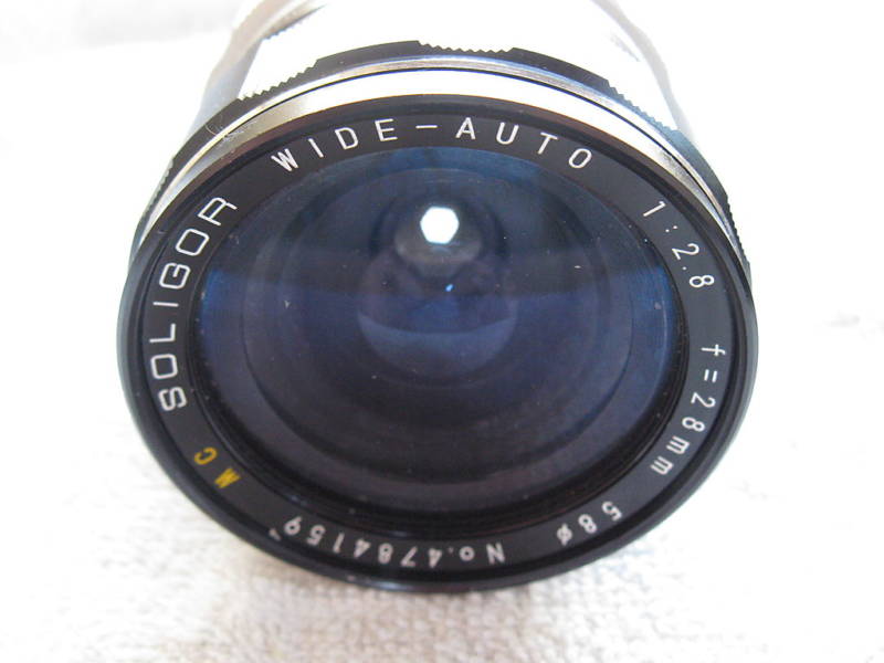

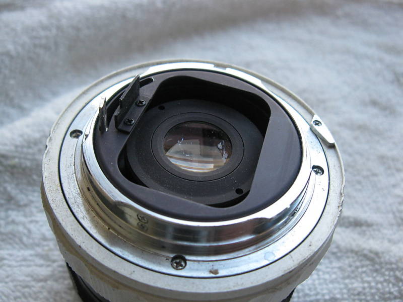

Soligor Lens .. I need an ID
I recently acquired a very heavy Soligor lens. The lens is a Auto Wide 1.2:8 28mm. Can you identify the camera mount? And whats up with the rectanglur shape? It has two pins. one moveable(shiney one) and a stationary wider black "pin". The matte silver ring is the aperture ring and reads 2.8 - 16 with EE at the end.
When researching the net I thought I found a similarity to Nikon, Miranda, C/Y. But alas...nowhere. You just don't see too many rear end shots of lenses or one of the lens rear end and camera body throat/mouth.
Thanks. .

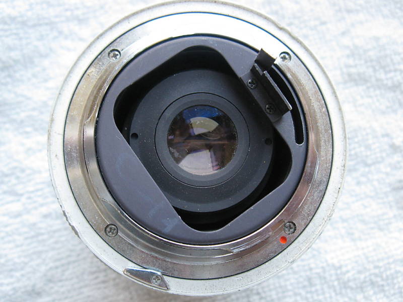

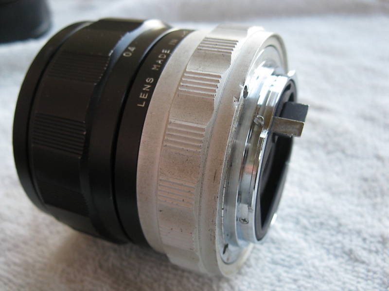

Better Pics of the Soligor 28 - i hope
I forgot to mention...see the small orange dot. I tried this lens on my minoltal srt and a pentax,,,but no dice.

sidearm613
Nov 16, 2008
268
Los Angeles,
You might want to try it on a Praktica B-mount. Its similar to Pentax K, but not quite interchangeable. Also try Minolta or Konica. Its not C/Y or Nikon F.

Thanks ELEKM... the trail led me to
Does/Did Konica have their own bayonet style?
In fact Konica does have it's own style of imcompatibility.
Elekm,,you suggestion led me to google which led me to konica pages and led me to another APUG post... which I've visited and asked who ever reads it to visit this thread for a look see. But by golly good fellow I think you nailed it.
Now i'm serching ebait ....uuuuuuuugggggggggghhhhhhhhhhhh!:tongue:

Francis in VT
Sep 27, 2006
123
This most definitely is a Konica mount. I just compared it with a Hexanon 50 mm.
The reason there are so few adapters is the 'back distance' lens to film distance. The lenses are useable on The Olympus 'E' system from what I have read.
Try konicaslr@yahoogroups.com for more information.
