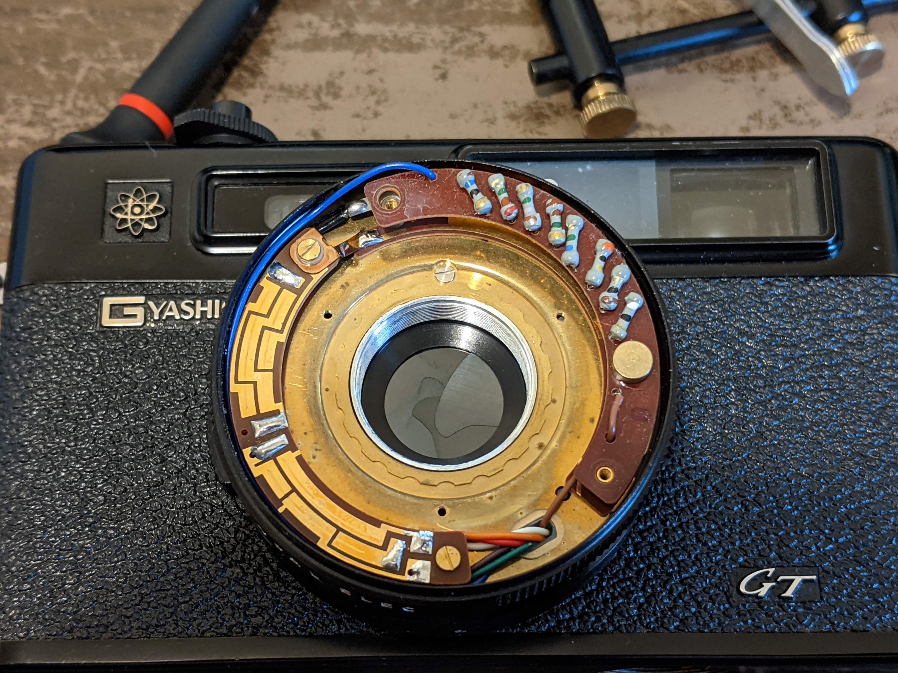

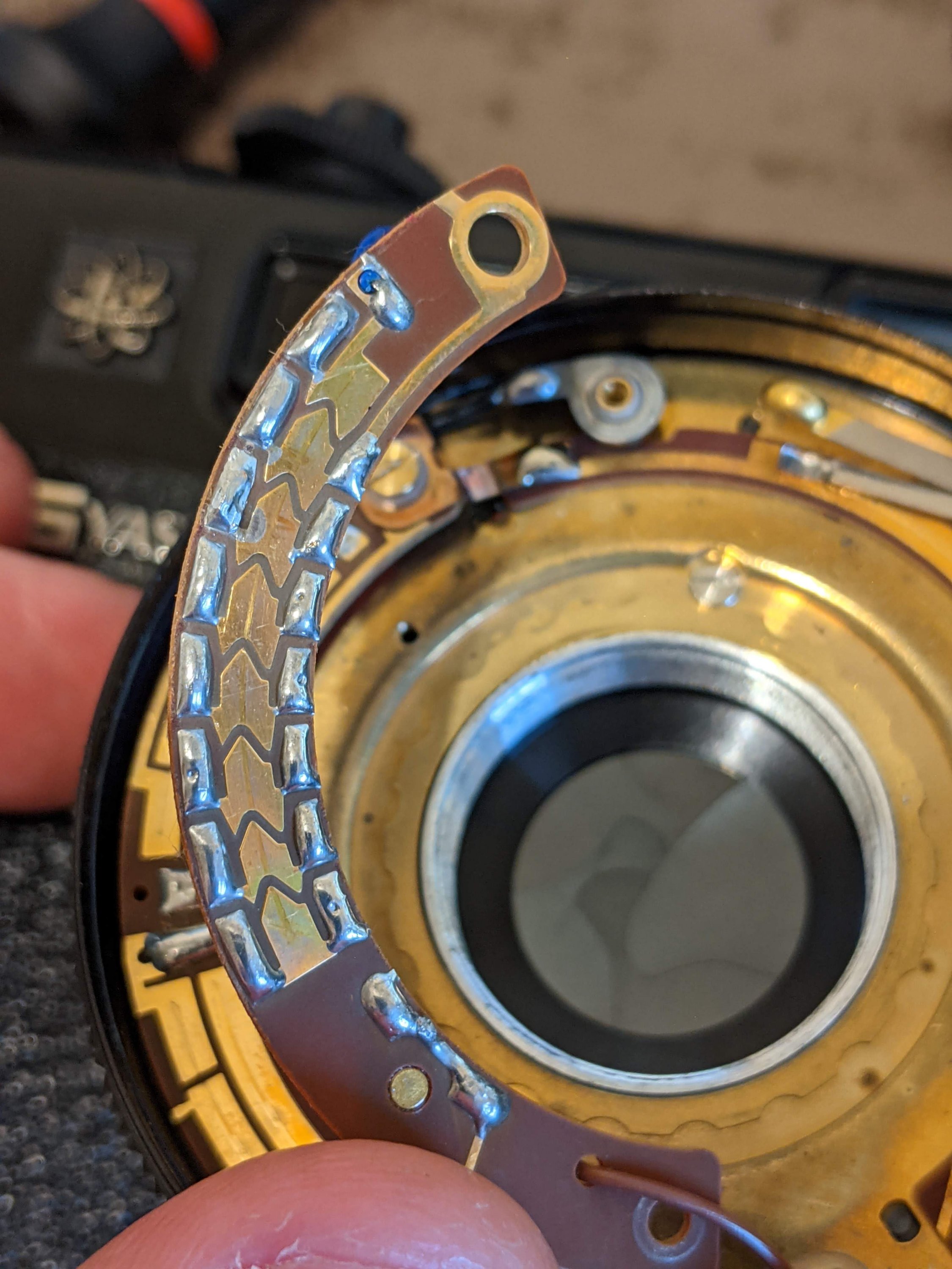

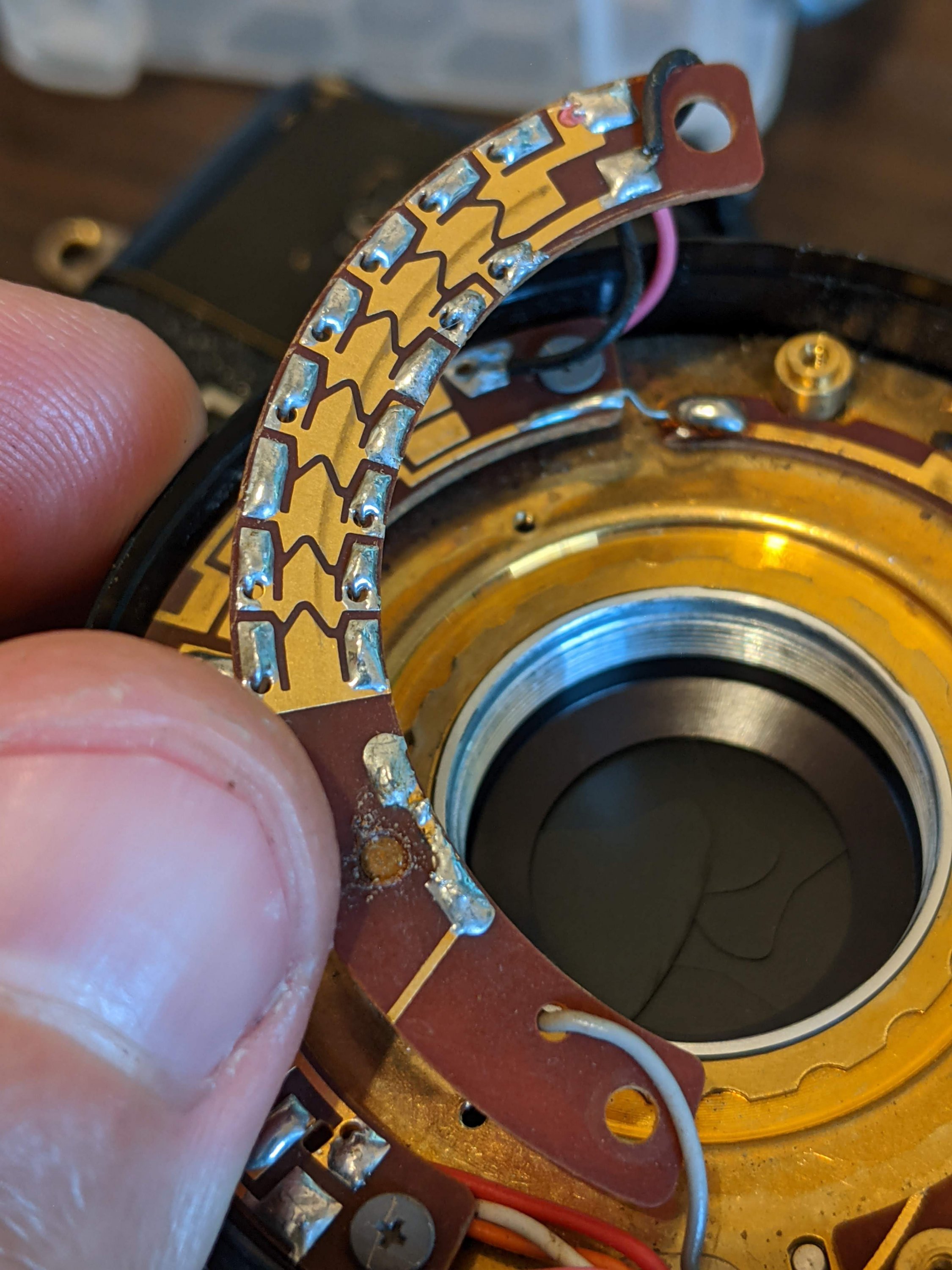

I finally got round to having a look at this.
It was considerably easier to dissamble than I remembered. Unfortunately, contacts weren't that dirty. resistances ~matched the colour codes and the resistances along the various contacts of the variable resistor were fine.
Issue remained after cleaning.
Looking at the repair manual my next suspect is the timing capacitor. I wonder what type it is. Old caps (electrolytic) are always suspect (ESR).
I also discovered my spare "GSN" is a GT and the winder off my GTN doesn't fit it. Also seems to be dead (battery indicator does nothing). I have plans to do some modding to this in the future knowing its status now.

I can't see it's the capacitor. If there was a problem with it then it would affect all apertures. You have a bad contact somewhere in the lens.
That's why I thought it was a contact to begin with.
I've checked each aperture-ring contact summing up the resistance values for each segment. They all added up correctly. I inspected the solder joins of the resistors and none looked suspicious. I guess I could go over the contacts with a PCB eraser to be sure although that's probably a bad idea with the gold-plating.
Is there any other contact I should be checking? AFAIK, there's the mode selecting contacts (the mode selector and contact bridging it to the aperture-ring), which was filthy in the flash segment, but cleaning made no difference.

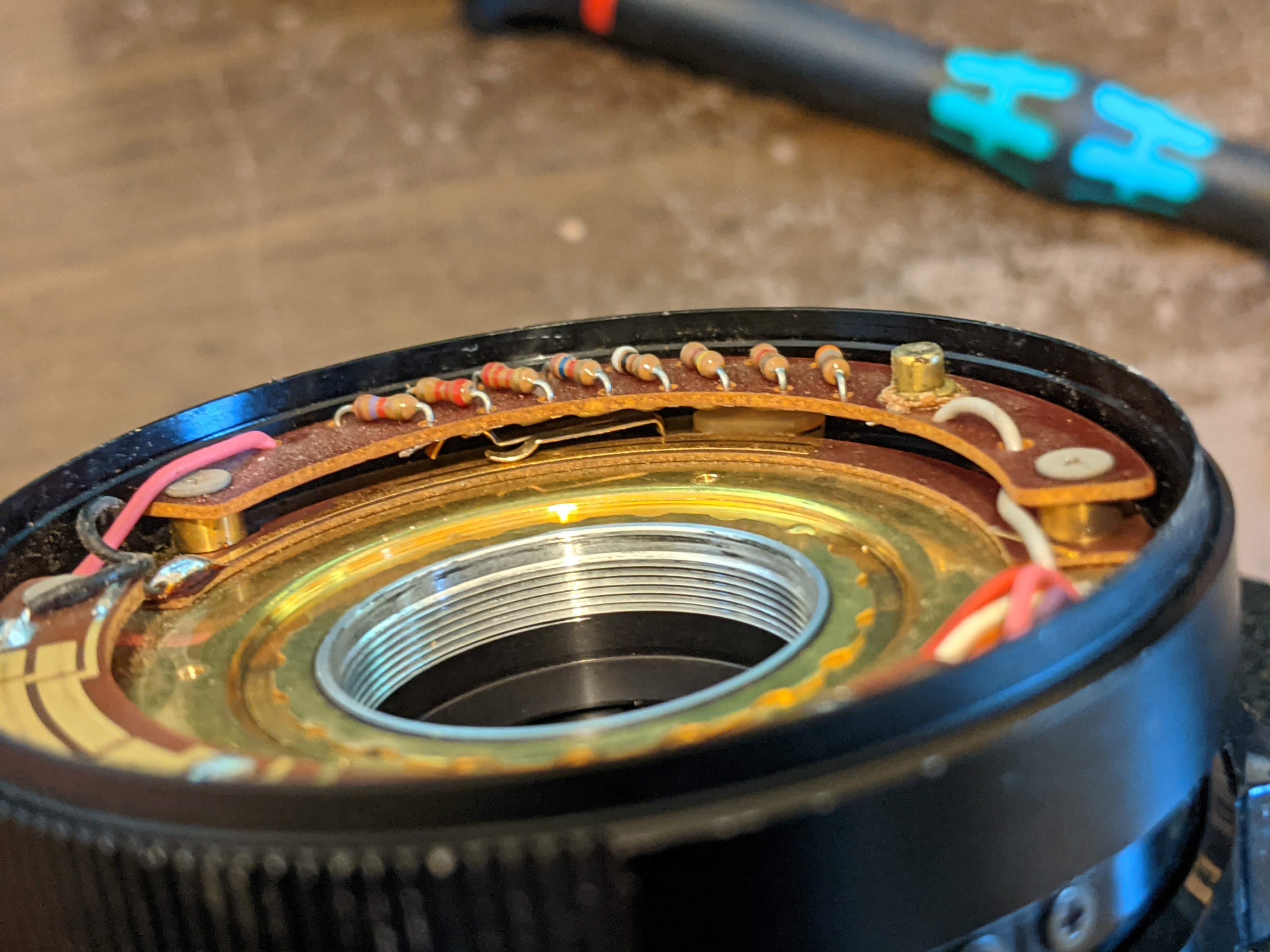

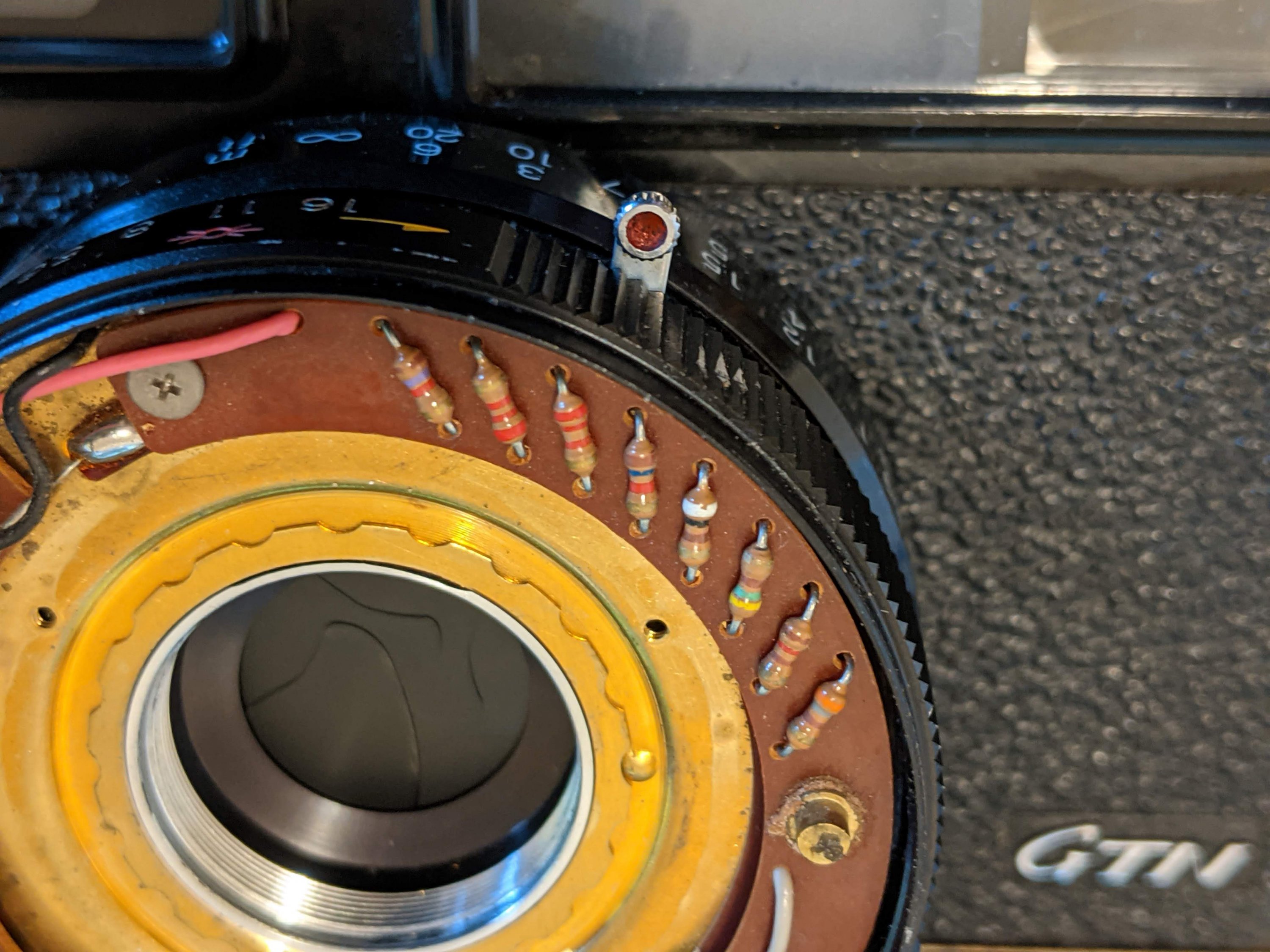

As it was simple enough to disassemble, I rechecked the aperture-ring resistor but this time taking into account the sliding contacts.
I measured between top/bottom of the variable resistor and the slider contact (the trace for 'A' of the function switch).
Nothing odd was seen. The values increased in line with the measured+displayed values of each resistor (not the same values in the schematic attached).

As you have another camera, have you tried comparing measured values with that? It might show up some differences that lead you to the problem.
I've realised i've got the models wrong earlier. The spare is a GT. The one with the issue is a GTN. The GTN allowed use of ISO speeds up to 1000 whereas the others allowed up to 500.
I measured anyway and the values matched the GS listed values.

I'm a bit confused by the values you've measured because they don't match the values on the GS circuit diagram. But what's clear is the GS and the GT seem to use the same resistor values but the GTN uses different values so comparing the two isn't valid.
I'm not sure where you measured the values on the GTN. The resistor board wiper also wipes along a solid track on the board below to make the connection back to the function switch. Have you cleaned that track? Did you include that track in your measurements? Would be worth cleaning all the tracks if you haven't using a fibreglass PCB cleaner pen (it won't damage the gold).

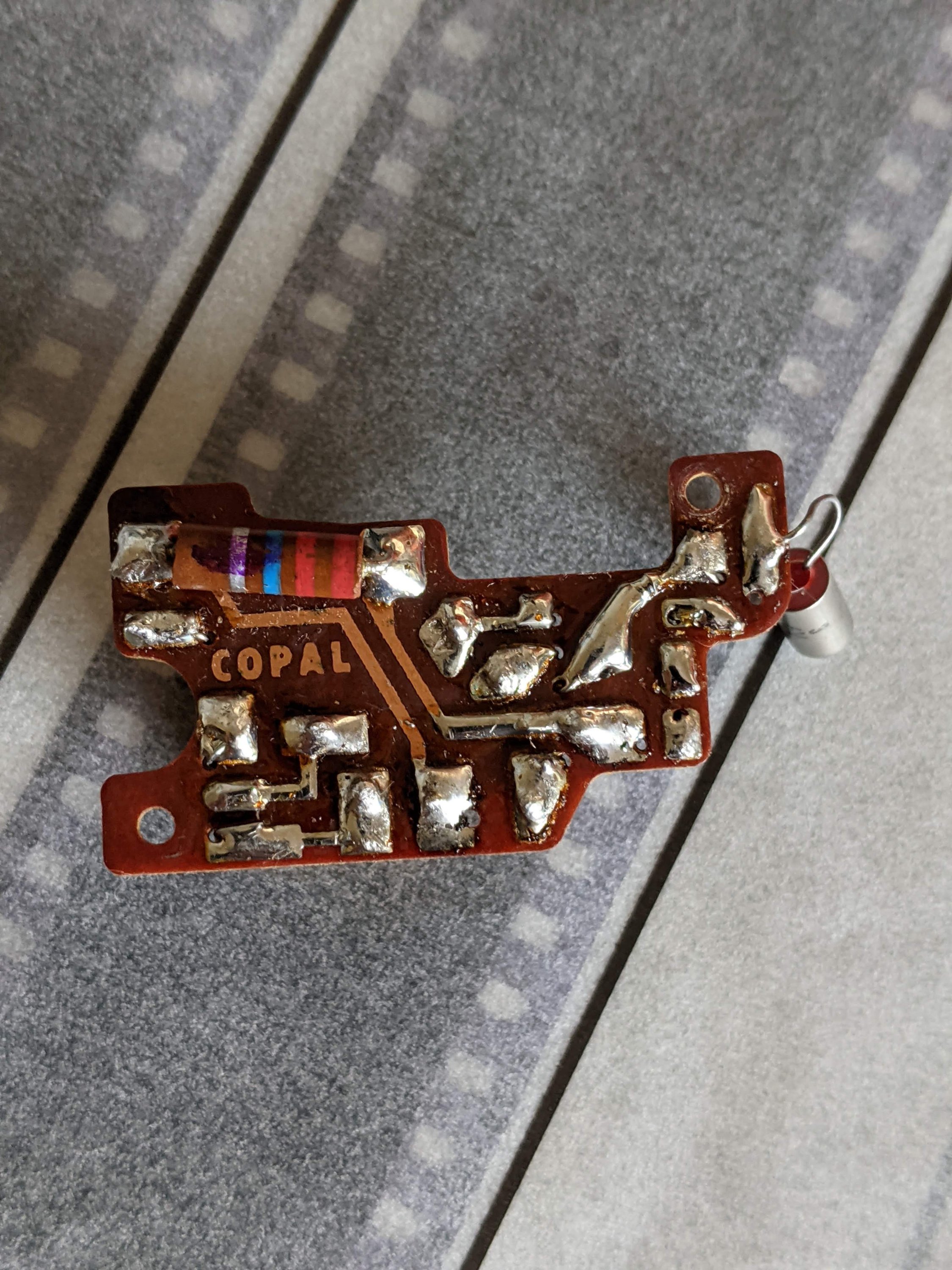

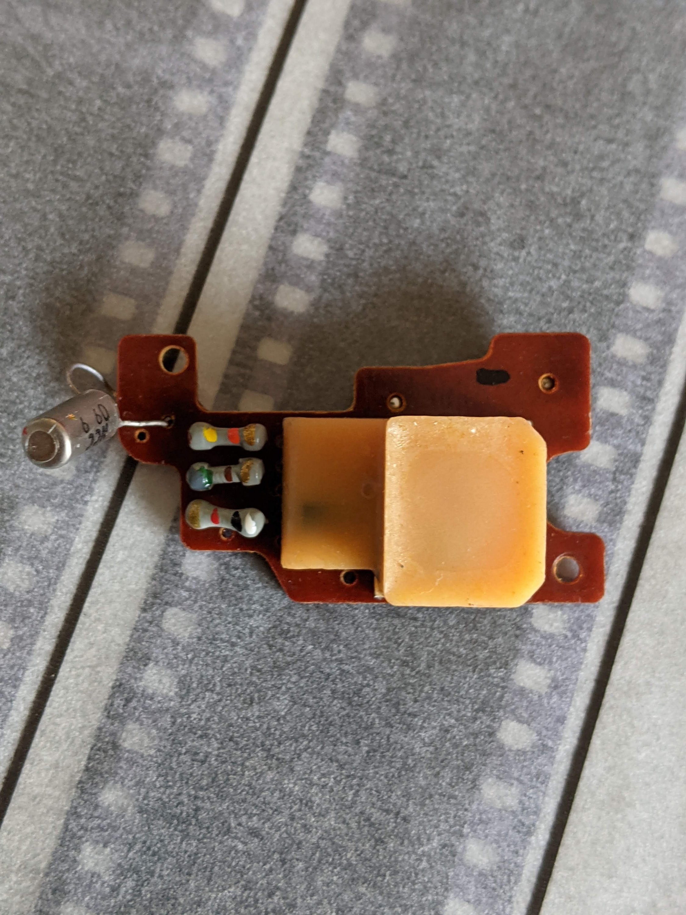

For reference, and because you asked, here is the circuit board, albeit from the GT, not the GTN which is the problematic camera in question.
During stripdown, i found a few issues as to why the GT was sold as a spares camera. The shutter-release switch (3/3 switch of the L-shaft) wasn't working, winder was being interfered by the plastic counter window and the battery-tester was inoperable because a wire had come off the bulb.

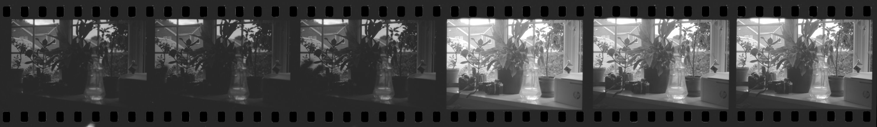

Just as a sanity test, I did an exposure test where all I did was change aperture at a static scene.
The "dark" images are I think up to f4 (didn't take into account fogged leader of hand-loaded film) which is odd. Although, up until now I have only been checking this issue pointing my camera at the sky.
The first overexposed frame is more overexposed than the next 2 but the 1st 3 appear consistent.
