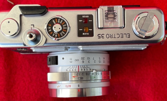

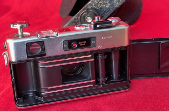

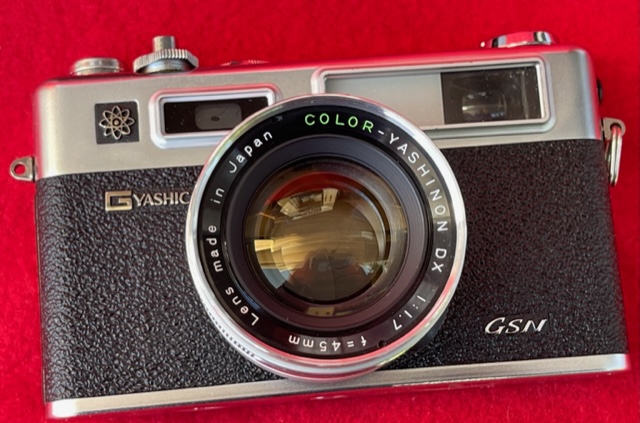

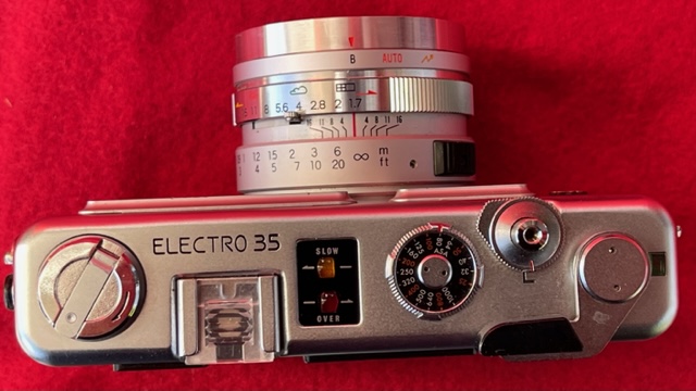

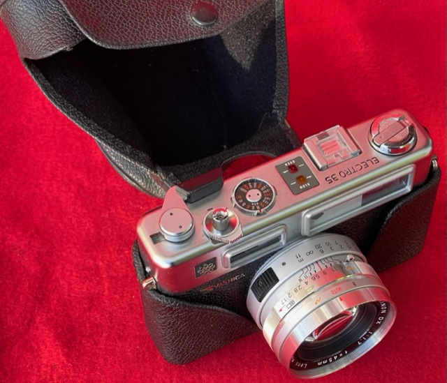

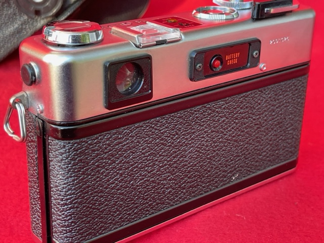

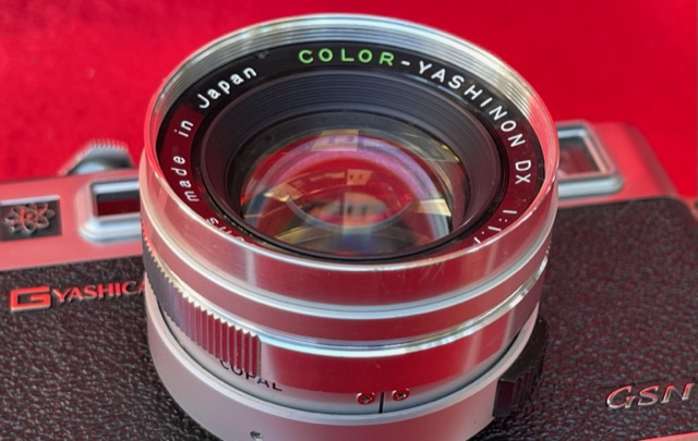

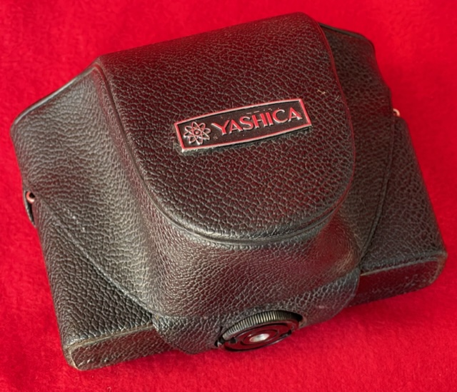

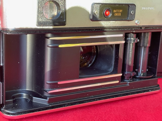

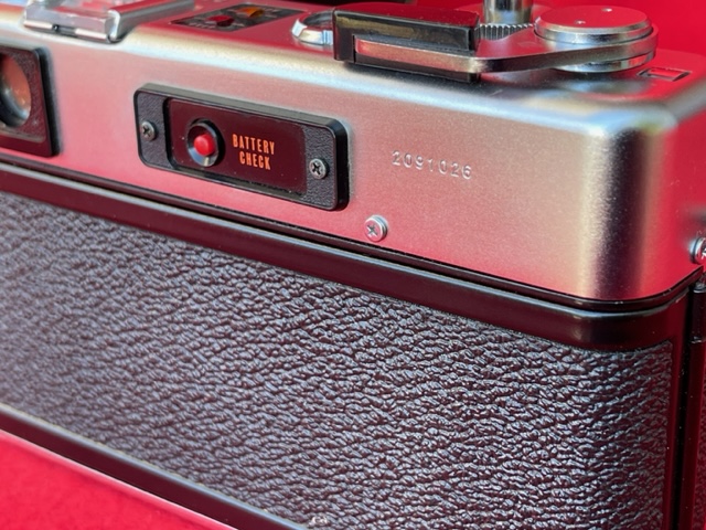

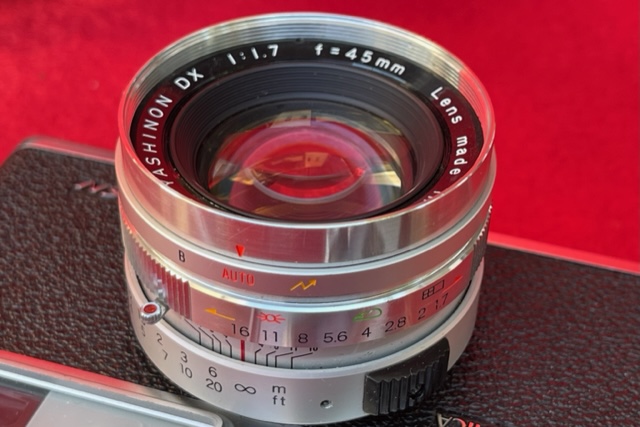

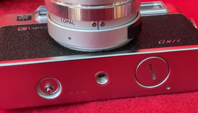

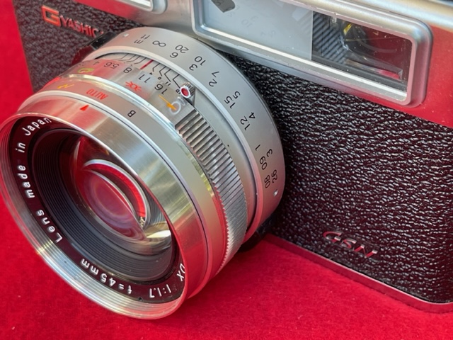

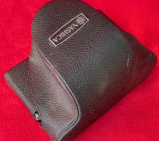

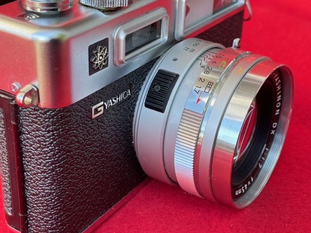

Pics tell the story. A fun camera that is the poor man's Leica. It combines the Nikon EM automatic speeds with aperture priority and the lightness of a rangefinder. Plus it's a leaf shutter so no flap flap camera shakes or flash sync issues. They are superb little cameras and very very sharp. Look at the pics. Battery is funky. 3V and 1.5V combined, but works fine. $45 + help me pay the mail man please.
