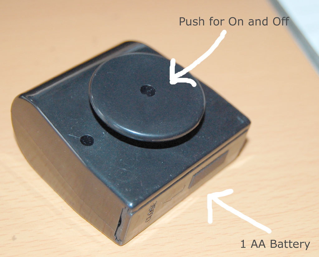

Hey, I have a neck massager, the kind you blow up with air. the cheap ones you see in drugstores. I comes with a vibrator that pops right out. Not sure if it's strong enough to shake up a tank, but worth a look. Here's a pick. You can hot-glue the flat surface.
