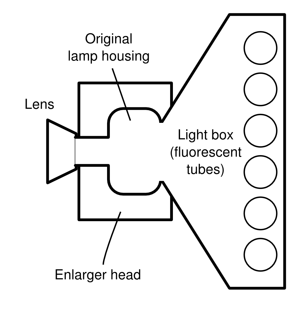

I have a light box with 10 actinic tubes (180W total, and an amazing light power - not bad for energy and heat saving!) which I use for alt processes. I can switch the UV tubes with white light, and build a reflective "funnel" to converge the light to the original lamp housing. That would dissipate heat very well and make a diffuse source (I would prefer a point source for better sharpness, but that's the lesser evil). See illustration
