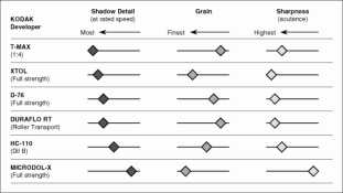

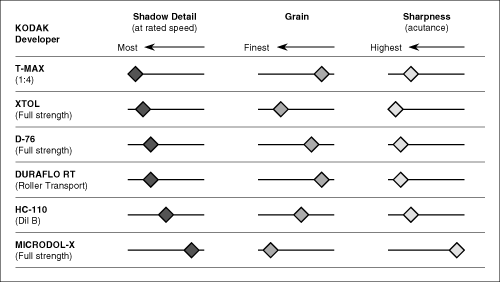

It appears that few are using the link, so here's the image.
Lee
