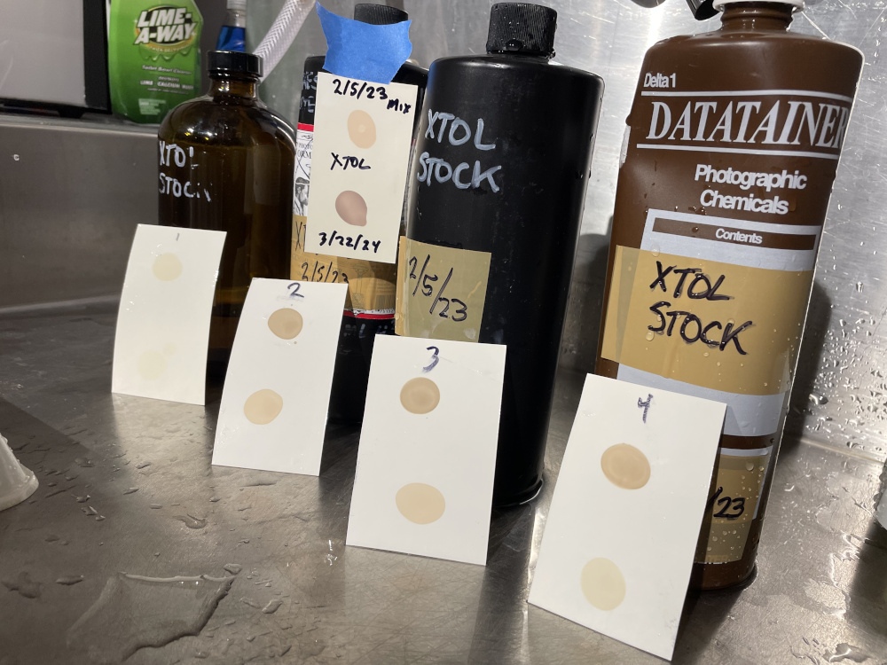

XTOL 5 liter mix on 2/5/23.
Tested on 3/22/24 (uppermost swatch with blue tape - densities are reversed on this sample). Already showing signs of weakening; the lower dot is not dense black, which is the 1:00 development drop; 30 seconds on top.
Tested today, 2/24/25. 1 drop on Ilford MGRC paper (upper) and 1 drop added 30 seconds later (lower) and washed with water stop at 1:00. Fixed TF5 for 1:00.
Bottle #1 -- 1/12 inch in glass container - little to no activity
Bottle #2 -- Half-full, black plastic with air squeezed out partially.
Bottle #3 -- Full to brim, black plastic.
Bottle #4 -- Full to brim, brown plastic.
I could have experimented more, but I simply discarded all. Two years is really pushing your luck, but it shows that XTOL when stored without air can be fairly stable.
