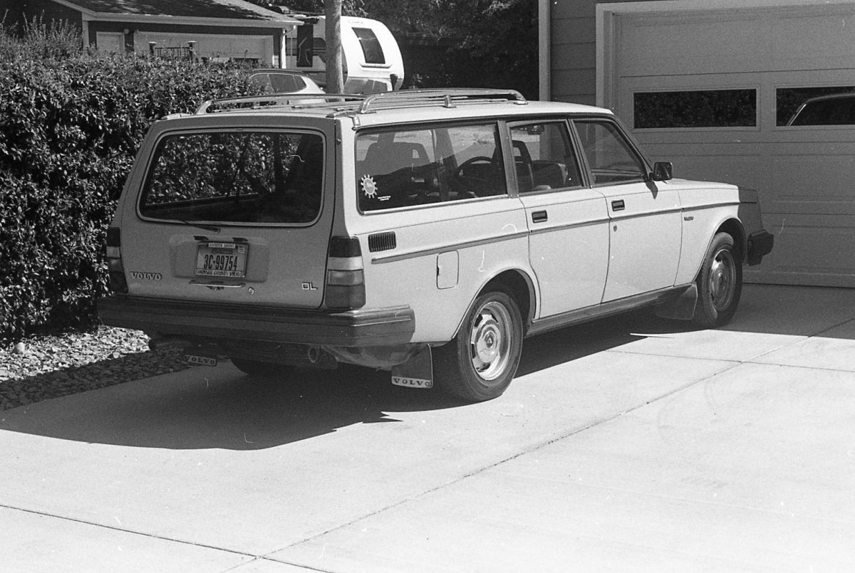

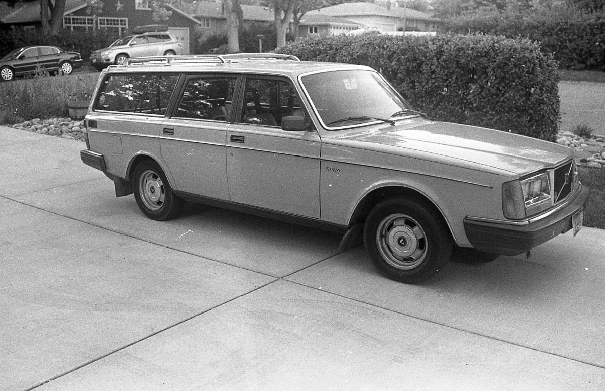

Coincidentally, I just did a test roll the other day to check out some stock XTOL that I had mixed 2 years ago. I used some FP4+ and it turned out OK. Maybe a bit flat but OK. I tossed it and made up a new batch and ran another test.
The first image is from the old developer and the second image is from the new. Both are on FP4+. These are scan of the negatives, no post processing. The images were shot on separate days so the lighting was a bit different.
