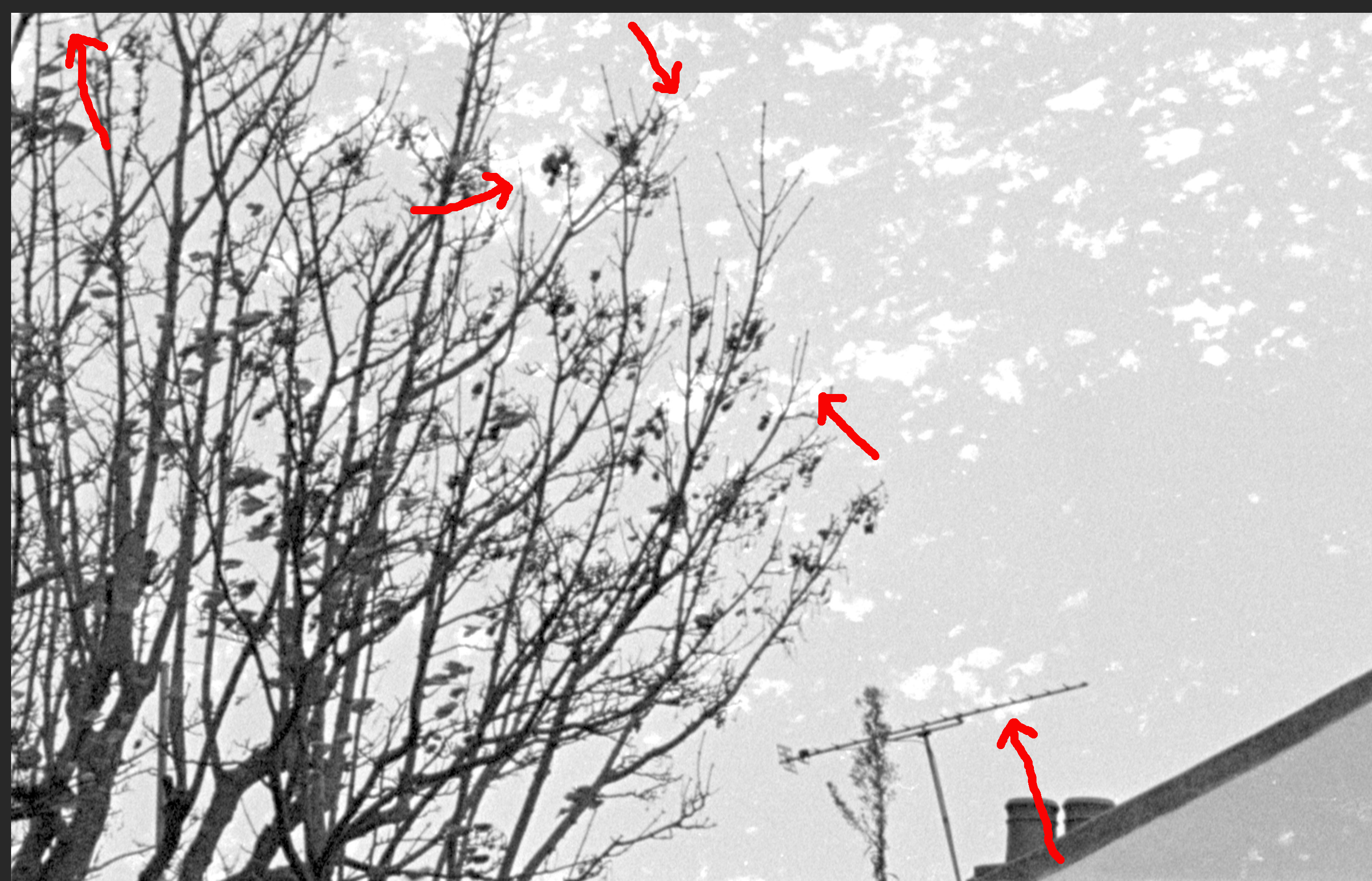

Given that the television aerial and the branches and twigs in the image in post 22 are not affected by the marks, the cause of those marks is not foreign matter on the negatives. The negatives should go back to the processor for an explanation, as the OP won't find the answer here on Photrio.
They are affected. Some examples:
You have to zoom in to see it, but there is affection - even on the television aerial, though it`s not that obvious. The affected part of the antenna is brighter.
This does remind me of the Fomapan Koraks posted, where the opposite effect is visible - lower density spots on the neg, here it seems to be higher density spots.
Probably some Remjet floating around from some maverick movie film
I'm sure that was a joke, but I'll point out for those who might mistake it for a probable cause - it isn't. Dissolved remjet is very fine particulate matter and it won't settle in this distinct chunks on the film.
The retained silver hypothesis I find a little puzzling since I don't see how an incomplete bleach or fix step would leave such clearly defined patches. I'd still like to see some close-up photos of the film, especially the emulsion side, seen at an angle and at fairly high magnification. The presence or absence of a visible artifact on the film surface is an important diagnostic in this case.
