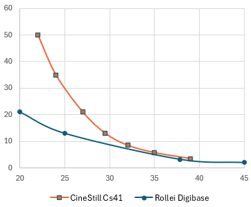

That's fascinating; here's the CineStill times and the Digibase times in one chart:
Take your pick...or anything in-between, LOL!
That sounds like they may be different formulae -- perhaps even different developing agents (though how you'd call anything that wasn't CD-4 only C-41 I don't know). Of course, that could just mean Cinestill used very slightly different data points to fit their curve and didn't test the extremes. Lots of bad science has come out of fitting the curve to noisy data...

I'm looking forward to shooting and processing XP-2 Super slit for Minox, and because the Minox daylight loading tank isn't very practical for temperature maintenance I hope to do it at room temperature. I should only need to adjust time for temperature, since there aren't any color layers to get out of balance with slower development. My calculation (at 4% per degree F) gives about 10:40 as a working time at 68F/20C -- has anyone done this who can confirm the time?

I found the article you were probably pointing to, and it confirms what I already knew: color balance is the big issue. That, however, shouldn't matter with a black and white C-41 material. It does look like I need more than the 10:40 I originally calculated (linear vs. curve fit time correction), but it looks like 22 minutes will be a good starting point. Consistency would be an issue with the Minox tank even at 100F, because it takes longer to fill and drain than modern tanks like a Paterson -- and for a 3:45 development time, the time to fill and drain is a significant fraction of the total dev time.
