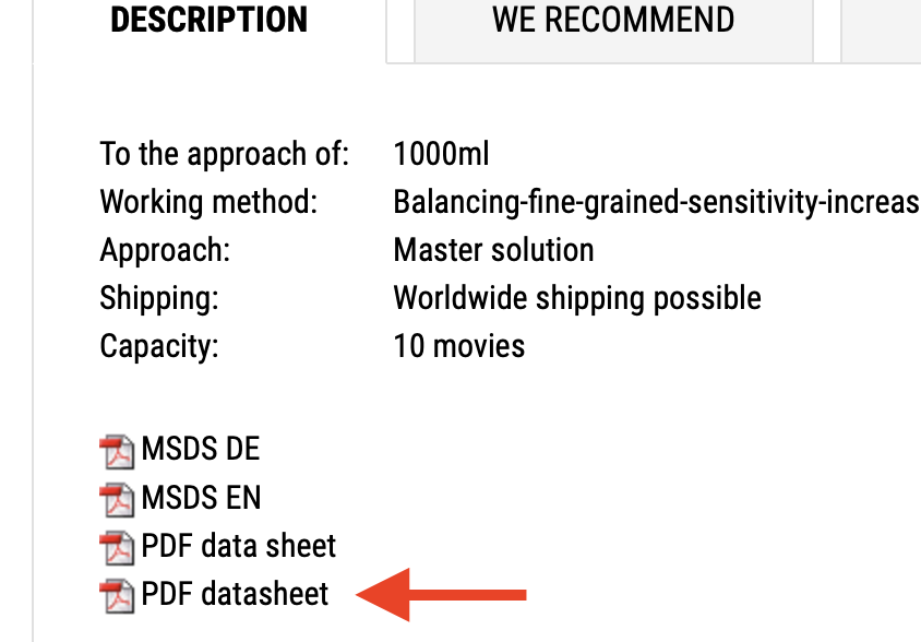

It's funny, when I go to the Fotoimpex page product page for Adox XT-3 and click on this link for "PDF datasheet" it opens the Kodak Alaris Data Sheet J-109 for XTOL. In some places ADOX is saying XT-3 is "better" than XTOL, but in other places, they seem to be saying, "There is no practical difference"?
There's no practical difference regarding how the film is developped.
It's a better product because it come as 1L package (5L too), for now it's reliable and consistent (unlike Kodak chemistries..), and the captura thing is on paper better for our lungs.
