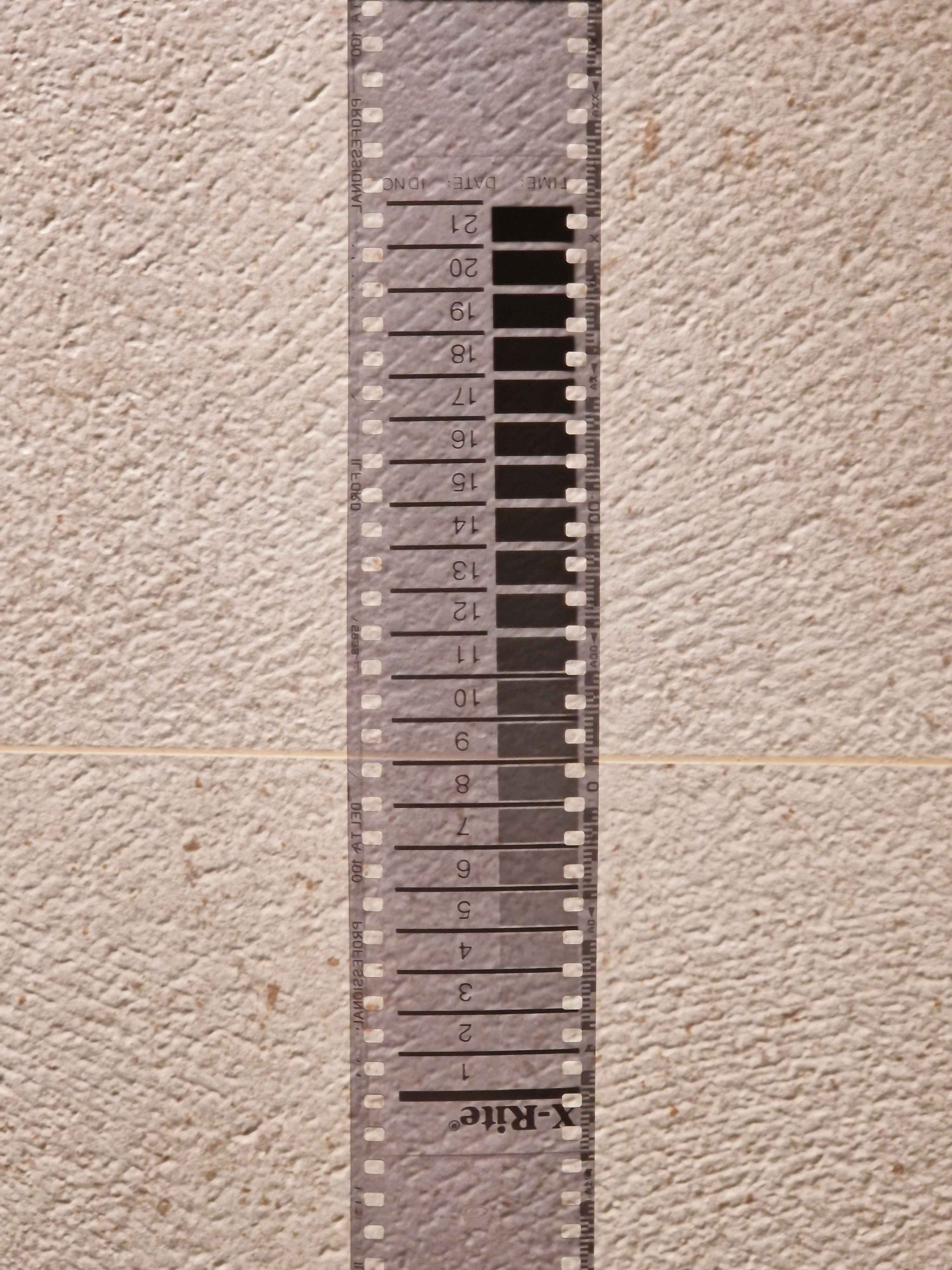

Does this look ok? I set maximum Exposure Time, Mode 7. More than that would require me to exposure twice

Your strip looks pretty good. Maybe consider a touch less exposure. The key is to have enough toe to work with, especially with extended development times.
So it would be beneficial to have more toe samples, meaning more patches with lesser density?
It's a balancing act. You need to maintain the higher densities with reduced processing and the toe with extended development.
You “Need” at least one sample patch to develop beneath 0.10 above base plus fog so that you can interpolate where the curve crosses 0.10 above base plus fog. Two or three steps would be nice, they make graphs show the shape of the toe better, which can help you form opinions.

p.s. In Post #76 the exposure seems right-on. Those first two steps look like one may be beneath 0.1 above base plus fog
That makes perfect sense now! My Densitometer hopefully arrives this week, and then I can properly check the Densities
Thats great to know!
My X-Rite 331 Densitometer finally arrived, and I can start to have fun with Sensitometry.
My Delta 100 Exposed Strip has a Measured Density of 0.30, and the first Patch is showing 0.32, so I am below 0.1 b+f which is good right? I think by 3rd Patch I get above 0.1 B+F

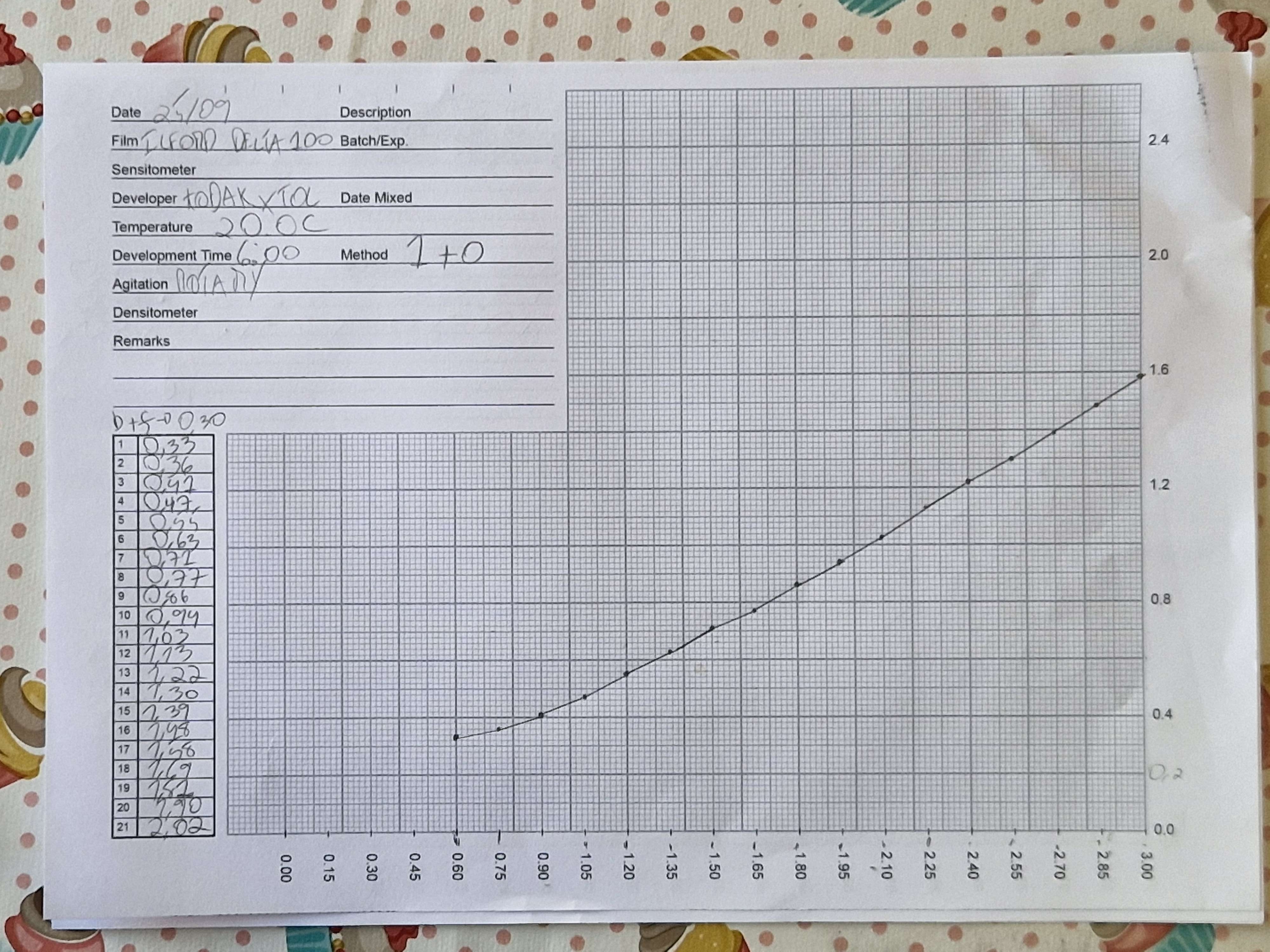

How would I plot the X Exposure values on the Chart, if I dont go by the ISO Standard? I understand if I go by what makes sense based on this comment
"The step that produces 0.1 density on the Ilford Delta 100 film (processed to ASA criteria) should be 0.9 millilux-sec (the antilog of which would be 8)."
EDIT: Here is how I did the math, would be great if someone could check it.
b+f plus 0.1 happened on the 3rd strip, so my math was x - 2.75(the 3rd patch step wedge density)=0.9 and found 3.65 as LogExposure
What I am not sure is if the X-Rite 334 StepWedge starts at 0.05 Density and go up 0.15D each step, or starts at 0 Density and go 0.15D afterwards. The manual doesnt specify this
The standard Kodak 22 StepWedge starts at 0.05 and ends at 3.05, which is what I assumed. Anyone knows this information?
This is my first Characteristic Curve made using the X-Rite 334 Sensitometer. Ilford Delta 100 following XTOL Tables. Used the process described above to find the Light Output of the Exposure Mode 6 on the 334, which was used for this curve.

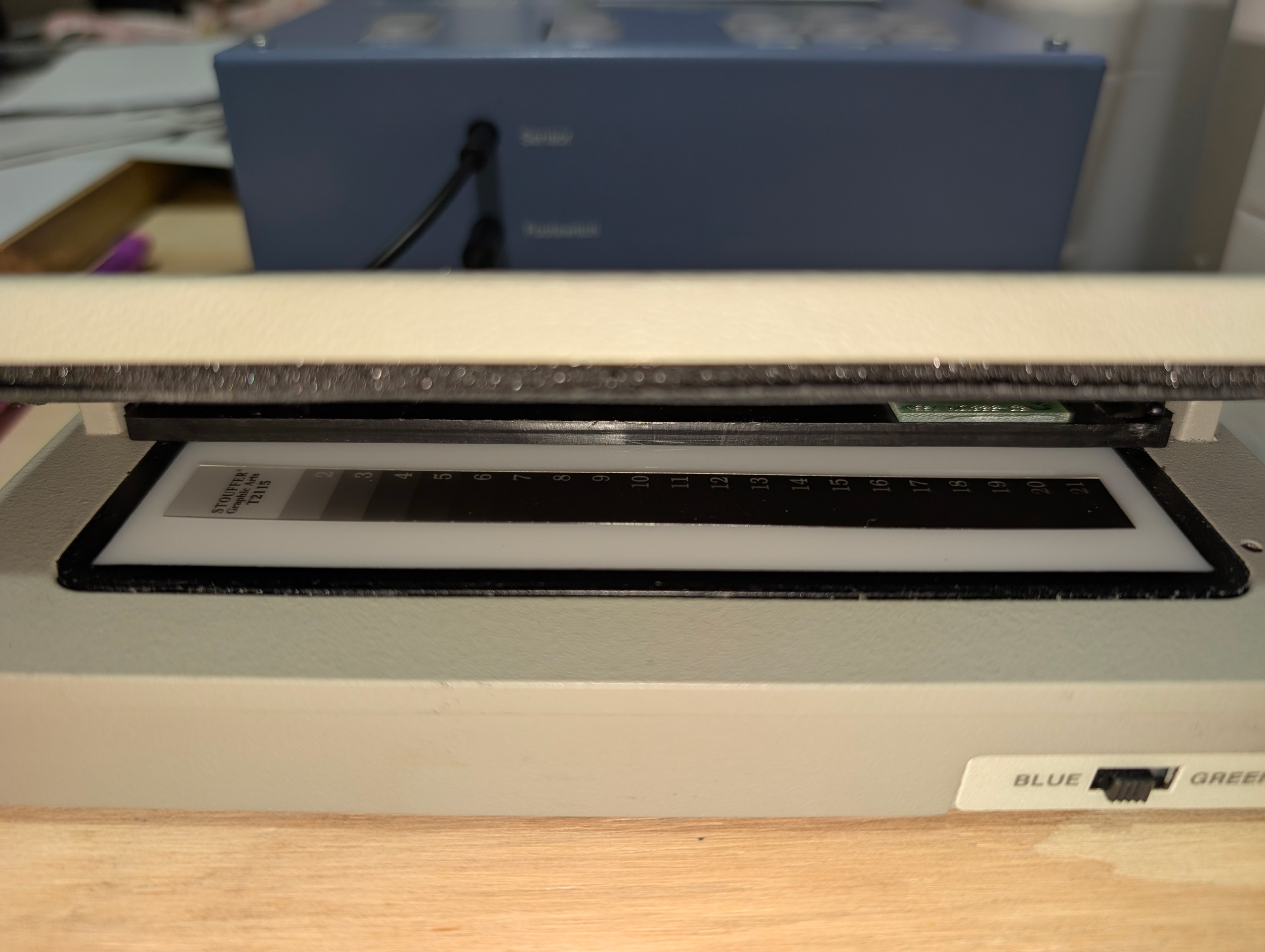

I've been lurking in this thread for a while and finally received my X-Rite 334. It was from a Pennsylvania branch of the EPA and pretty well-worn. From the stickers, it seems to have been used by a team monitoring radiation levels in the mid 00s.
Inside, it had the step wedge adhered with pretty scratched and degraded tape. I measured the wedge+diffuser on my densitometer, got some odd results, and opted to replace the step wedge with a brand new one from Stouffer. Looking forward to testing it further with the ISO method.
Alec, what template did you use for your curve? I've been using https://analogworkshops.at/plotter.html but I've also been searching for a good pen-and-paper option.
