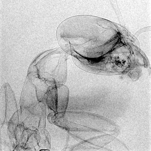

I've been working with Real Time Xray systems since 1986 (FeinFocus and Phoenix). The real-time sensor arrays are digital, but we use the Xray source to expose film as well. Our machines are heavily lead shielded and radiation monitored.
I am going to try to attach an example (an unlucky ant that ventured into our lab).

Roman, some exceptions are the Xray systems I am using. They are quite capable of exposing conventional Xray film and have real time CCD digital focal plane arrays as well.
These systems have very small (micron and nanometer range) spot sizes and an extremely wide power range (up to 230KV). Notice the resolution in the ant picture I posted.
However, they are very expensive and very heavy ($500,000. and 2 tons).
