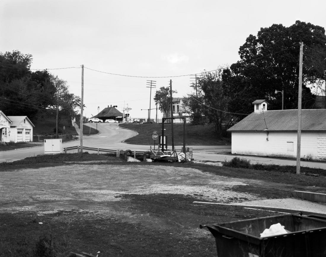

Here is an example of High Speed Blue Sensitive X-ray film exposed at ISO 200 and developed for 4 minutes in X-tol straight. This is an 8x10 negative, and the film costs about 27 cents a sheet in that size. This is not meant to be an "art" image, rather I was testing various films shooting out the back of my studio.

Thanks for the tips. I have plenty of this old stock to play with so a little testing won't deplete what I have. If I am not mistaken these films can be handled under a red safelight so I can cut them to 4x5 & 8x10 without trimming my fingernails too short.:wink:
