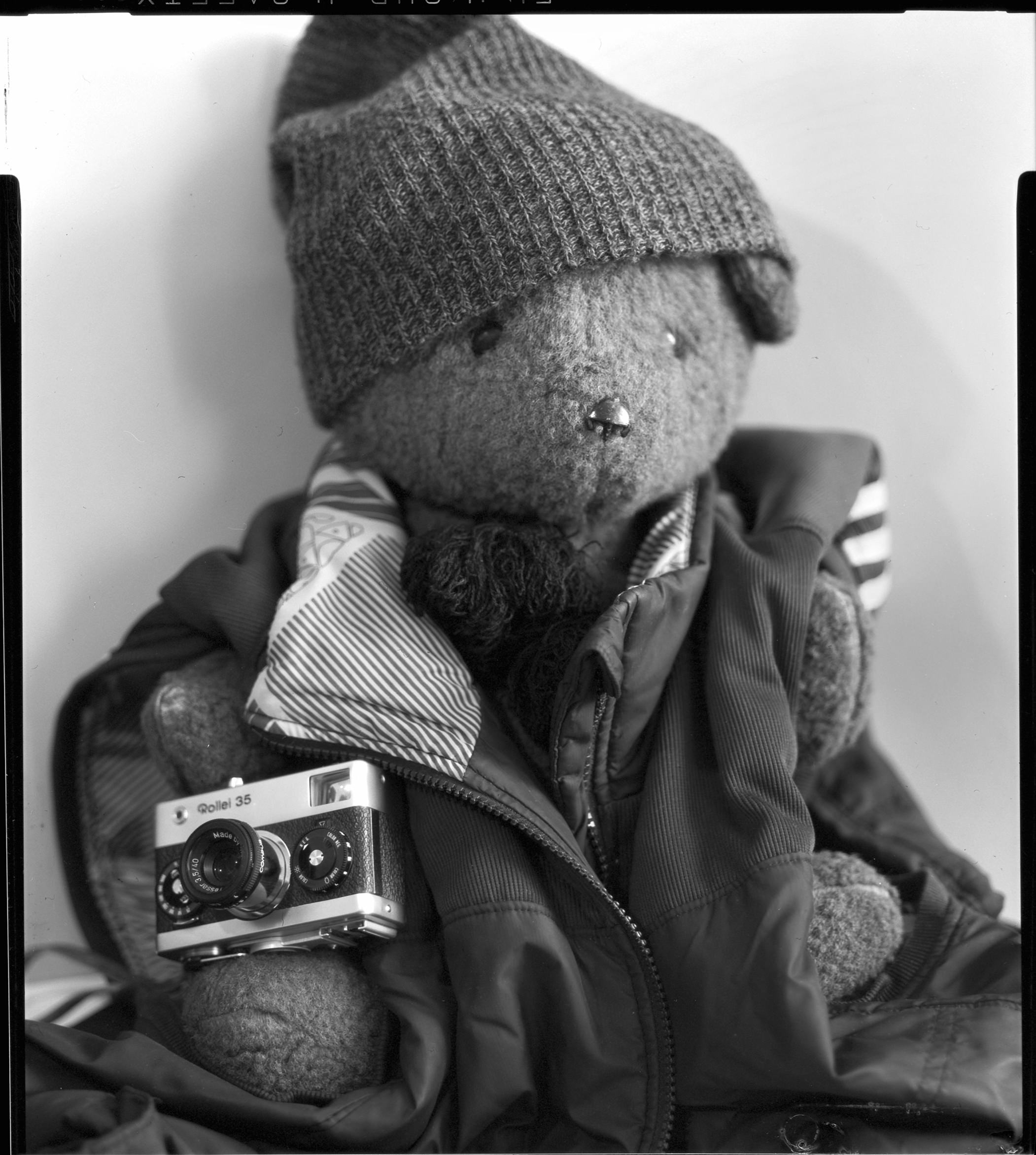

I've shot Fuji HR-T (green sensitive) x-ray film for pinhole shots the last few years. I've refined my process to get some pretty nifty results, but I'd say in general it's an acquired taste -- but then so is pinhole!
My initial reasoning was simple economics, 100 sheets of 8x10 for $40+ delivered! (As I e-speak, B&H lists a 25 sheet package of HP5+ for $129.95, 10 sheets of Kodak T-Max400 for $89.95!) My most recent efforts developed it in HC110 1+63 and got plenty of density in 3 to 4 minutes. That helped tame a tendency to high contrast. For sizes at 4x5 and below I would lean toward conventional film, but in the smaller sizes one can get usable quantities for less onerous dollar amounts.
I did some experiments with 8x10 Ektascan B/RA a while back to play with a beat up old camera I was working on. The detail holds up well enough and the restricted spectral sensitivity is a fun diversion, and like others here point out controlling the contrast is an effort. I'm more of a tinkerer than an artist, I mainly view xray film as an inexpensive way to tinker in really large format at a cheap price. An artist could get some use from xray, and that LFF thread has some great examples.

...so it's difficult to answer your question... If there are any orange to red objects in the scene, they will be rendered very dark, to black. Blue sky? Unless you pop on a yellow or green filter, they will be white...I love double-sided green on a sunny day. No anti-halation layer, so sometimes nice soft highlights.
In terms of tonality, yes, I agree, and I was surprised to find that out, but perhaps I need to persevere on the box of BR/A to get it down well. But...I never really fixed the scratching issue on the double sided film in a satisfactory way.
Tonality is a biggy. Flat-bottomed trays, gentle agitation, and no scratches. The nice thing about BR/A is that I can develop it in BTZS tubes. It's also razor sharp! Good luck and please share you results!

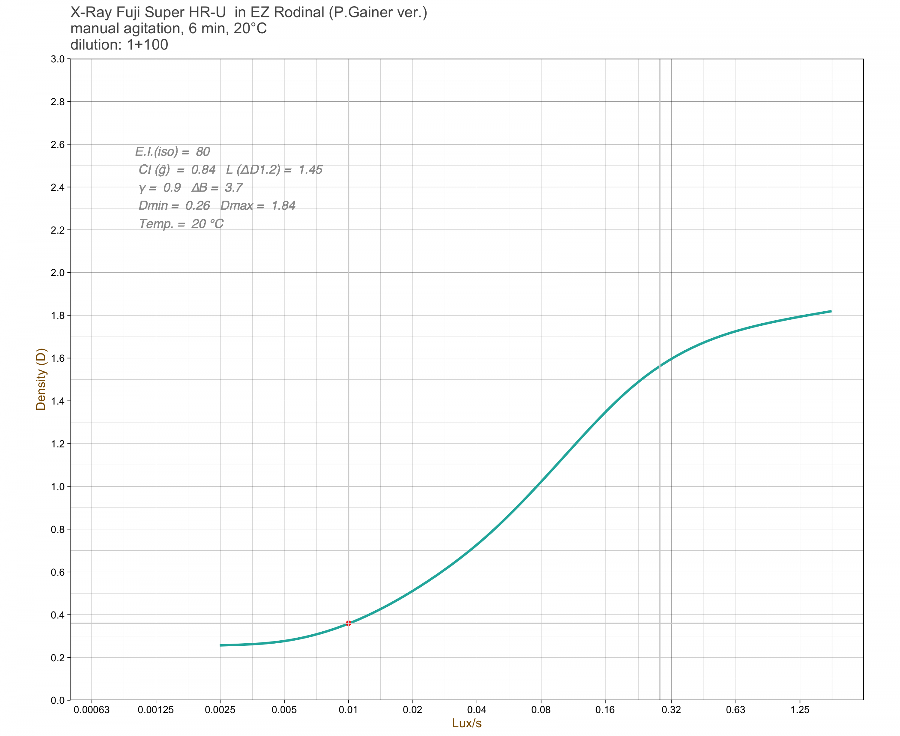

Yes people have used Rodinal. I have used it, for one, but I havent used X-ray much. There's no shortcut to reading the 5 million post thread linked above. One of the mods is obsessive compulsive about neatness (but we love ya O!) and merged 2 shorter, slightly more manageable threads into one monstrously huge unreadable behemoth.
Some people use glass in the bottom of the tray to rediuce scratches, some people remove one side of the emulsion with bleach, there are a lot of different things people have done to it. Next time you get the flu just spend that week reading the thread. You'll feel pretty sick anyway by the time you're finished. :D
For double-sided xray, flat-bottomed trays are the best in my opinion. I have also used Rodinal but it's been a while as my main developer is Pyrocat-HD... I have data at home and can post it later this afternoon... But seriously, head on over to the LFF. See my link above...

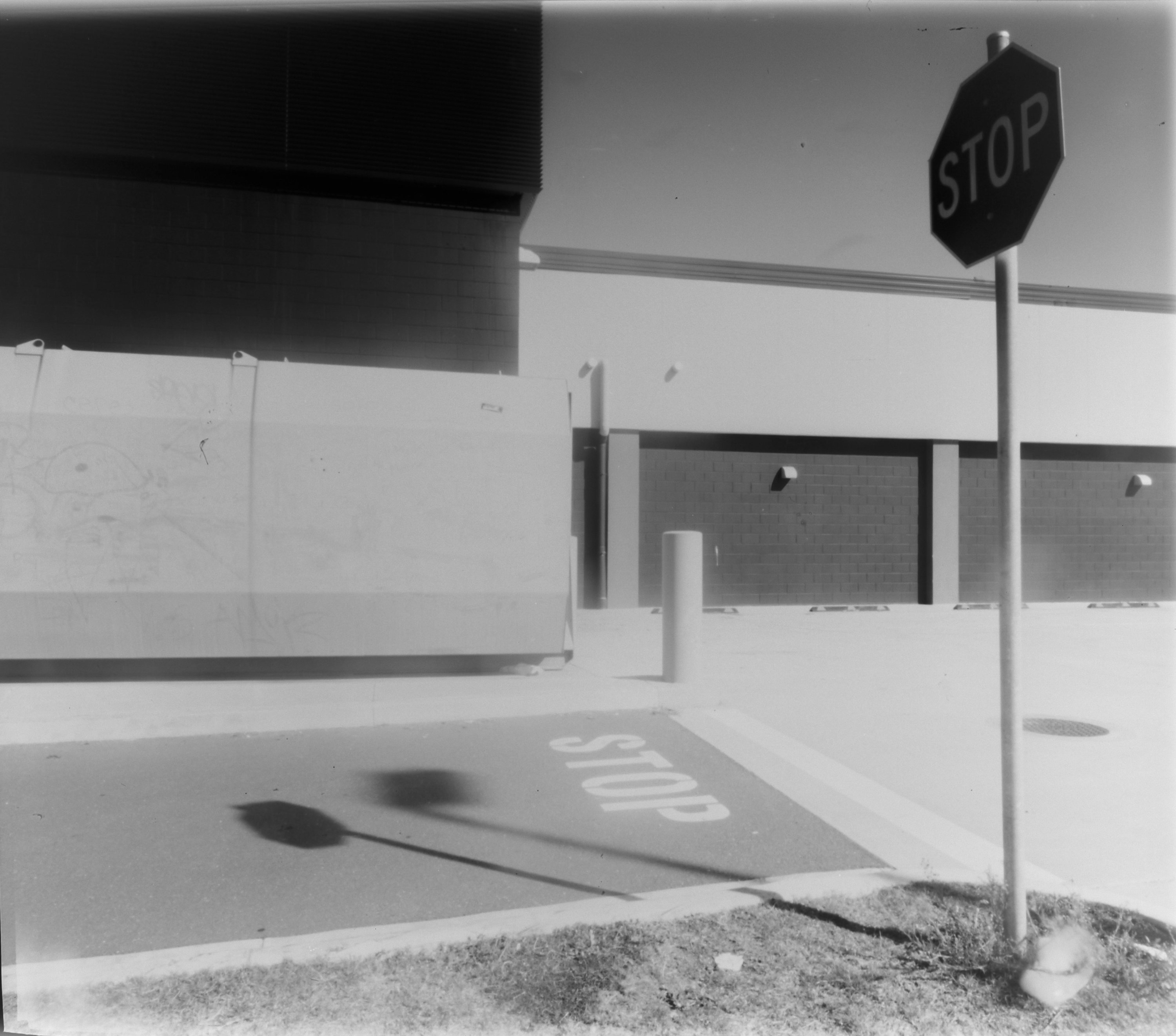

Well the pinhole sizes have varied a bit over the last couple of outings, but in relatively sunny conditions exposures have run in the 5 to 15 seconds range with an f/300 pinhole. (Not a tool to photograph sports action! :whistling: ) I've been incident metering for ISO 50 with the HR-T, but forum research shows claims ranging from 25 to 200 or even 400; e.g., all over the place, so experimenting is the rule. So ISO 50 translates to 1/50 @ f/16. One difference with x-ray vs commercial panchromatic film is with x-ray film there's none of those little charts in the box for sun, hazy sun, cloudy bright, etc. According to my vague notes, the 20 second @ f/300 April 2018 shot here in my gallery was under hazy sun/cloudy bright conditions. There are times during those long exposures where the light can actually change during exposure -- can be a bit tedious -- another reason to bracket, bracket, bracket!
Likely my use of ISO 50 is allowing me some pulling of development to reduce the contrast, which as mentioned above tends toward high.
Hope that's some help.

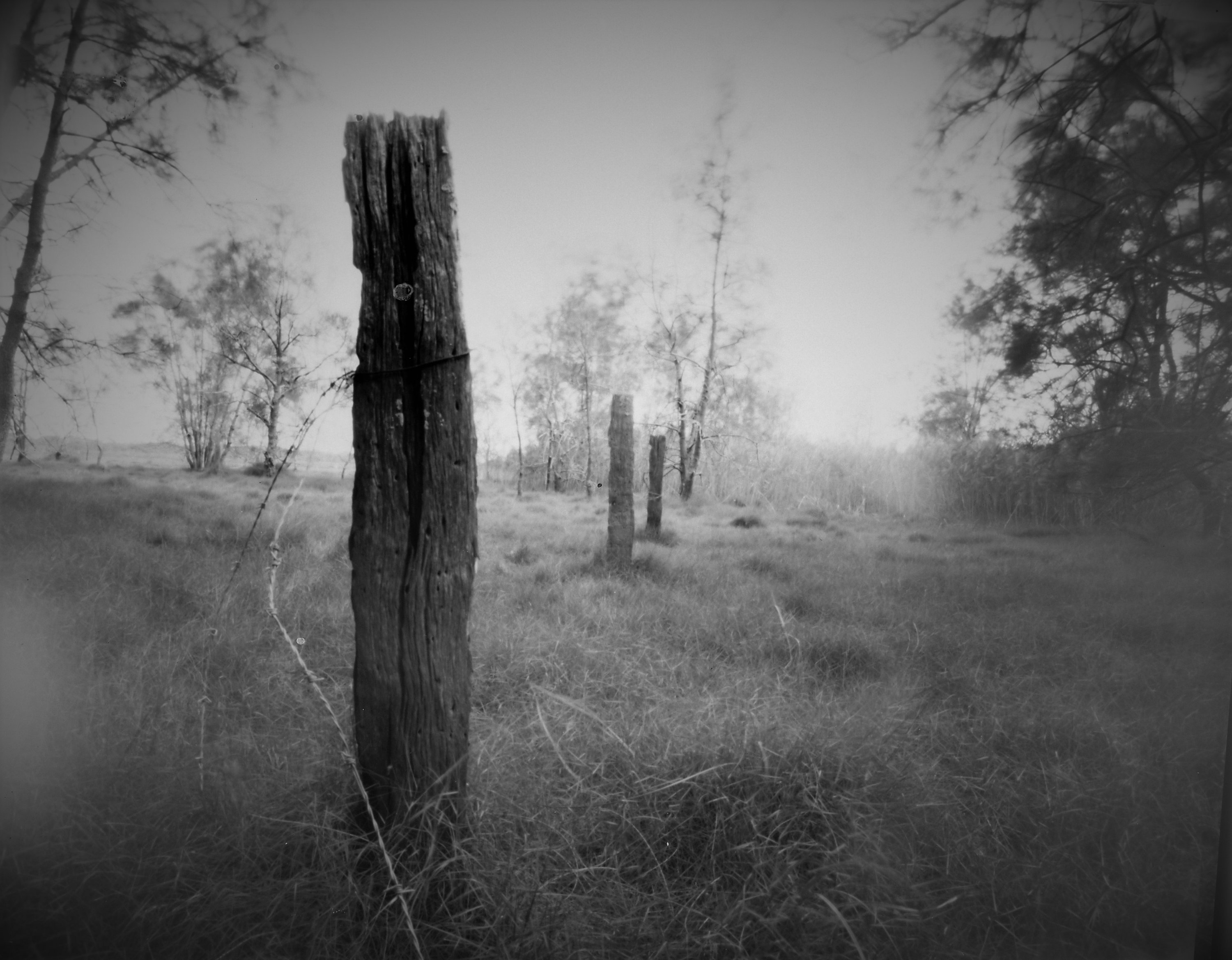

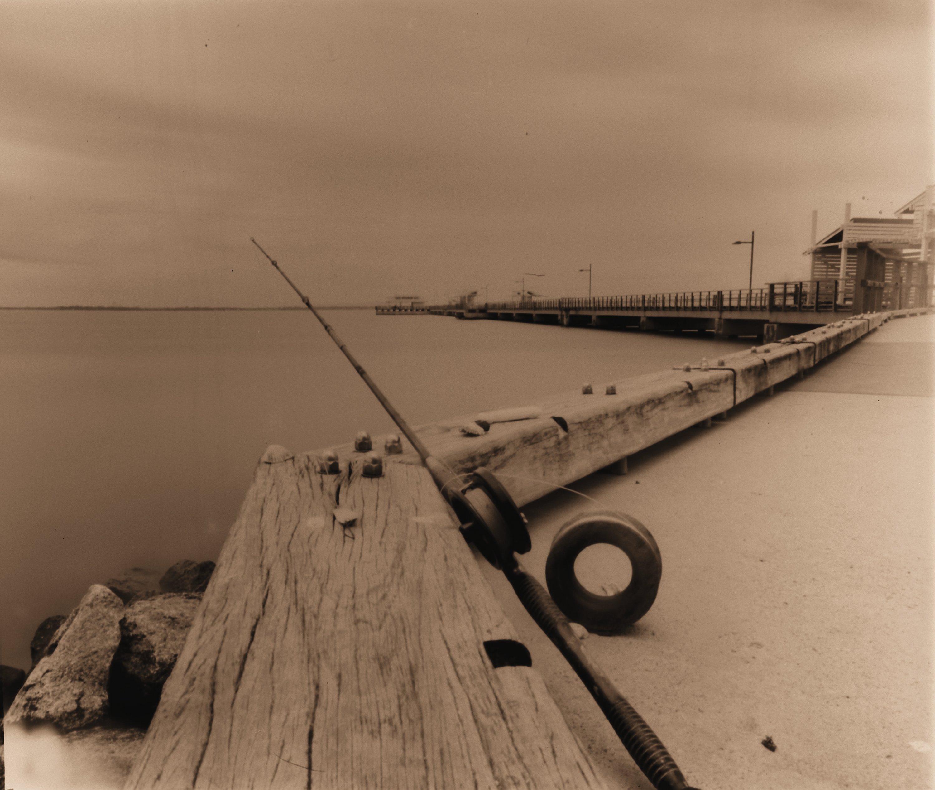

Gets some, build a camera its fun. I made my own trays from sheet colorbond. You use less chemistry if you keep the trays tight and flat. After prpocessing about 20 sheets I can keep the scratches to a minimum. I use 1+3 in d76 and .8+.8+100 in pyrohd
Heres my pinhole build. https://www.photrio.com/forum/threads/diy-fbphc-build.163661/
Heres a few pinhole test shots I mostly use an orange filter, cause I want to use for alternative contact prints. Exposure times are pretty good so far, it suffers less from reciprocity compared with other films. 4mins in good light with a 2 stop filter is about average.
These are photographs of 14x17 negatives. You could do a lot better with a lens.
24.12.18 1min orange 3 hours green 2 hours none. pyro hd 1+1+100.jpg10 01 19 orange filter and orange grad filter 4 mins pyrocat hd .8+.8+100.jpg4 + mins orange and orange grad pyro hd.jpg06 01 19 4mins with orange filter pyrocat hd. (2).jpg

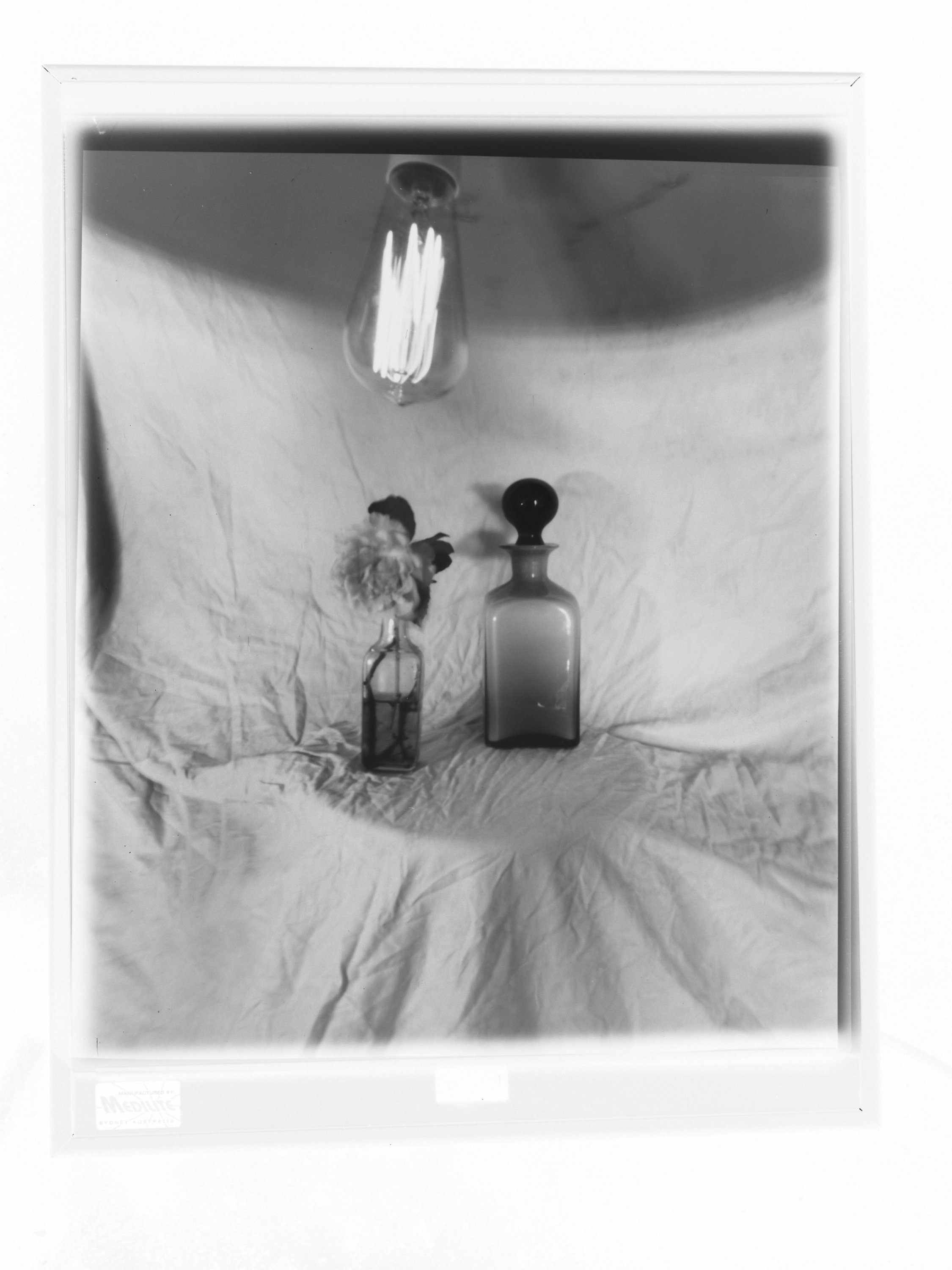

I use it primarily for palladium printing as its natural contrast works well for the process plus it is much lower in cost. I have found that with a sheet of glass on the bottom of the tray works to prevent scratches. I use one sheet transferring it and the negative between trays. The double sided green sensitive(carestream MXG) works well for me at iso 50-80 and about 7:00-9:00 in replenished xtol. I haven’t quite figured the best development time.
