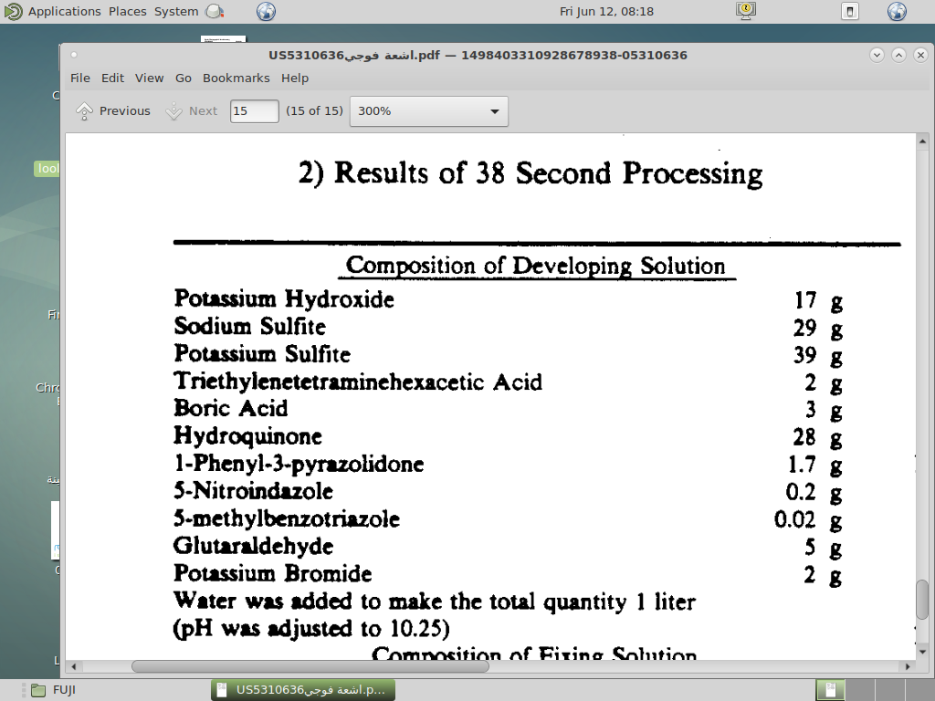

A month ago, there was a problem in the availability of an X-ray developer in Egypt, and many people asked me to find solutions to that problem, as there are still some radiology centers and medical analyzes in remote and countryside still relying on traditional hand-made X-ray because of its price. Cheap.
- I searched and found a patent for Fuji and I prepared that formula and actually sent this developer to some X-ray centers and medical analysis,
- But there is an evil person who asked me to prepare (4 liters) of that attached recipe. I also have (4 liters) of formula (G.242) for the (Gevaert) Belgian company. And the evil customer did not keep his promise and that amount is still available to me, I tried to take advantage of it by reducing the 166 and setting the pH to 8.5 as advised by the respected Austrian engineer / Rudi
- But I got inconsistent results as the pictures attached.

It's going to be a pain transforming the developer you have into another developer. You can look at ID-62 or some such universal PQ developers and see if by adding you can get close to any of them.

- The developer Fuji, was used. - 166 ml was diluted from the developer and water was added to one liter, and the pH was set to 8.5 - it was developed for 4 minutes at a temperature of 21.

I have attached the formula that I prepared for you and I have four liters in my possession

Have you tried diluting the developer so the developing times are longer? You may have something that acts a bit like rodinal in that respect. Start your experimenting at 1:10 and work your way up using it one shot until you find either good times and results or the developer starts to exhaust before the film is done.

Hard to tell. Im not familiar with many of the ingredients. If its acting like a lith developer(going by the hydroquine present) and making the film too contrasty it might need something like phenidone or metol to balance it out unless the unfamiliar ingredients are analogous to those.

If you arrive at a development time of 4 minutes with a dilution of 1:6, then yes, I'd expect that you can dilute much further to get longer times. Try 1:15 or so and see what you get.

Hello Mohmad,
in this formula I see some components and quantities I found in some Agfa/Orwo recipes, in my Agfa and Orwo notebooks, used for Rongten process or strong alkali repro-developers, like Orwo 70 or Orwo 80 and they are quite hard contrast.
The idea from koraks is a very good one, and you can try also other dilutions adjusting a little the development time.

I have four liters of another formula called (G.242) which is from the Belgian company Geavart ,,, you will find the formula is very close to that formula except for the slight differences.

According to digitaltruth site, the Agfa Gevaert 242 (https://www.digitaltruth.com/data/formula.php?FormulaID=83) is for X-Ray and Aerial films and you should use undiluted and it's a rapid one, I suppose it should develop in 1 or 2 mins.

About yours, try, for example, 1+19 for 8 min.
I like 1+19 because I use 500ml of working solution, and it's an easy division.
