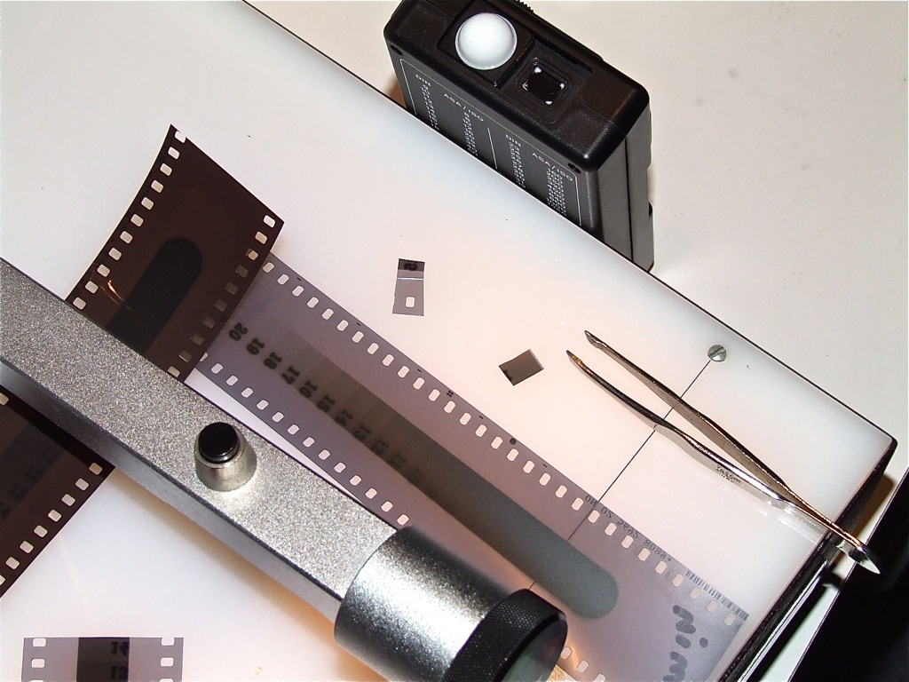

If you don't want to spend any money, you can use an old control strip as a step wedge.
