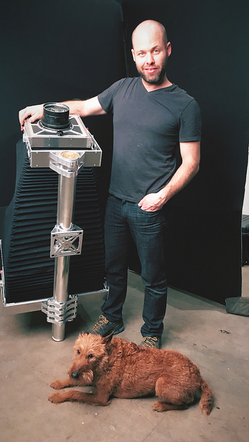

Heres the camera and myself if that gives you some idea of size. The main rail is 4' long so it's quite long and this makes most tripods and heads less that ideal.

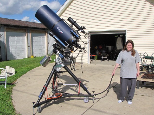

have you considered just pouring a block of concrete everywhere you want to go and just putting that NASA grade camera on top of that? That's one large, heavy duty camera! (insert that's what he/she said joke here). I'm wondering if maybe a tripod built for a large telescope may be in order given the size/weight?
http://www.jimsmobile.com/buy_wheeley_bars.htm
photo taken from same website.
seriously though, tell us more about that camera.

Do let us know what you find. I think the telescope rigs with the tracking motors is the best answer, other than a HumV.
