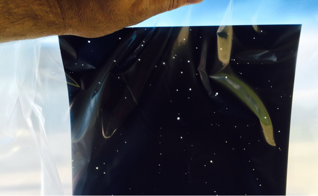

Found a solution! Circuit board photomask on thick plastic base
Grandfather of the Electrical Engineer I work with on this project owns a circuit board manufacturing company, and slipped it into a run this morning. Just picked it up. The black is entirely opaque (silver halide process)...couldn't even see the sun through it.
