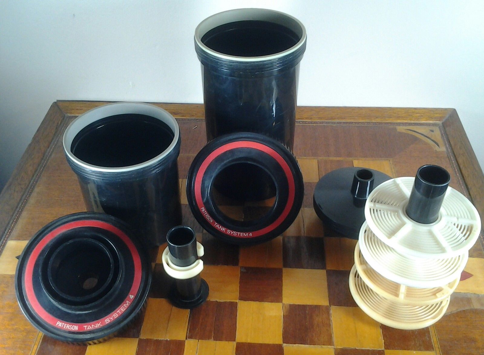

I'm trying to get into developing my own negatives, so I picked up a few Patterson tanks on ebay, but I need a few parts to complete the kit..

2x Caps
Agitator? I keep reading that inversion is the way to go, but I wouldn't mind having atleast one of these - are there different lengths of agitators?
1xSpring collar
3 auto-load rollers

Which type of tanks do you have? The caps vary between the versions. You may want to post a photo.

Good point. I've attached a photo below. I had read a few things saying that the agitators really aren't necessary, and I'm inclined to believe them, but part of me still wanted to have the option available. I'll go with swirling the tank and whacking it against the side of the bathtub to make sure the mixture gets sufficiently mixed/homogenized..
I bought it knowing it needed a few parts, which is fine. They where the cheaper option I'd found. I guess I still need about 2 reels to fit in the other tank - one expanded out to 120 width. So long as the reels fit the center column, I don't care what brand they are!
Actually, in looking at it, I think I might need just one reel? The perspective of the image is throwing me off - the eBay auction said one was a 3-reel and the other a 4, but I don't think that it is.. it looks more like a 1 and a 2-reel set to me?
These look like the plain System 4 tanks - one version older than the current ones.
I would describe them as a two reel tank and a three reel tank, because one tends to use the reels set for 135 film when describing that.
I have the twist agitators for the current tanks, but don't know if they will work for yours. If you were , locap, I would just give you one to try.

Too bad you're not in Europe, I've got a ton of System 4 spare parts laying around that I want to give a new home. I've upgraded to the Super System recently.
