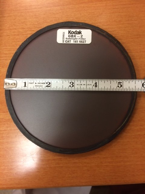

Funny I found a GBX-2 5.5" in the trash yesterday. I'll mail it to you this weekend if you want.
