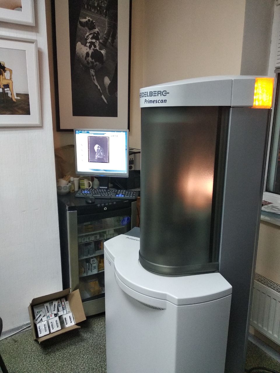

Looks, like I am on board with Heidelberg.
Local guys from China owned wallpaper factory were selling not working Tango.
Not cheap as snow - 2K for the cat in the box. But cat appeared to have 22 hours of work time on it.
Karl have being here in Kyiv 3 weeks ago.
Thank you Karl. It was fun time :smile:
And I would not hurry to get rid of my ICG.
After years of working with it got so used to the size and shape of the grain it produce.
Heidelberg at the moment is better in everything (colors, software, speed, usability, scanning C41 negs right in pos better than Nikons), but has bigger grain and less fine details.
Maybe I need some advices from real users to help with the procedures.
I have seen big image comparisons with Tango and ICG compared. From that test ICG and TANGO had compared grain.
From my test at the moment it looks very-very different.
The former Tango / Primescan Yahoo Group which was recently moved to Groups.io is an excellent source for tips on getting specific results from the Tango / Primescan. I joined that group ten years ago, when it had just 35 members. Now it has over 235 members! Please keep in mind there is a global control for influencing the aperture size. It's the slider tool at the top of the Overview window. Moving it more to the left is a smaller aperture (more grain) and more to the right is a larger aperture (less grain). As for the sharpness of the scans...the test I did when I was there seemed plenty sharp on dust / lint artifacts. I will contact you directly regarding how to tweak it, if you think the scanner is consistently less sharp than expected. One thing to remember regarding some scans being out of focus...is that a dirty mount with larger pieces of dust / lint under the mylar, might cause the scanner to focus on one of these, leaving the measured focus value to be at a point slightly above the surface of the original. Equally important is to never include any clear Plexiglas areas in your scanning frame. Then the scanner might focus on the high-contrast area it found between clear drum and the dark edge of the original. Again two different surface heights resulting in a 50/50 chance that the surface of the original is what it actually focused on.
